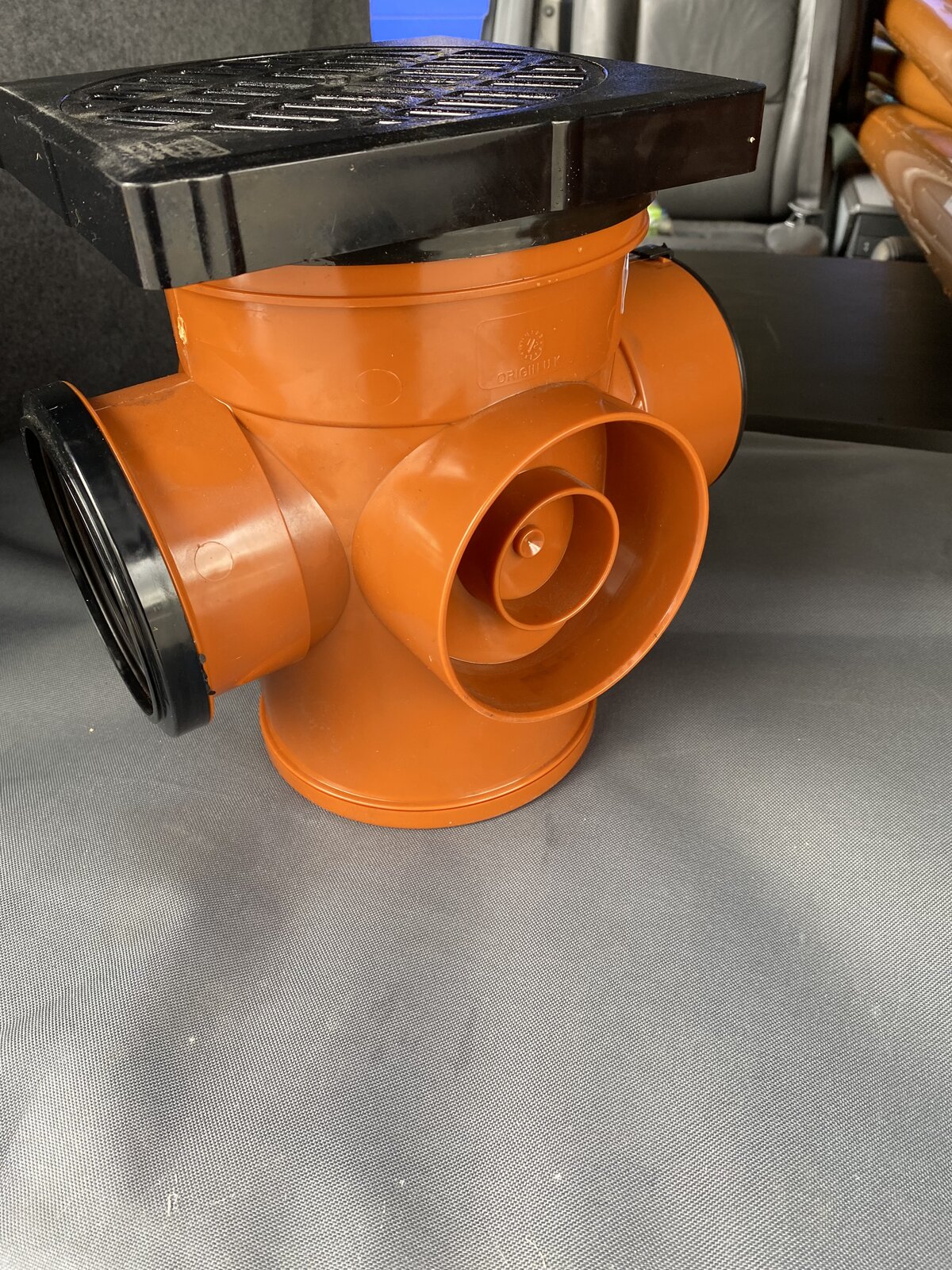

Hi,
I have the below gulley I want to cut out the blank and fir a pipe 110mm pipe into it but how a 110mm pipe fits into the socket but how do I secure/seal it in?
Jon

I’m not entirely sure that you should be doing that. What’s the 110mm pipe connected to?
Hi it’s connected to another gulley that takes rain water from the roof of my garage into a soak away I want to take it through 90 degrees.
Ok, so you probably just need to do as noseall has said then a solvent weld fitting, perhaps a coupling, but only if you can get it to fit.
why a 110mm for a garage roof rainwater? why not use a typical 69mm down pipe? rainwater pipes shouldnt be sealed into the gulley, you will need acces to clean the trap and maybe for rodding.
If in future you mean to use the gulley for a side entry soil pipe then theres muchbetter ways of doing it
RWP to gulley to another gulley via 110mm side inlet is ok
Hi
Thanks all. Now I am confused. Firstly I am using 110mm because that is the size of the inlet/outlet on the gully. The gully is a back inlet gully but I want to bring the pipe into the side by cutting out one of the blanks as in the picture. There is no soil or foul water enviovex it’s purely rain water that drains into a disk away I have installed on my property Didn’t realise it would get so complicated.
Jon
I think it was just being ascertained you were not trying to connect the drain from a toilet into the Gully, (it does happen....)
Simple enough to do, cut out the blank to open the boss, then solvent weld the 110m pipe spigot into the boss.
