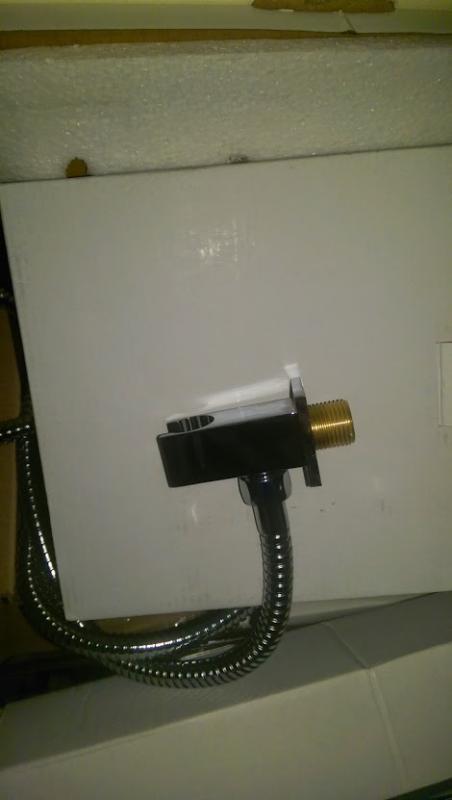

The head I can probably work out, but the handset doesn't seem right as there's not enough thread to fix onto the wall/plate.

Here is the handset, as you can see there are no washers, or fixings..

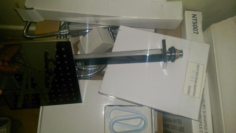

And here is the head, which includes a rubber washer, metal washer, and nut ..
Can anyone briefly tell me how to mount these to the wall please? It's currently a stud wall which will be boarded over and the tiled, so I can add some wooden backplates or blocks or anything else that is required.

The manufactures dont supply fixings to the wall ;) you ned a couple of these
Ahhhhhh, you're a star, like squeaky mentioned though, looks like it should be supplied. Never mind, will go and get a couple tomorrow.

With the concealed shower head, the smaller rubber washer goes against the chrome bar on the shower side of the wall, the large washer and nut go on the other side of the wall.
One thing that's always confused me about these kinds of fittings though - how do you make sure that when you're finished tightening it as tight as it will go, it will point in the right direction???
Just the right amount of thread sealer/lock or PTFE, I use a liquid PTFE for jobs like that. Others prefer loctite etc. Then it's getting it just tight enough.
Great! thanks. So am I right in thinking that the handset is supported by the wall plate elbow alone? The thread doesn't look long enough to pass through the wall AND attach the elbow to it. So i'm guessing i'll have to have a hole in the wall for the elbow to poke through?
Yes, the elbow will be your means of support, thats why it has the back plate for attachement to a structure.
As Madrab said above, the nut should protrude through the wall so that you can thread in adequately, otherwise you will be pushing too far in and now get a decent seal on it.
