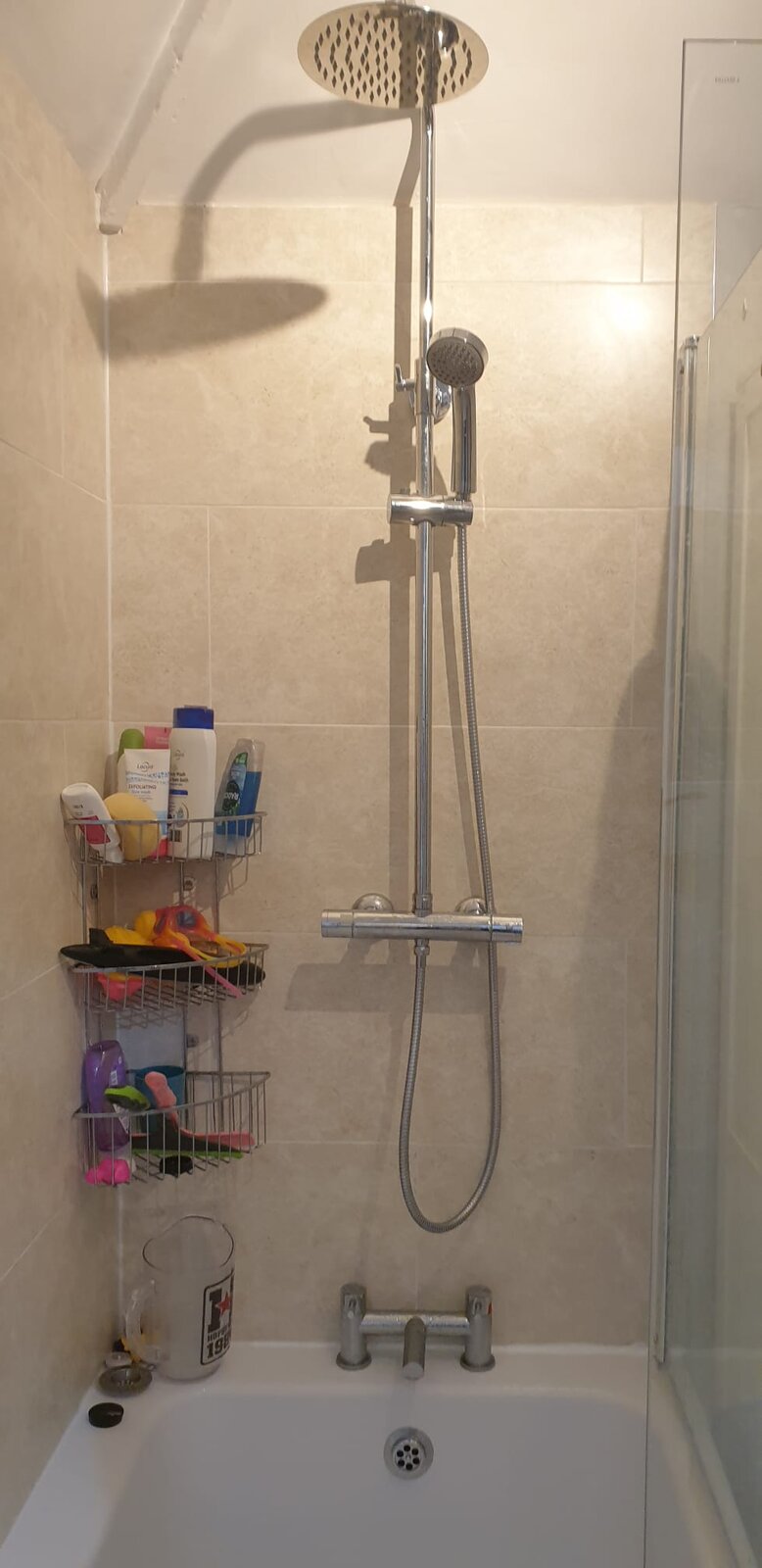

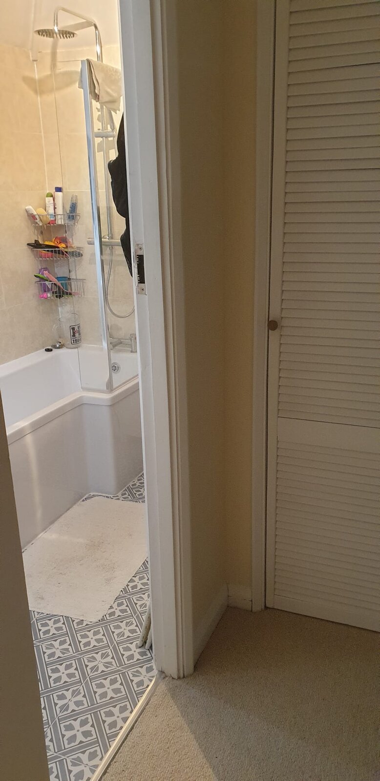

Just tried that John and removed the hose and handset, nothing happened. I tried with various settings of all the taps but the pump didn't kick in. For reference, these pics show our setup. The HW cylinder is in the airing cupboard with the louvred door, right next to the bathroom. The pump is under the bath.

If that shower has that rain shower head then they are designed for mains pressure water and need at least 1 bar to operate to any decent degree. Given that is near the ceiling and the CW cistern is just above then you'll be lucky to get any more than 0.1bar of HW at the shower head, at that rate it just isn't going to work properly, there just won't be enough flow to start a positive head pump.
Honestly, it's simply been a pi$$ poor design and I'm afraid the guy who installed it doesn't really know what he's doing. It is a relatively straight forward fix but it will probably need the pump changed (needs checked by removing the shower and running the HW from the supply pipe itself) but it shouldn't really need fixed, it could easily have been right from the start.
