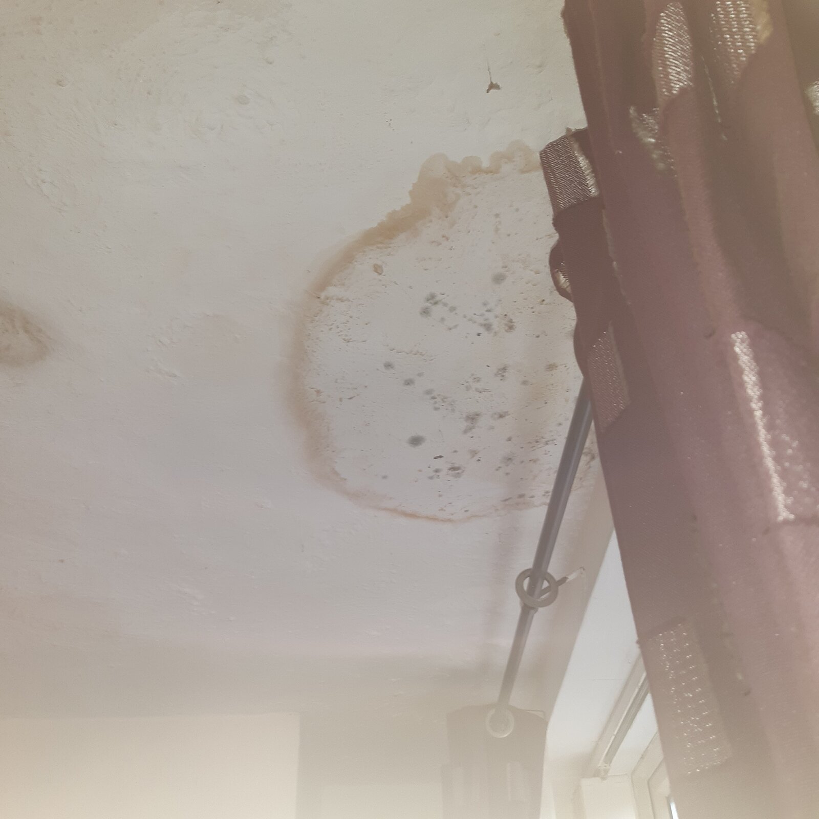

Hi, I have a concealed cistern toilet that seems to be leaking slowly onto the kitchen artex ceiling.
Water was going out of the overflow after it was flushed, so I have adjusted the fill level, but I can't see how that would be causing the problem.
I am.thinking I will probably need to remove the toilet pan to see what's going on behind there.
As this has happened a few times over the years I am concerned that it may have damaged the joists.
As the bathroom floor is tiled the only way I can get access is to knock a hole in the artex ceiling below.
Is that the right thing to do?

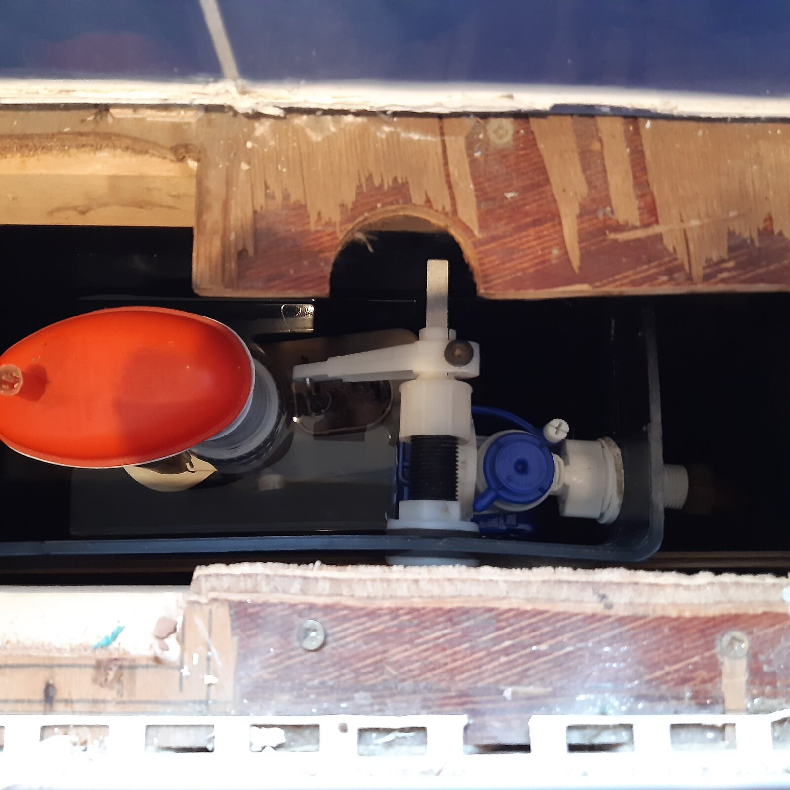

What access do you have to the concealed cistern ?
Pics of the installation would be useful.

Sorry pic quality isn't the best, it's all tiled apart from.a few I can remove on top of the cistern
Pan out job Gary ,to see what's going on.
Have you had to destroy the top tiles , or was it made to come apart for access ? ( Didn't look like it)
Check for leaks using an inspection mirror and light. It could be that the rubber washer below the cistern is not tight enough.
Hi Terry, the tiles are just siliconed at the top on some ply that is partly cut away for access.

I guess I can just tie the float valve up though to stop the water flow of I need to take the pan out.

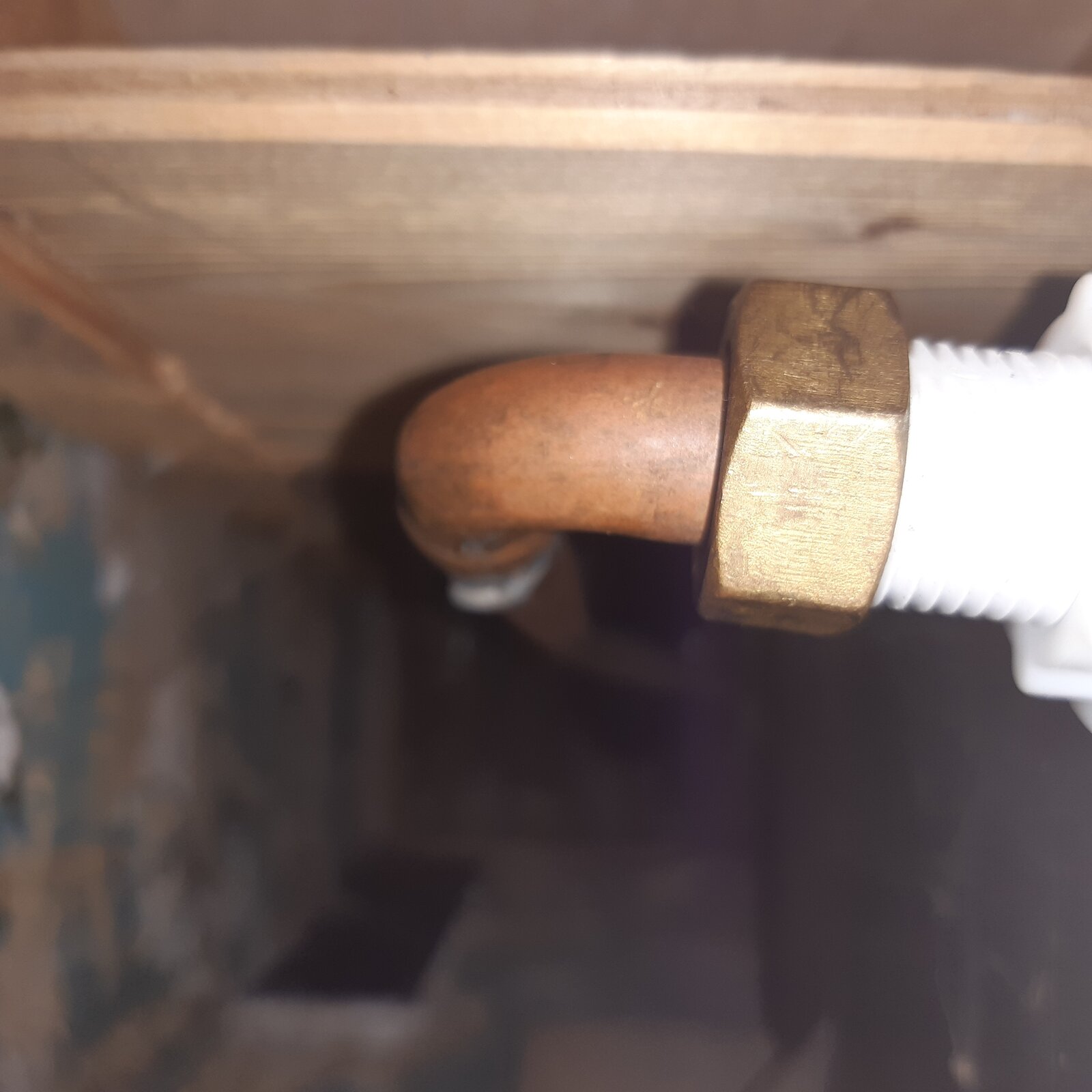

Can you shine a torch down ,from top right hand side of cistern ,where the water supply pipe connects ,see what the floors like.
Plumbing issues with concealed cisterns / all tiled in / no access ,are always a pain in the rear !!!.
Yes, the floor looked dry, felt slightly damp to touch on the cistern below where the pipe enters but I don't think enough to cause the problem.
Is the large stain on the ceiling directly below the toilet ?
With that amount of staining I would have expected to have seen some sign of water on the floor.
Yes it's directly below the toilet mate, the ceiling is going a bit moldy too, the tenant has been away for a couple of weeks so noticed it when he got back.
It's not dripping at all though as it did a few years ago when I got the plumber to sort it.
