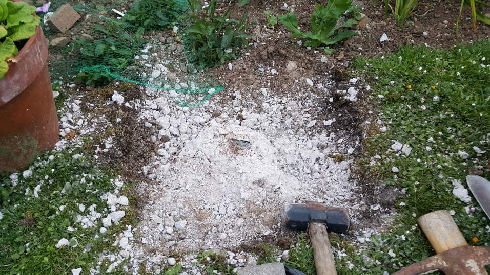

Sorry, not a great pic – the centre of the grey mass is a very solid lump of concrete, a foot to 18 inches across, with a bit of scaffold stuck in the middle. It is completely immovable, so I assume it goes fairly deep… it used to from part of a 2’ square base for one of those rotating washing lines.
I want to remove it, and foolishly thought I could just smash it into bits with a sledge, then dig it out with a pick – but, having broken off the original 2’ square top, and battered away at what’s left for days, I’m not really getting anywhere.
Anybody have any great ideas for demolishing it? Or how far down it’s likely to go?
Thanks all :D

old concrete buried in the ground is particularly strong and hard, because years of damp improve the cement. Being damp also makes it harder for you to lift. In one piece you would hard to lift even if you dug all round it.
dig down the side of it, find out how far down it goes. Once you get down to the same depth you maybe able to prise it over into the hole you have dug, once its loose you should get some idea if it is possible to lever it out. Don't try and do it all in one go or you may bugger yourself.
Fit a 12" (300mm) masonry bit, 8-10mm, into your drill and drill a test hole about 2" from the edge. When it goes through the bottom it will plunge down easily. The dust marks on the drill will give an idea how deep it is. Then do another hole near the centre to see if it's the same depth or a bit deeper. It may be conical shaped underneath where the original hole was dug out.

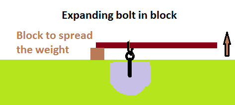

This might work for your lump of concrete
One hole and a large expanding bolt to fit.
Lift the end of the beam to lift the concrete a couple of inches.
Wedge the concrete to stop it dropping back.
Lower the beam and add more height to the spreader block and lift the concrete a few more inches
Repeat until the concrete is high enough to be moved away from the hole,

Hire an SDS drill with a nice big bit, say 20mm. Drill a couple of deep holes, shove a large cold chisel down and beat merry hell out of it.....it will split readily enough.

think I would just dig down the side of it first and try to work out how big it is. I wouldn't waste money buying or hiring a tool just for this. If its not that big you could dig it out and if it is huge then that little sds will be of no help.
