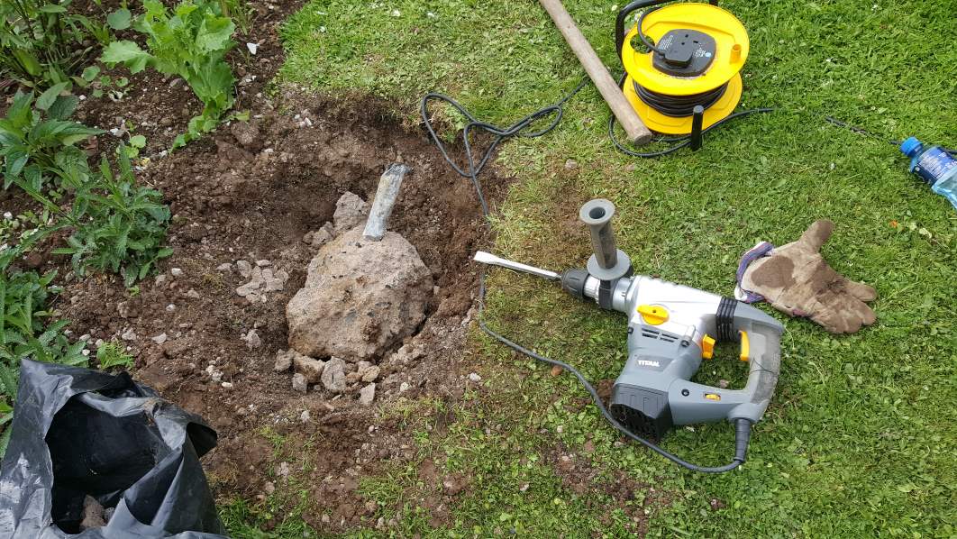

How to get concrete out of the ground

Yeah not ex-council, but it was one of those rotating washing line thingies, and they don't seem to have scrimped on the concrete either, sadly. I did dig down a bit, but gave up somewhere approaching 18".

I can't hammer anything down the inside of the central pole bit, unfortunately, as I whacked it a couple of times with the sledge, and it's all closed up. Not sure what I thought I might achieve really - probably just frustration. But the concrete didn't even vibrate when I whacked the metal seriously hard with the sledge...
Just for a laugh, I did manage to drill a few holes down into it with my ordinary old hammer drill and an 8mm masonry bit, and it did seem to penetrate reasonably well, so maybe I'll try making a line of them tomorrow, then try and break a big bit off with the sledge or something...
Trouble is, I haven't really got stone chisels to batter into holes, or metal bars to lever with or anything...

Well, as is always the way, I want to plant a tree there. But hitting it with the sledge isn't really having any effect now anyway :(
Drill, Roger....that's how the quarrymen do it (y)
In the absence of explosive, a cold chisel will suffice!

DIG, Roger..... You need a hole for the tree so you will have to dig at some point. (y) Even if you manage to split it in half (which isnt a given) you will still have to dig it out
I bought an SDS+ drill as we had to remove some fence posts as well.
Maybe hire one for a day or two?.
Chisel attachment worked wonders although like someone else on here I did get it stuck a few times!.

I've lost count of the number of threads I've followed on various forums which go on for pages, then stop abruptly, and you never know what happened. So... eventually I gave up trying to find cheap options, and bought the cheapest SDS drill/hammer thingy (as above - £70 from Screwfix). As I said, not much more than hiring something wih a transformer and all.
An hour's hard labour and more rubble sacks than you would think later :cool:

PS note that ENTIRE hole was concrete, including a 2' square, 4" deep section on top.
