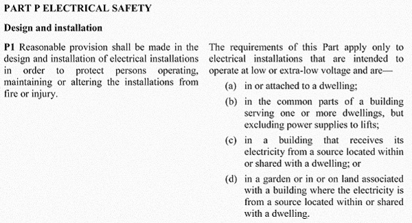

Anyone doing electrical work needs to be competent. There are several ways of proving that competence.
'part P certified' isn't a thing.
Some electrical work is notifiable, meaning it needs to be notified to building control.
That is done before the work starts via a building notice or plans submission, just the same as any other notifiable work such as building an extension, installing new windows, relocating a kitchen, altering drains and so on.
Members of competent persons schemes can notify the work via the scheme which saves a significant amount of money and time if doing notifiable work regularly.
There are no restrictions on who can do notifiable work - they just need to be competent and to actually notify when it's required.

Thanks. Is my understanding correct that if you wish to do you own electrics in the garden or installing new circuits in your house then you need to be Part P certified and not just “competent”?
The garden is no longer a restriction in England.
This is all that is left:
https://www.legislation.gov.uk/uksi/2012/3119/regulation/6/made
As said above, it is nothing to do with Part P:
That's it.
Indeed. Part P is a building reg not a qualification.
