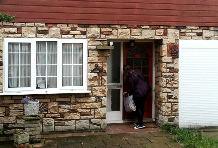

Can we see a pic of the whole elevation please?
Like this?
It looks like they were installed before the windows, so you'll have to move those in too.

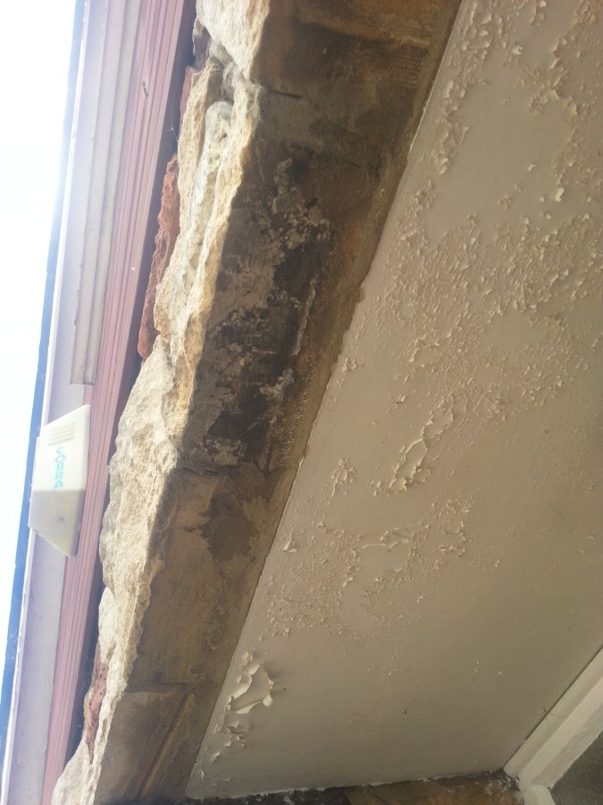

Bonus shot of porch area ceiling:

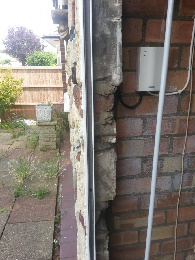

Those blocks in your garage definately look structural so I expect the rest of them are as well. On the house there will probablly be an inner leaf of the wall but the outer leaf will be part of the structure and not something that can be trivially replaced.
I guess you could render the wall or possiblly fit some sort of cladding. IMO those blocks look much nicer than boring brick or render but each to their own I guess.
You might be able to work out the construction by removing part of the wooden cladding at first floor level and looking at the top of the lower outer wall. If you can do that without trashing it.
