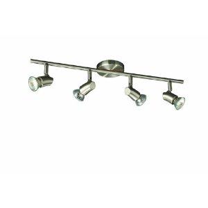

Hi,
We've just bought a house were the lighting circuit appears to be a loop-in system, i.e. the ceiling roses also act a junction boxes. The previous owners left pendant lights hanging (no shades). On the ground floor I'd like to replace these with circular and linear groups of GU10 220V lights. Before I buy these, how do I get around the fact that I have these ceiling roses which will inevitably be in the way of the new lights? What is common practice in this case? Am I supposed to take the ceiling rose out and reconnect everything using plastic connectors? Our ceilings are plasterboard.

Just to be clear, I'm not talking about replacing the pendants with recessed spotlights, just a one-for-one swap of a pendant for something like this bar of four spotlights below (or maybe just 2 GU10's instead of 4). Is there a way of replacing pendants with something a bit more modern like a bar of spots? Or are such lights made to accomodate the exising ceiling rose? Thanks.

Okay if you want to replace the standard pendant with the bar style light then I would use one of these for each replacement pendant light.
http://www.tlc-direct.co.uk/Products/ASJ501.html
You will still need to be able to access this but if you make the hole large enough (the new lamp base should cover it) you will be able to slide the ashley jb into the void.
When you replace the pendant with the new lighting system use the jb to continue the live, neutral and earth loops and just run the switch live, neutral and earth connections to the lamp.
As suggested there is a limit to the number of lamps you can have on any 6amp lighting circuit - total around 1380w - so it wouldn't take long for the 50w halogens to quickly build up.
Most light fittings like you have shown have room inside to accomodate the ceiling rose wiring. You will have to remove the ceiling rose. You may need an extra connector block to accomodate the permanent live loop wires.

Just swap the lights like for like. Remove the ceiling rose and terminate the cables with terminal blocks inside the base of the new light fitting (they usually even supply you the four you will need).
Ignore joint boxes, j501's, and chocboxes. Not required.

The problem with Lectricians proposal is that while some light manufacturers do provide a four terminal block , many don't. Furthermore, those terminal blocks that are supplied are often too small to accommodate the three sets of cables often required for the loop system, especially, if the conductors are sized 1.5mm. So you end up balancing on a ladder holding onto the light, the wires and nothing else while you are trying to fit the conductors into the terminal blocks.
What Lectrician should have said, was that both options are correct with pros and cons for each one.
In broad terms terminals blocks are cheaper but unless you are given the correct size terminal for the cables you will have to fit a new terminal block or add to the ones there and then cover them with either a chocbox (which makes them similar to an Ashley jb)or heaven forbid tape.
Ashley jbs or similar are more expensive and require making a larger hole in the ceiling. But they do make it easier, and safer, to fit.
