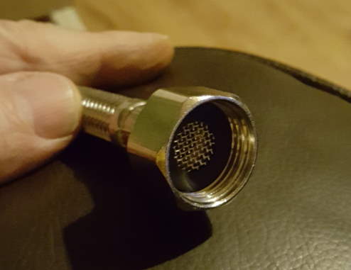

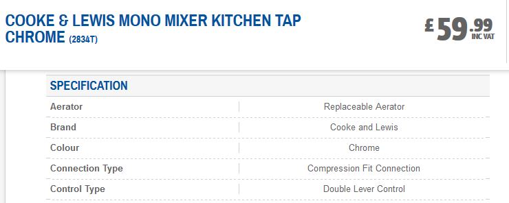

I thought the flexible tails supplied with my new kitchen mixer tap would have compression joints on their ends, but they're the kind with the little rubber washer.
How do I join them to my copper pipes please?
I don't suppose it's as simple as removing the olive from an isolator valve, and just screwing that into it...?
Really grateful for anybody who can answer quickly as I'm up to my knees in it in the kitchen :(
Pop down to screwfix with the flexi hose and they'll give you the bit you want.
You could screw it on to the end of you iso valve where the olive and nut would normally sit, but unless the end of the iso valve has a flat end it will cut through the rubber washer. It might work over night if its an emergency but don't leave it like that.
File down the sharp edge of the outlet of the ISO valve with a flat file. You'll end up with a flat end that won't cut into the rubber sealing washer. Only takes a minute as the brass is soft.
They are classed as compression as you need to compress the rubber seal between the male and female end to create the seal.
Yup. As per @Madrab just file it flat or leave it as is... There's many I have and haven't been called back to one yet... Now I've jinxed it! :notworthy:
Ummm… yeah, I get that, but… don’t you call the kind with olives “compression fittings”?
Anyway, I was temped to get the file out, but have ordered a couple of the tap tail adapter thingies, so just have to wait till Wednesday.
Yes, you do indeed, but any fitting that needs to compress something between two surfaces is classed as a compression fitting, whether that's a metal olive or a rubber seal.

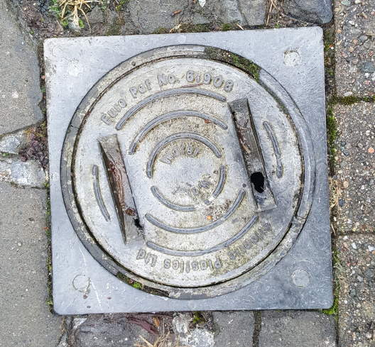

There’s obviously an outside stopcock next to the street too, but I can’t get the plastic cover up :oops:
