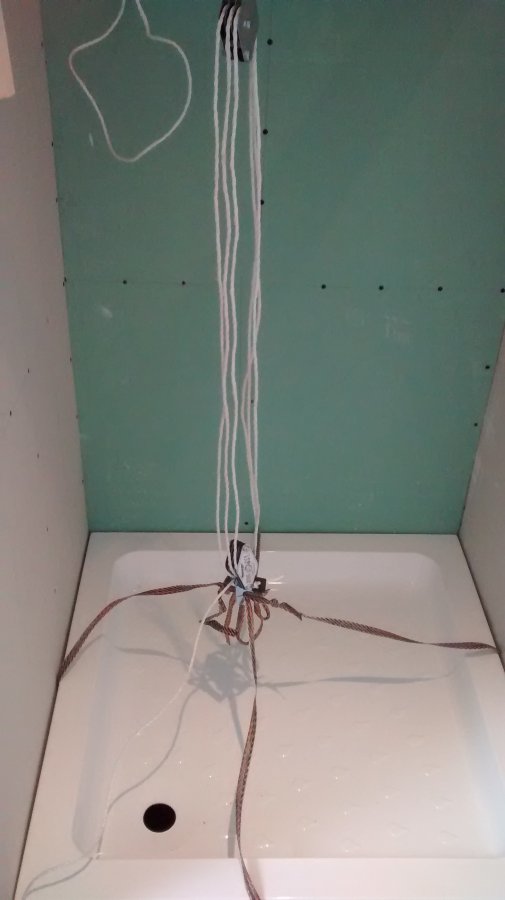

Thanks for your great tips and help on this - just thought i would post a follow up for the solution I used in the end.
I rigged up a simple pulley to enabled me to raise the tray; spread mortar then lower it with one hand onto the mix.
I used some redundant packaging straps from a builders merchant skip.
The pulley is from Silverline https://www.amazon.co.uk/Silverline-633957-Cable-Pulley-Set/dp/B0015NNONG and cost me just over a £5. But ill no doubt find other uses for it.

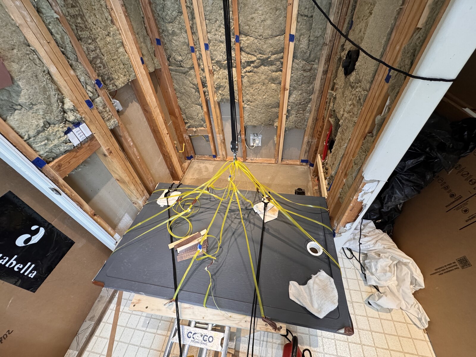

I took this idea three steps further to put a 200 lb stone shower base into an alcove. Block and tackle for lift, and a separate pulley to control horizontal swing. Thanks for the idea!
@Agile, is used a compression drain fitting )Westbrass D206p-07). I left the compression gasket out, but installed the outer housing while the shower drain was out with silicone caulk and finger tight nut and let that cure. As I lowered the shower pan, I had to align the pipe with the drain fitting, than lower. Once the pan was in its final resting place, I sprayed the compression gasket with soapy water and squished it gently around the pipe to the bottom of the drain body, carefully cut the pipe 1/8” above the top of the gasket (with dremel), and screwed the compression nut down on the gasket. No underside access needed, except before the pan was installed.
