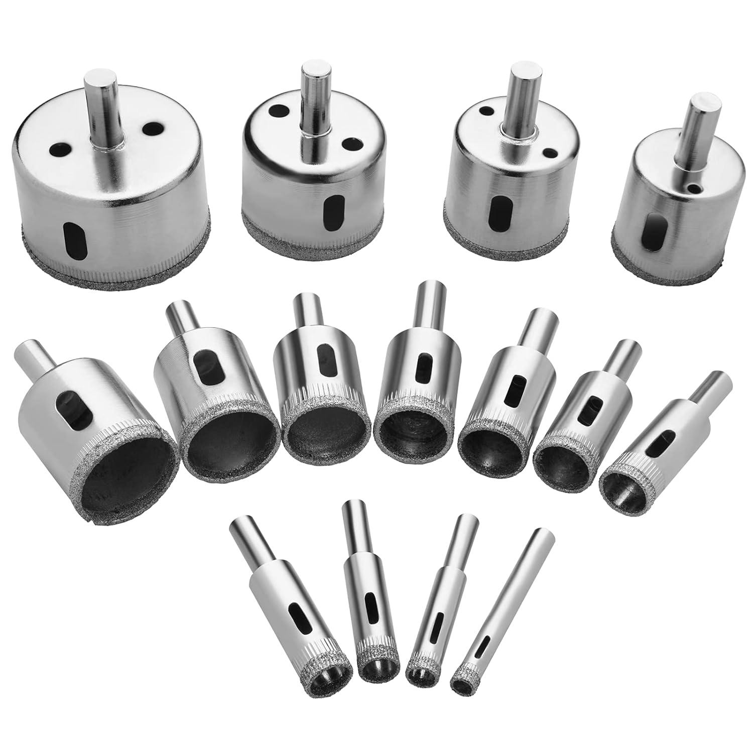

Diamond core bits could be worth a try and not shake around as much
I doubt they'll work. I think the soft plastic will just clog the abrasive face - leaving you with a smooth tube. So you'd need to run it fast enough to heat up the plastic and melt a hole through like the hit metal pipe method previously mentioned.
And if you do that, cheaper to just use a bit of metal tube.
