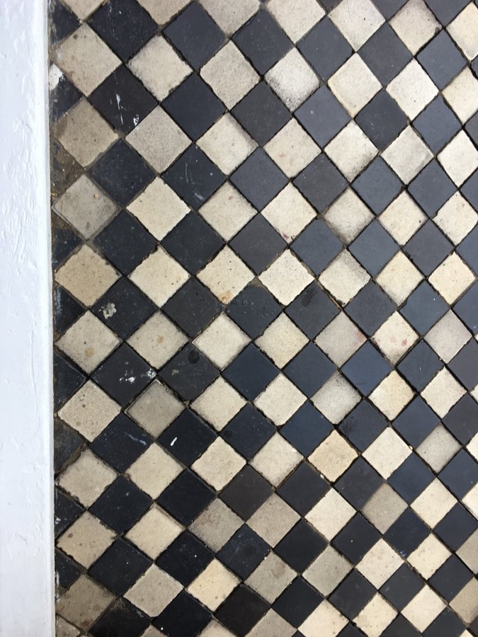

Hi,
In the front of our old building we have deocrative tiles where the ground, or whatever was holding the tiles together has come making some tiles loose.
What is the easiest way to regrout and with what materials? Do I use standard bathroom grout or cement? Any premade material I can use or do I have to mix cement/grout?
Grout is for filling the gaps between individual tiles, not securing the tiles into place.
If tiles are loose, the only solution is to remove them, clean the old adhesive/cement away and fix with new adhesive. Then apply grout afterwards.
Your tiles seem to be Edwardian - some neighbour's in the street will probably have the same on their entry paths. Check with them for accounts of any repairs that they might have made.
Usually, the reason the grout begins to degrade is due to movement in or on the backing base.
Is there side room for expansion?
IOW's the tiles are losing their bonding adhesion to the backing.
The backing might be a thin layer of sand and cement.
And the traditional grout and adhesive was a sand & cement slurry.
Take up some of the loose tiles and post pics of their backs, and the base backing.
Hi,
There were only a few loose tiles (on the end) it's mostly the grout between tiles that was blown away when I power washed them, so while one or two tiles I have to re-glue the rest I should be able to just fill in between.
Other maisonettes on the block also have the same tiles, some are in even worst condition, some have been completely removed, I can ask but do not think others have done much to preserve.
