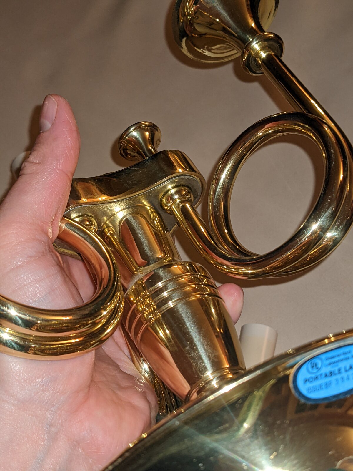

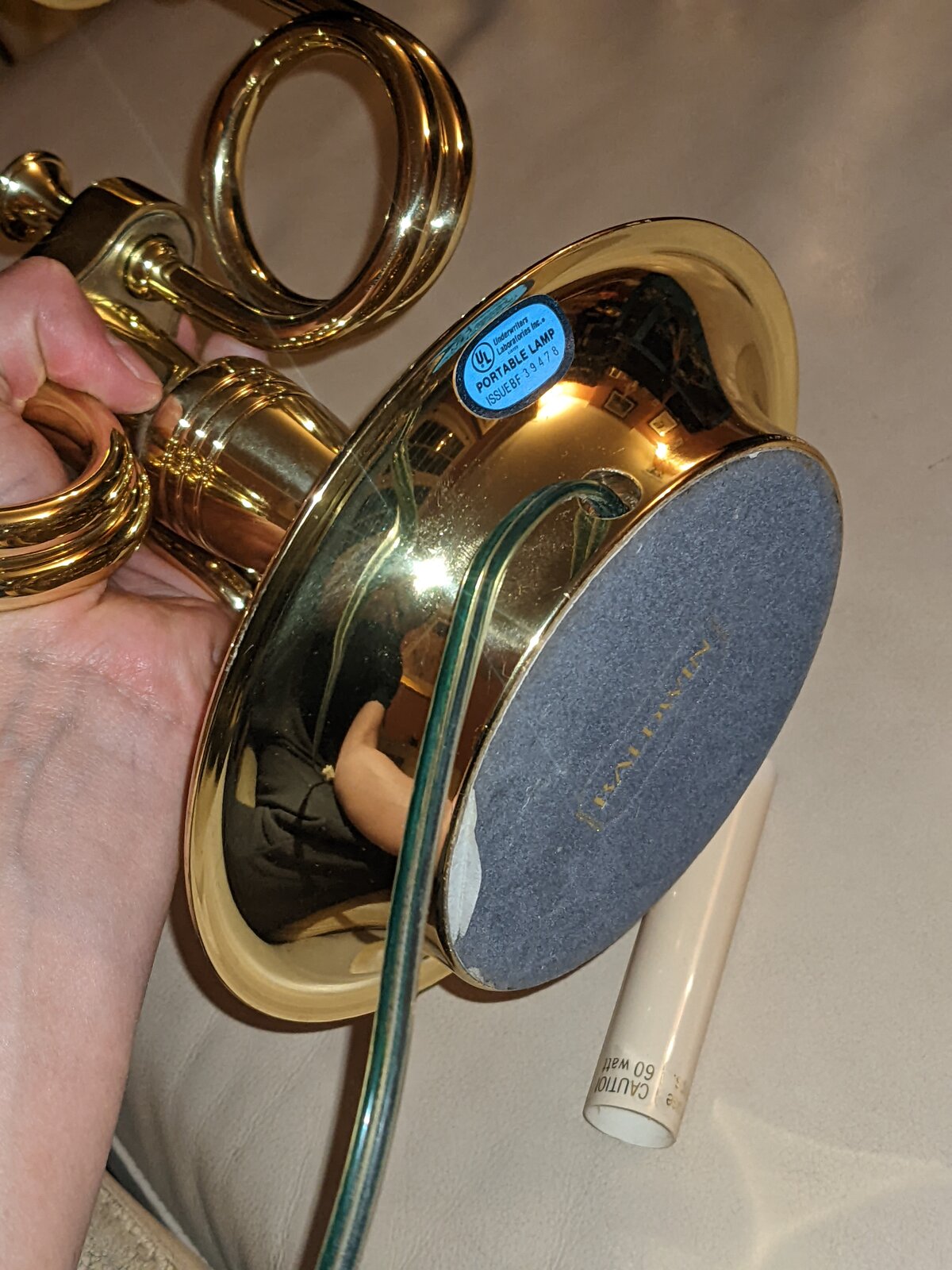

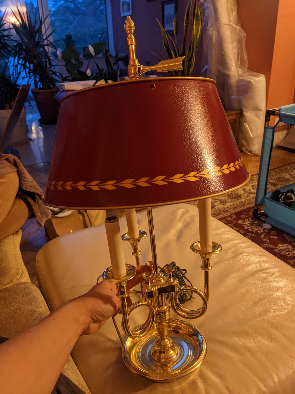

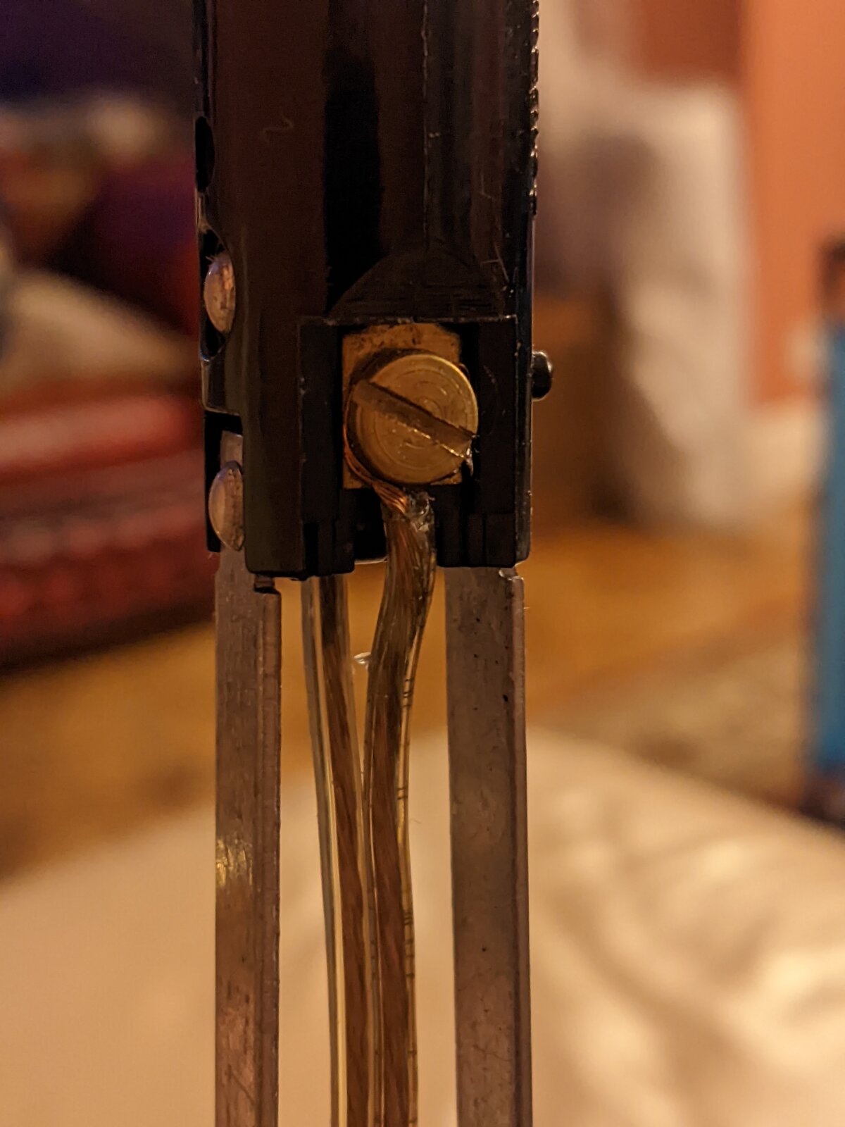

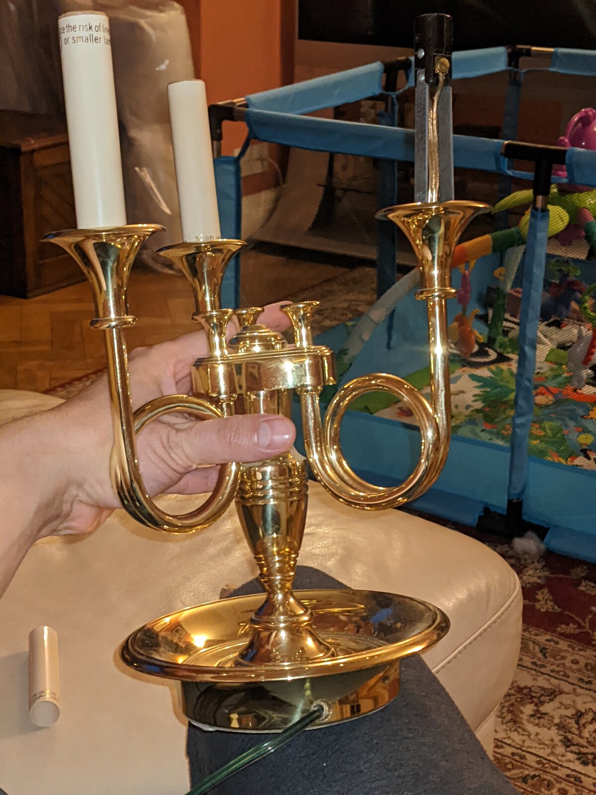

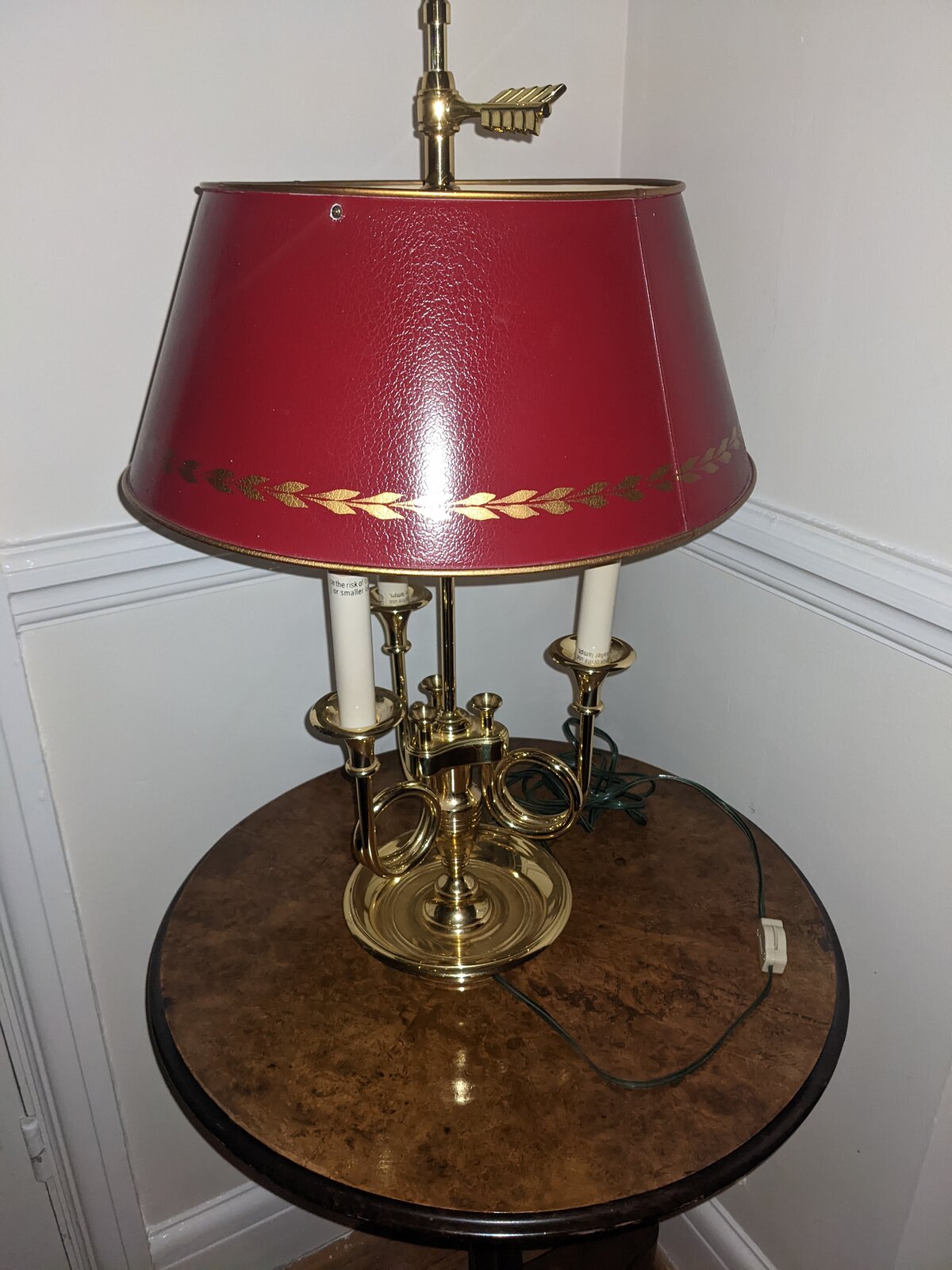

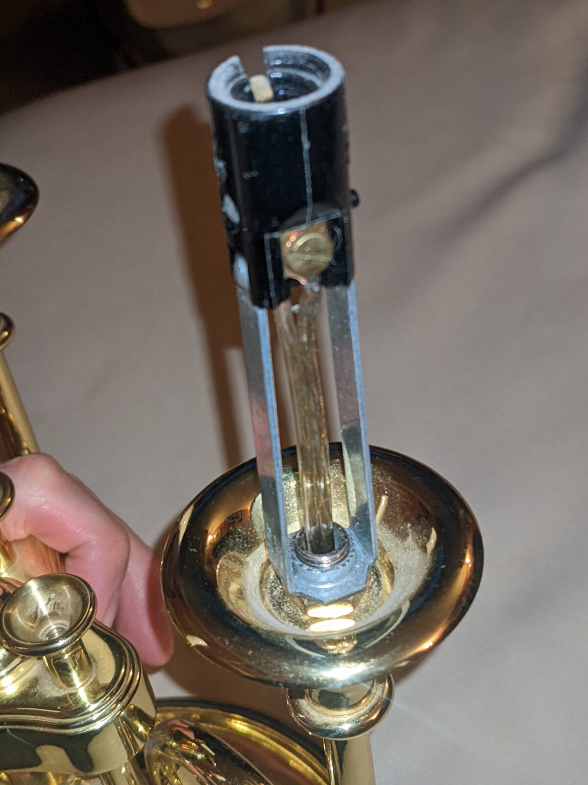

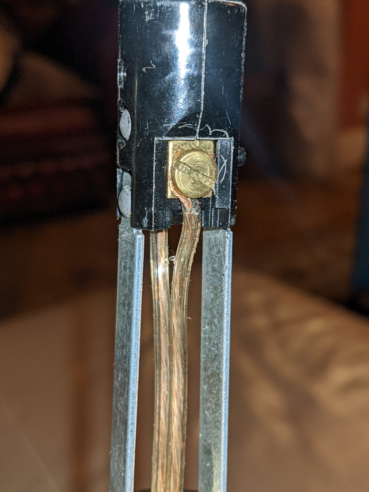

Hi all
I want to re-wire this 3-bulb lamp which has very old European/American wiring.

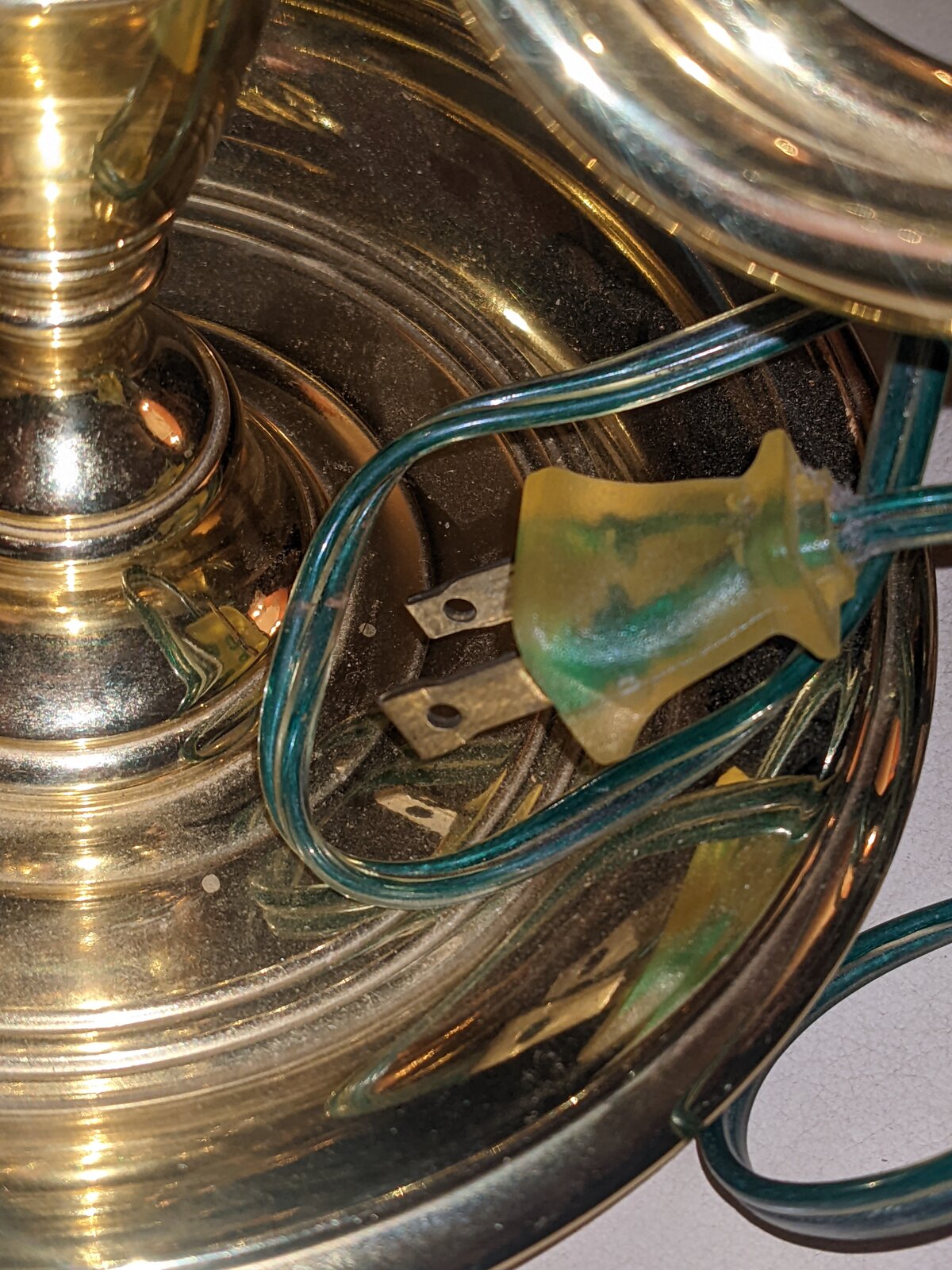

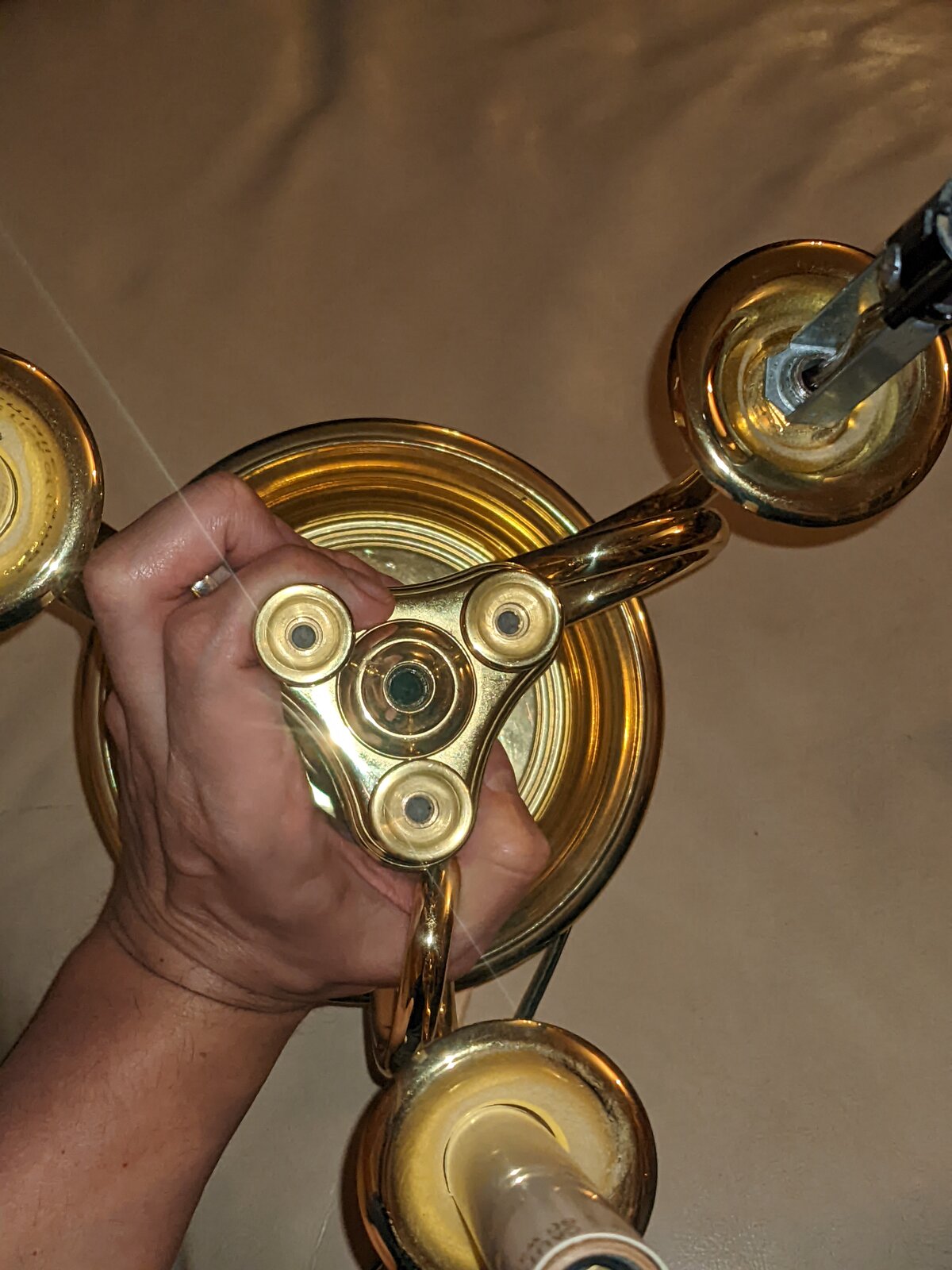

Question: I can obviously unscrew the wires at the bulbs and probably then pull out the wiring from the base, but how would I then drive new wiring back up the base and back into each of the curved arms?
I also can't figure out how the single wire at the base 'splits' into the 3 arms, which each have their own wires.

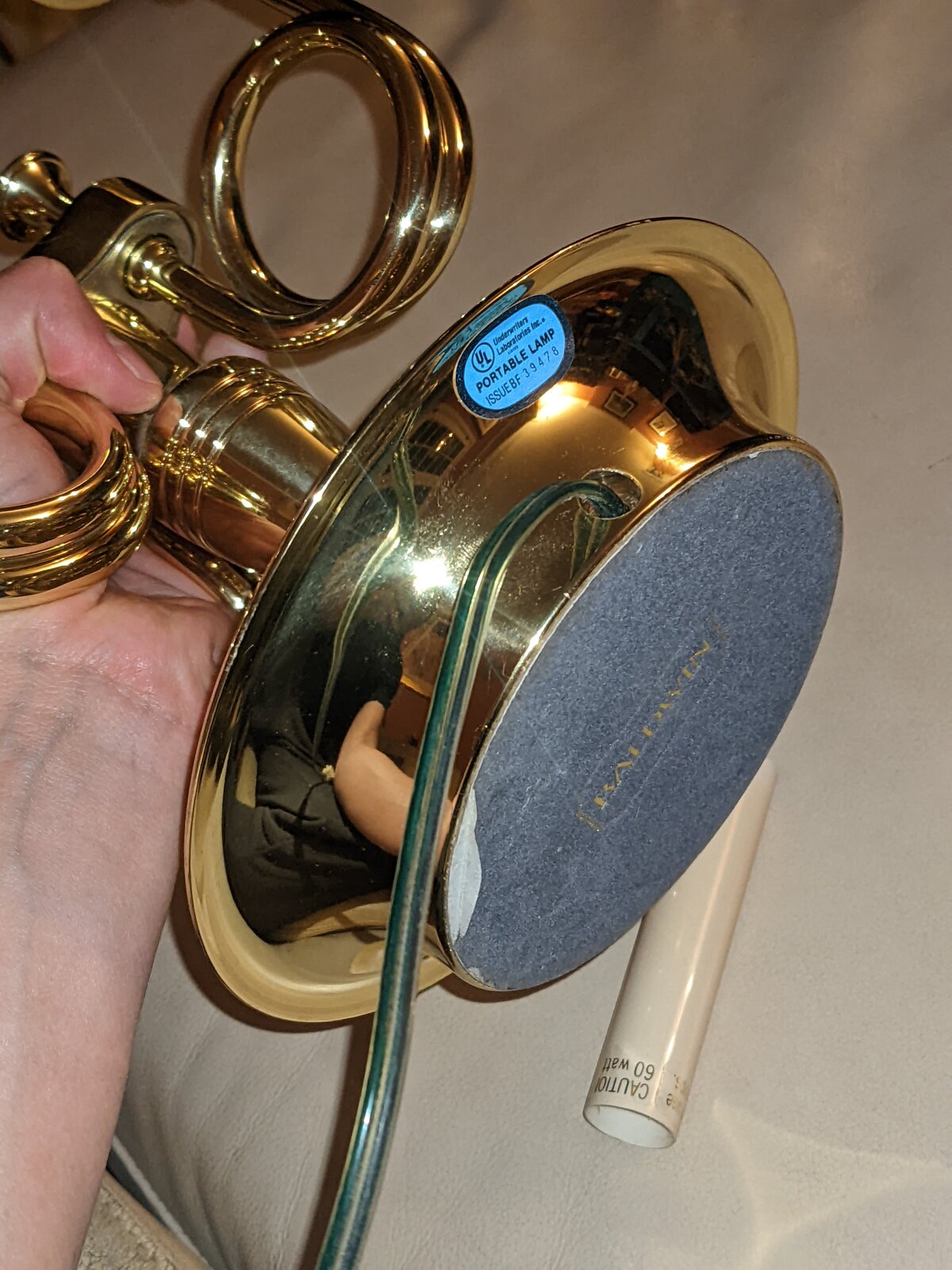

Perhaps I can peel off the base board to reveal something more accessible?
Any ideas?

There will be a joint somewhere, maybe under the base board you mention, or under the brass plate where the arms terminate. It's certainly not fit as is, to be used on the UK system. You need to wire it with three core flex, with the green/yellow bolted to the metal base. You will need to completely disassemble it to gain access to the open ends of the tube, the poke a thin wire down the tube, to 'fish' the flex through.
The lamps and lamp holder are an entirely separate problem.
Really helpful, thanks
I figure as I pull out the old wiring, I could pull some new wiring into it
But, either way, I've gotta remove some part to get the earth connected properly

Depending on the thread size, i would bin them holders and brackets and use 10 mm lighting bar and adapters and nuts to replace it and mount E14 holders that hopefully slide inside your existing candle drip covers.
Get E14 holders with a metal earth tab and this will in turn earth the fitting, using 3 cores of cable.
Use the old wires to pull in new ones, if hard or come off, use a small jewelery strong chain and this will self feed through the fitting then strap on your wire
E27 stands for 27mm, your holders look half that size
Thank you, that's really useful. I understand all of it, but what is a "10mm lighting bar and adapter"? Google search throwing up too many options! D'you mean like a hole threaded bar? Thank you again, really helpful
Yes its 10mm steel pipe, with an external thread and has a hole through it, lighting uses a special thread pitch, hence i call it lighting bar, that will mount the holder a few inches higher to replace that bracket, the adapters are like couplers but have an internal thread,, use them to fix your new thread to the existing stump of thread on your lights, however they may not be 10mm and need a thread adapter.
Most bits can be found on ebay too.
