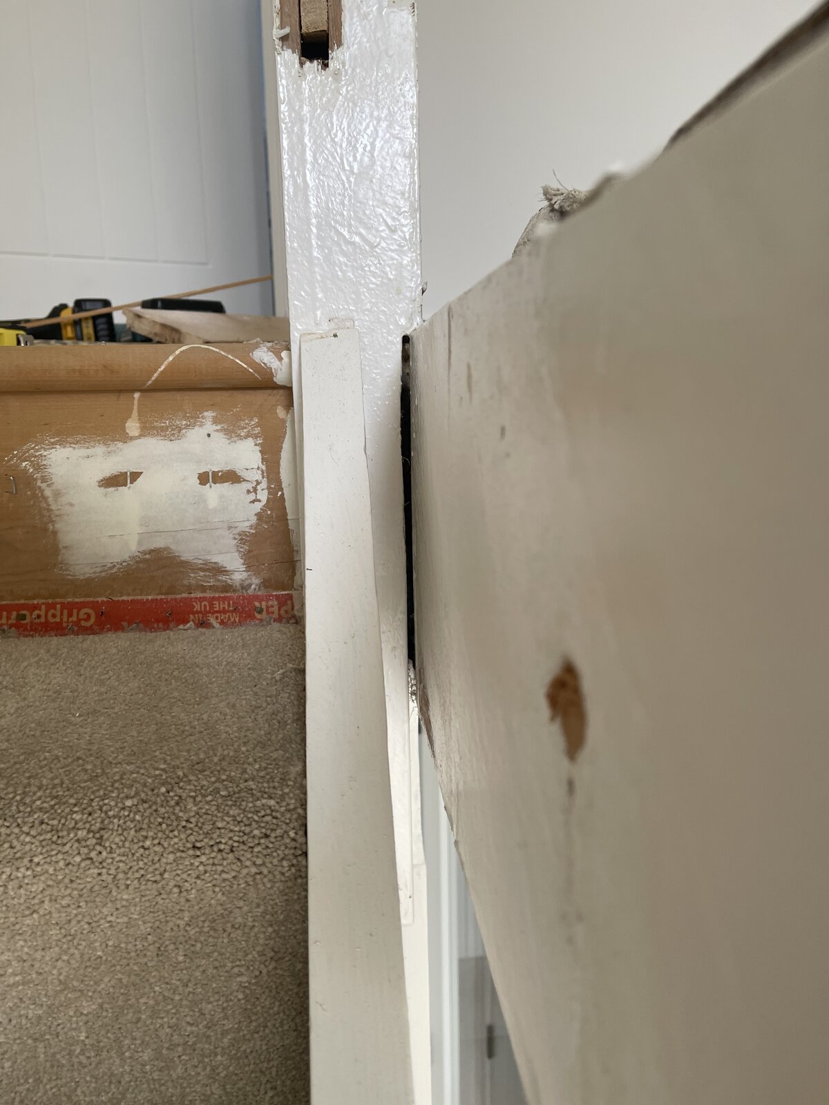

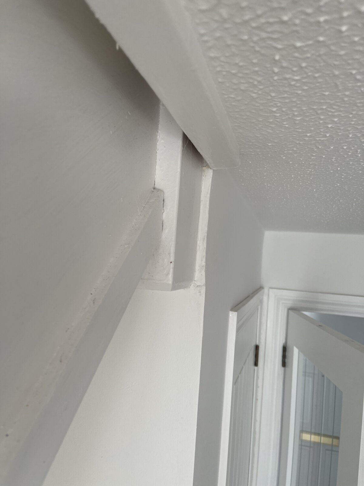

I recently moved in to a 1970s ex council house and decided the stair balustrade needed a makeover. I removed the bottom newel post fine, but I have some hesitations about the top one. I would’ve ideally just cut the top one and used a zip bolt onto my new post but you can see my issue for yourself below. The newel post is not a standard newel post size (about 78mm x 88mm) and it isnt Centre on the stringer so even if I was to use a zip bolt, I’d only catch a the side of the old post which may crack.
Anyone got any suggestions for what I could do to get my new post (90mm x 90mm) on? I’m not too bad with DIY, however still young so not got much experience hence if anyone has dealt with something similar then I’d appreciate your help.

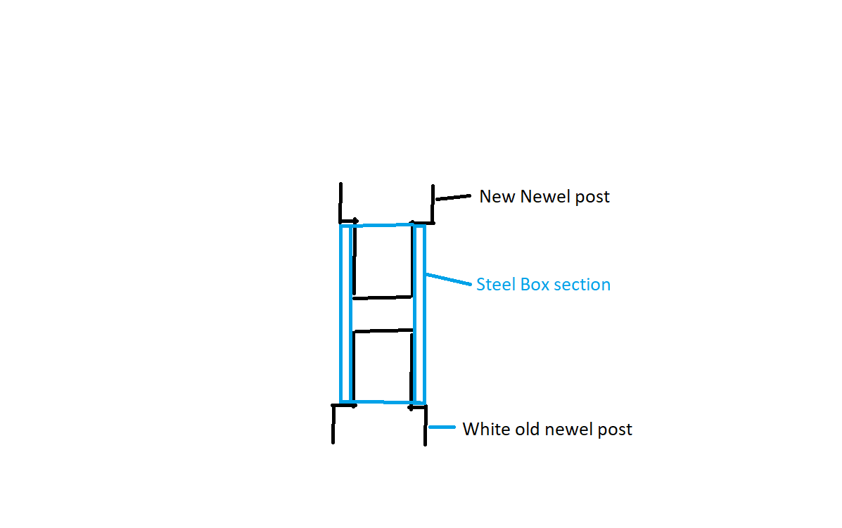

I would buy some box section: e,g, https://www.metals4u.co.uk/materials/mild-steel/mild-steel-box-section/12935-p
Cut off the old newel post leaving plenty sticking up. Trim it so that a length of box section over it, then trim the new one to suit the box section, slide it in and screw it all round with countersunk screws.
Hopefully you shoulkd be able to fill the screws and joins so that it all looks ok.

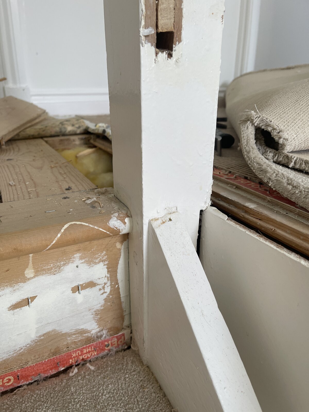

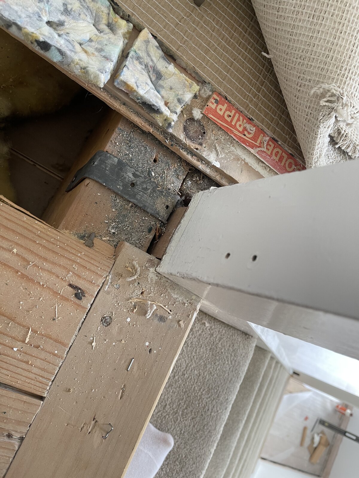

Do you know if this newel post would be structural for the stair case? I don’t believe it is - I lifted some floor boards and the newel post has been cut around them so it must’ve been installed after the staircase went in. I can see there is a tenon on the stringer, I am baffled at how they’ve managed to fit the newel post Right down under the staircase, without a cut or anything? They’ve obviously mortised out for the tenon but not sure how they’ve fitted it and managed to get it under the stairs, it’s a pretty tight space so not much room for movement

I don't think yours is actually structural, but it was passed as part of the safety rail, so must be safe and solid. From what you say, I think it was built in as they built the building.

Ah right, I understand what you mean. Not a bad idea although the steel would always be on show which I’m not so keen on. I have a one of these cable cameras that you can put down small spaces and there are no signs of screws or bolts holding it in place. Two dowels attaching it into the stringer currently. I’m planning on just trying to chap it out, then Put the new newel post in (but only down to the top of the ceiling (I.e. so it isn’t on show underneath), then plaster up any marks from the old one underneath.

I think the lower end length is for strength, so it doesn't move.
As for the steel, I was thinking it would be filled and painted, so it would disappear..

It wasn’t centre on the stringer and was twisted badly. It also wasn’t square so I couldn’t find cladding for it anyways

Just remembered from when I learned how to fit dowels. When you drill the hole, drill it very slightly off line, so it tightenes the newel on, when knocked in.
