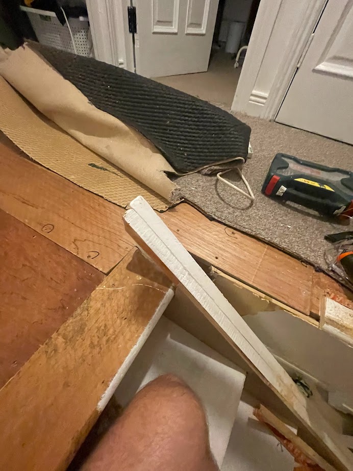

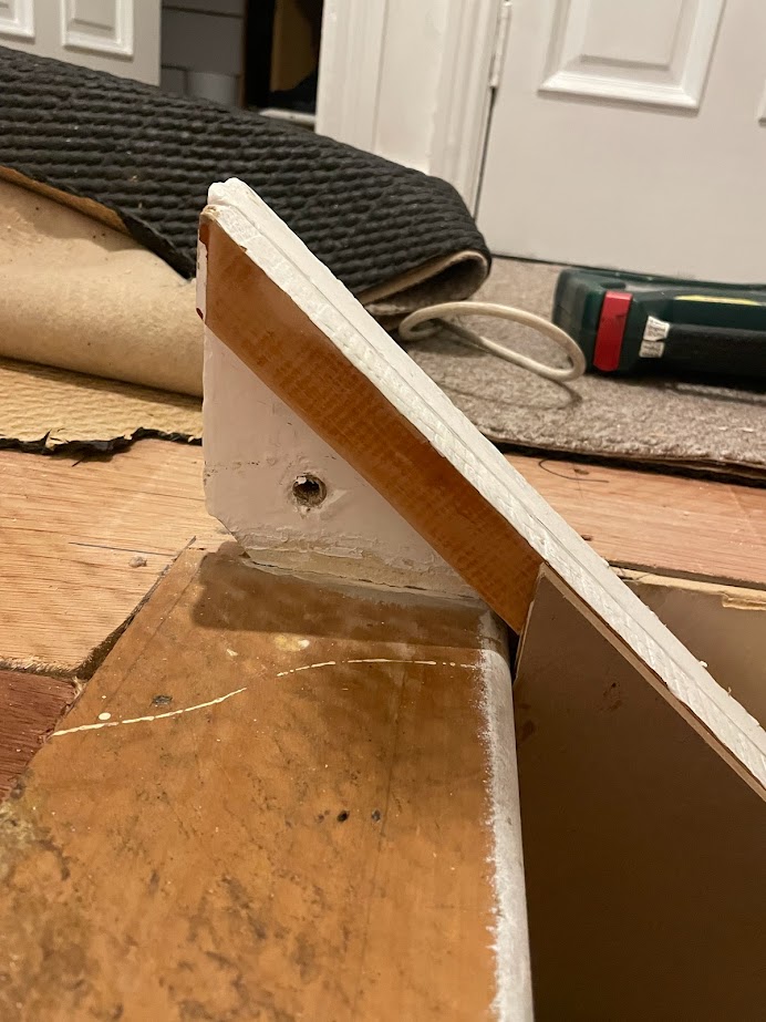

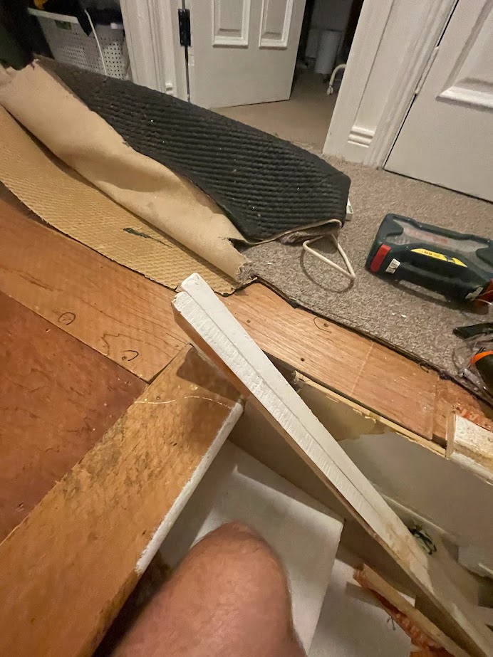

I would love a steer on the way to go with this newel installation at the top of the stairs.
for anyone wondering, the extra bit of timber attached to the inside of the stringer is how I am offsetting the newel and handrail slightly to avoid new handrail clashing with the landing ceiling. So Ignore that bit.
Newel post to install is 118x118mm

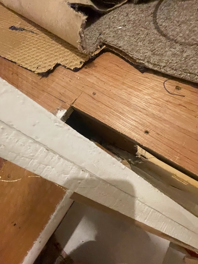

The question is on strategy for fixing the newel at the top. I was thinking maybe:

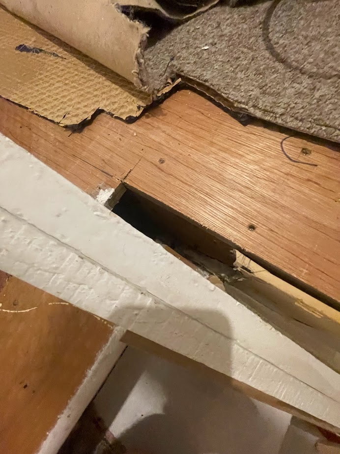

option 1: cut the stringer flush with the floorboards and cut the newel to have a chunk of it slot down between the stringer and the adjacent floor joist, glue and fix through stringer and joist. Would likely need tolift one of the landing boards to fix to joist.
option 2: leave the stringer more of less as is (triangular above boards) and cut a slot to accommodate it, somewhat straddling the stringer and possibly still have a bit that goes down the slot to fix to joist if that is necessary. I was thinking the triangular slot could be a bit more awkward for a somewhat novice in woodwork
option3: a better option you guys suggest?

you cant offset the handrail it must follow the string to keep the spindles vertical----
or am i misunderstanding this??
sorry yes i didnt maybe explain very well. I 'thickened' the stringer to essentially move/offset the centre of the stringer. The handrail baserail newels will all be centered on the now thicker stringer
Do you have a steer on the meat of the question in the post?
Best option is always to secure the newel to the most solid part of the job which is the joists so by all means house it over the triangle if you can but certainly run it down to be bolted to the joist.

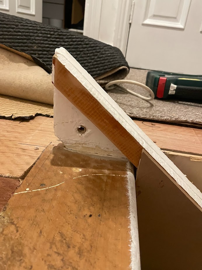

If going down to the joist with the newel is there need to straddle the triangle as well?
Also the way I'm seeing it, it looks like I might only get fixings in one direction through the stringer newel floor joist. Is that enough with the glue or should I find a way that I have opportunity for a fixing at 90degrees to that?
Not essential to straddle the triangle but would be a stronger joint and you could always cut the triangle to make it square or rectangular so easier to house in but as said, not essential. As for fixings coming in from one side is ok but again IF you can get from both or skew nail also it will make it more secure. As long as you keep checking for plumb as the joists will not be and you may need to shave or shim to suit.
Thanks very much. That’s a smart compromise to flatten the stringer to make an easier time of the notch in the post while offering up a bit more stability. Appreciate it

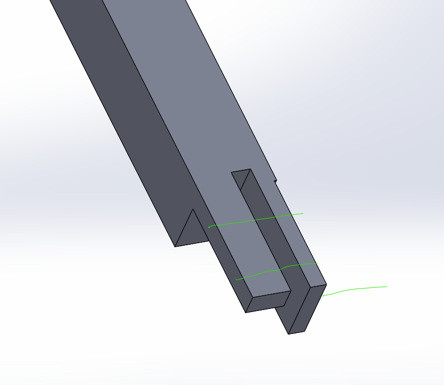

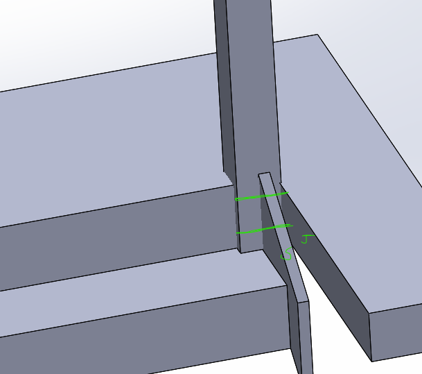

@DAZB I got bored in work, did a mockup CAD to see what the newel notch would look like....does this look like plenty of stability in the making?
It does and for added support and if you can get access then block or metal strap between the joist with the newel and the neighbouring joists so they will share the load.

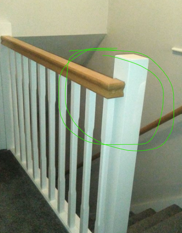

i was looking at my stairs again at lunch and I'm going to need a little mitre at the top of the stairs like the picture shown. Is wood glue and timber screws enough at the mitre joint or how should I approach that joint?
the mitre zipbolt looks too long for just a tiny mitre like that. Want to avoid fixings clashing with the fixings to newel post!
