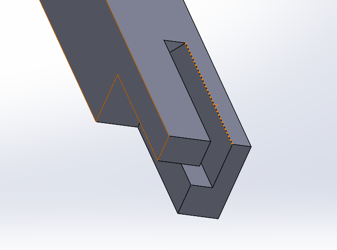

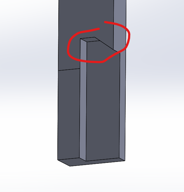

@DAZB how would you go about this notch? The second image is a section that shows the angle bit inside to home the stringer. I wanted to avoid making the stringer section rectangle cause it took meat off and leaving it rectangular right through the newel would have a big section of stringer at the newel face rather than it 'disappear'...if you get what i mean

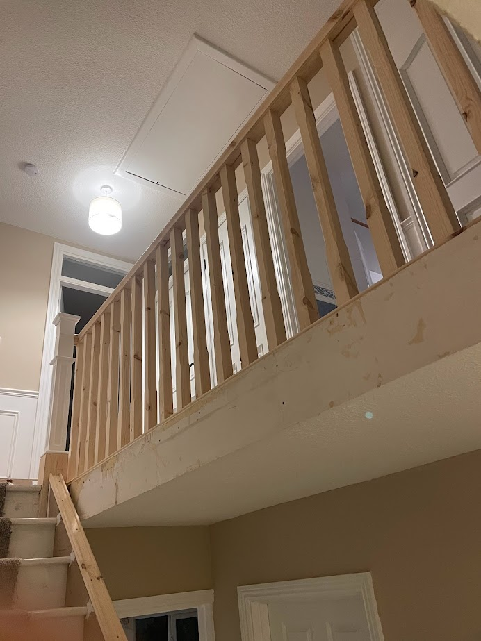

reminder of what im dealing with is last image
Figure 2 looks like it will do what you need but if you are wanting to hide the stringer completely you have the option of rebating the stringer to make it thinner and house it into the newel.
I see what you mean! Basically make it into a small square dowel!
How would you approach creating this fairly complicated notch? I should probably at least get a sharp set of chisels
The oscillating multi tools are made for those kind of jobs so well worth investing in one and if not then, yes, some lovely sharp chisels will do it.
Just read this again, the figure 2 there is a section through figure 1, just to show the slot inside.

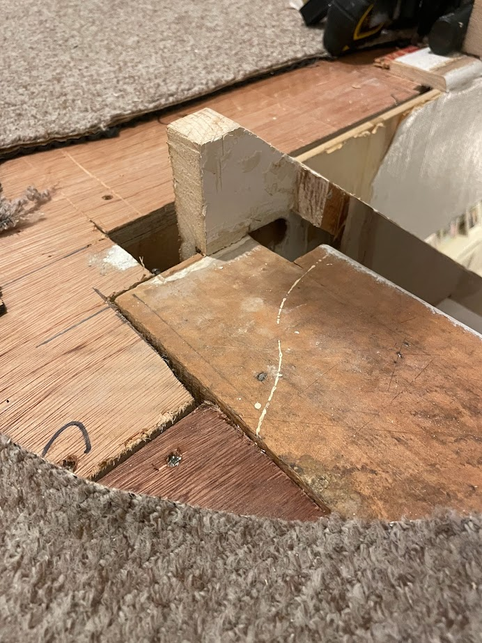

As I am drawing out the notch here I realise it will be near impossible to get the angle recess to house the stringer Becuase of the notch shafts either side. Just can’t get at it! Any ideas?
I might just need to flush cut the stringer with floor board and forget about it as extra support. I will have fixings to the stringer and floor just still
May be easier cutting the peak off and doing a simpler tenon style housing and putting it together with plenty of PU adhesive in the void where the peak was and it will be as strong as the timber and added to the other fixings you can get in you will not have much issue with movement.

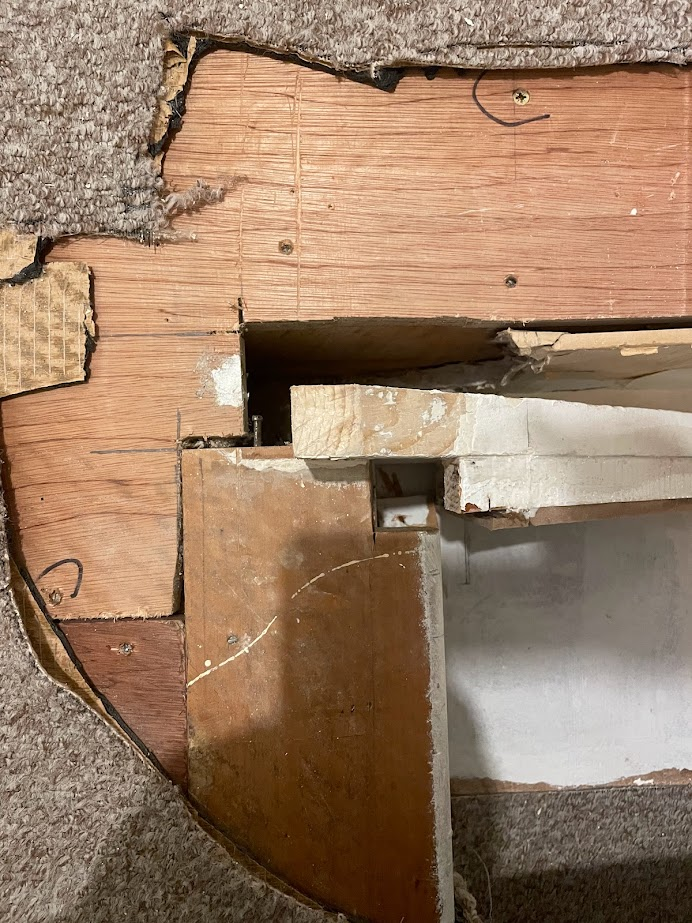

I didnt see this until this morning but I did pull up a section of floor and add multiple fixings through a floor joist and the stringer, plus glue, plus and block I added between joists to butt up against the back of the newel post for even more support with another fixing through it. Probably went a little OTT but that newel post is going nowhere in a hurry! thanks for the tips!

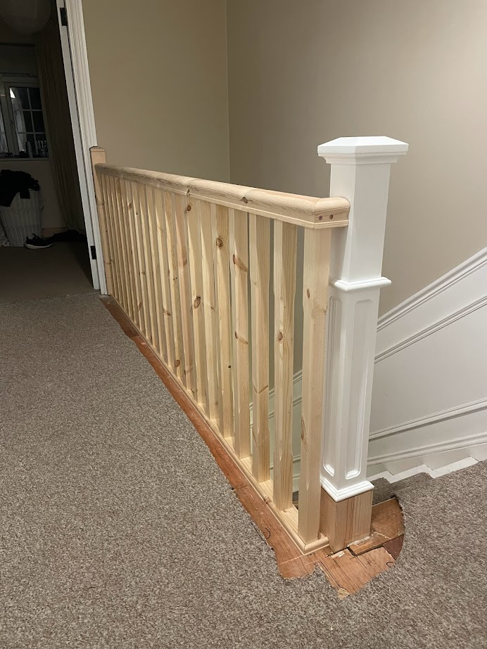

Heres the landing I completed yesterday. First attempt as a DIYer at stair components. Quite a satisfying end result when, after all the turmoil and thinking, you have a lovely level, plumb and sturdy result!
@DAZB FYI progress
excellent job bet your please
you and dazb deserve all the praise as you both did all the work (y)
