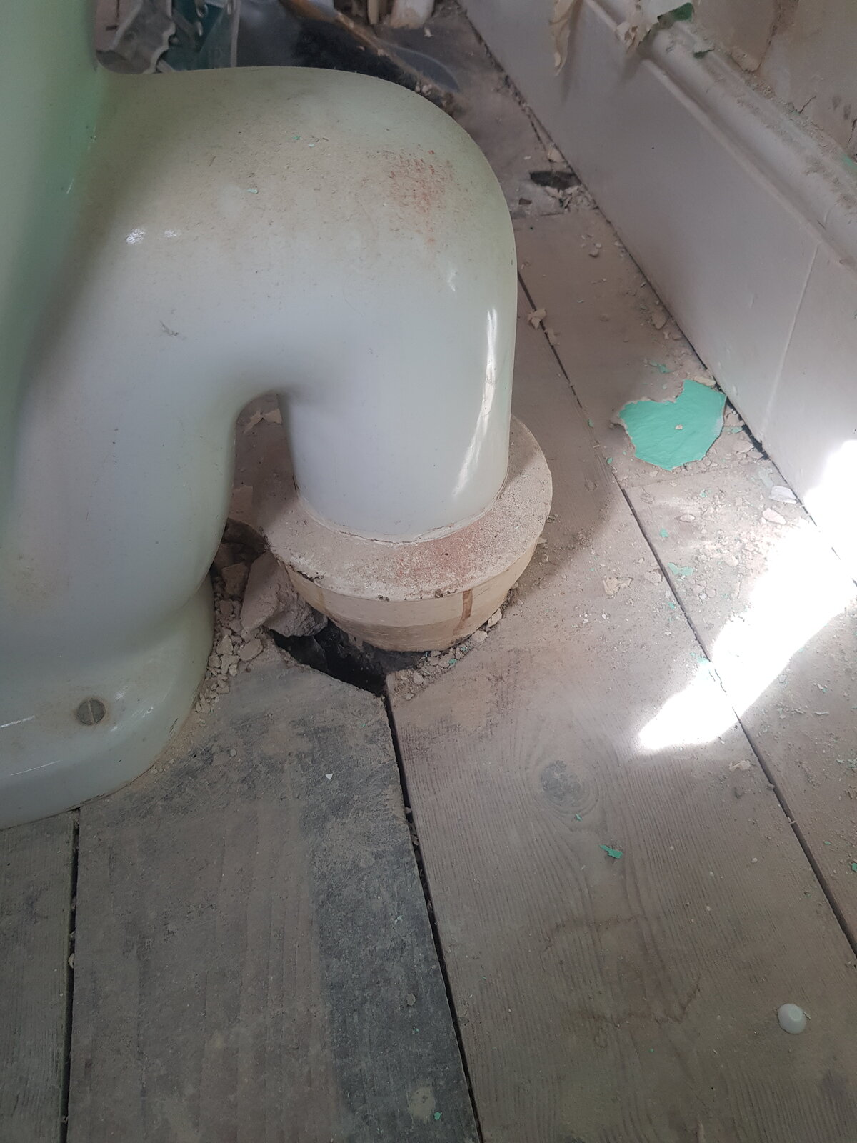

Hello, I need to replace this toilet which appears to be attached to cast iron soil down pipe and encased in some sort of cast iron enclosure where it's connected.
Is there a specific way to do this? Should it just be hacked off? See pic

Hi, what type of WC do you intend to replace it with?
Thats an "S"-trap WC, they are still widely available but most modern WC's are "P"-traps.
Best not to smash anything until you know what you intend - lifting the floor board on the the skirting side will help you see how the CI soil pipe drops or bends below the floor?
Why not pic and post whats down there? And a pic showing more context of the whole WC?
Do you have a 9" angle grinder?
Do you know what the final floor covering will be - tile, sheet vinyl etc?
Does your mains house isolator work easy?
You may be able to fit one of these but I would consult an experienced plumber to make sure the seal was good.
A standard HO outlet pan would be hgalf across the room with your set up.
Get a screwdriver and check what that moulded seal around the pan spigot is made of, is it soft or is it hard cement? That will determine what approach may be required.
I took in all your suggestions, but in the end took and angle grinder to it. It's basically a clay encasement with a steel outer.

Eventually I replaced the cast with plastic, but thankfully access wasn't bad at all.
