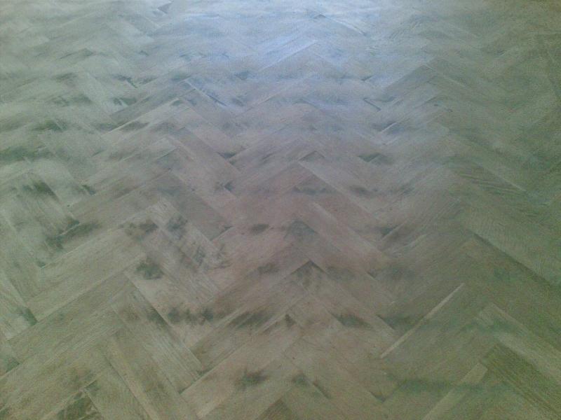

Hi,
I had a go at sanding my parquet floor this weekend. Following recommendations from previous threads, i hired myself a Trio sander and went through the grit levels, 40, 80, 120.
The problem is that the entire floor now looks like a zebra. My guess is that where there is a gap between each of the underlying floorboards, over time it has warped the parquet sitting on top. I can see the visible "ripples" across the floor. The sander was probably sanding down the ridges but not the troughs.
So, how to get it all to one colour so i can varnish it?
I think your best bet is to re-sand using a belt sander (80 kg!) with grit 40 or 60 to level all ridges down first.
The trio-sander wasn't heavy enough for this job.
Thanks for your help.
I'm also trying to locate a few pieces of parquet to replace the damaged sections.
Each piece is 12" X 3", with a thickness of about 6-7mm. The wood is oak. Can anyone suggest a source for this?
One last question.
Would the heavy belt sander remove the 'ripple' effect that's causing the stripes? So the floor becomes completely flat?
More chance of that indeed, because of its weight and ongoing belt.
