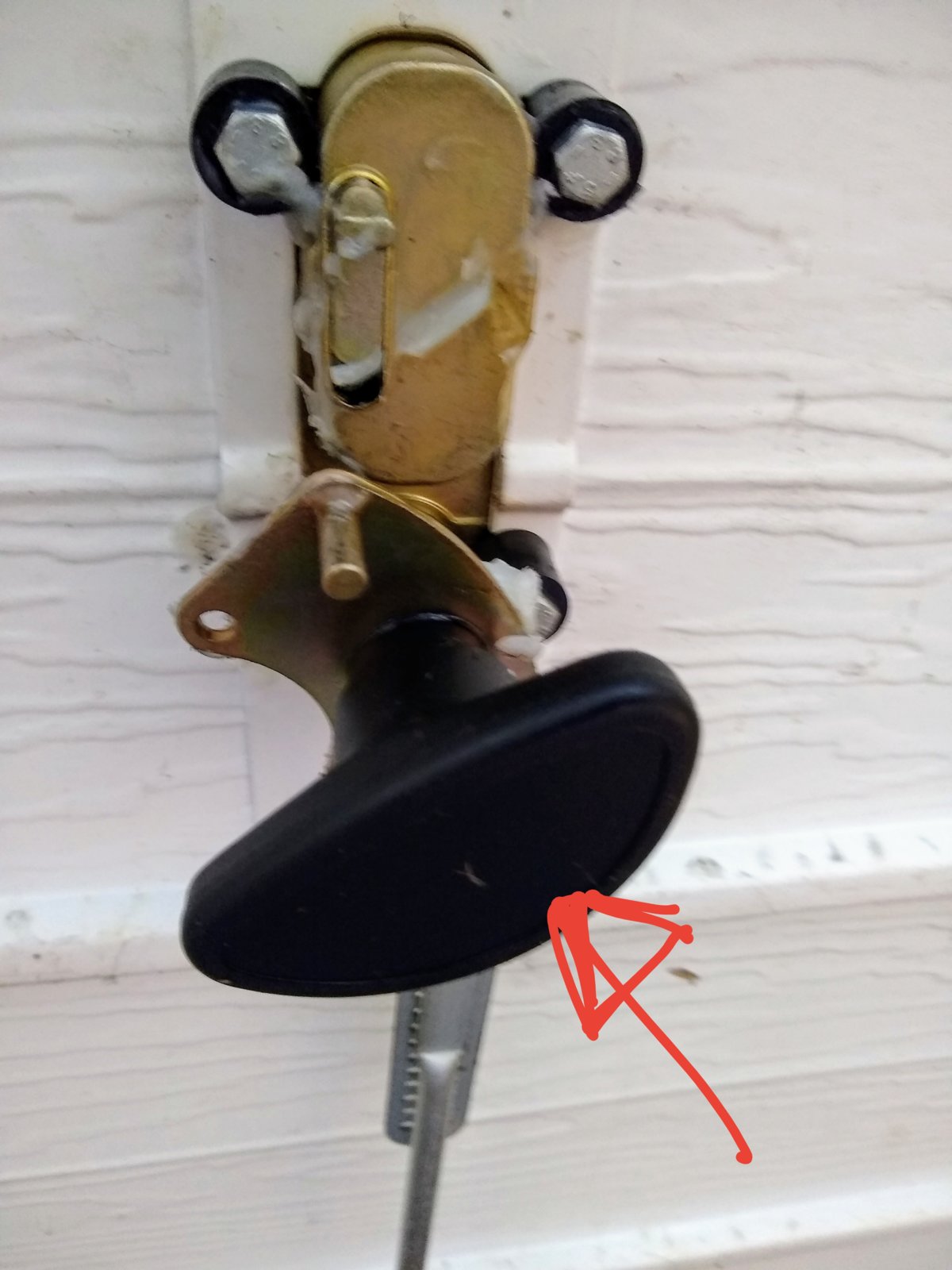

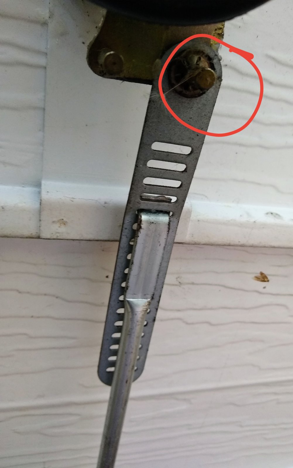

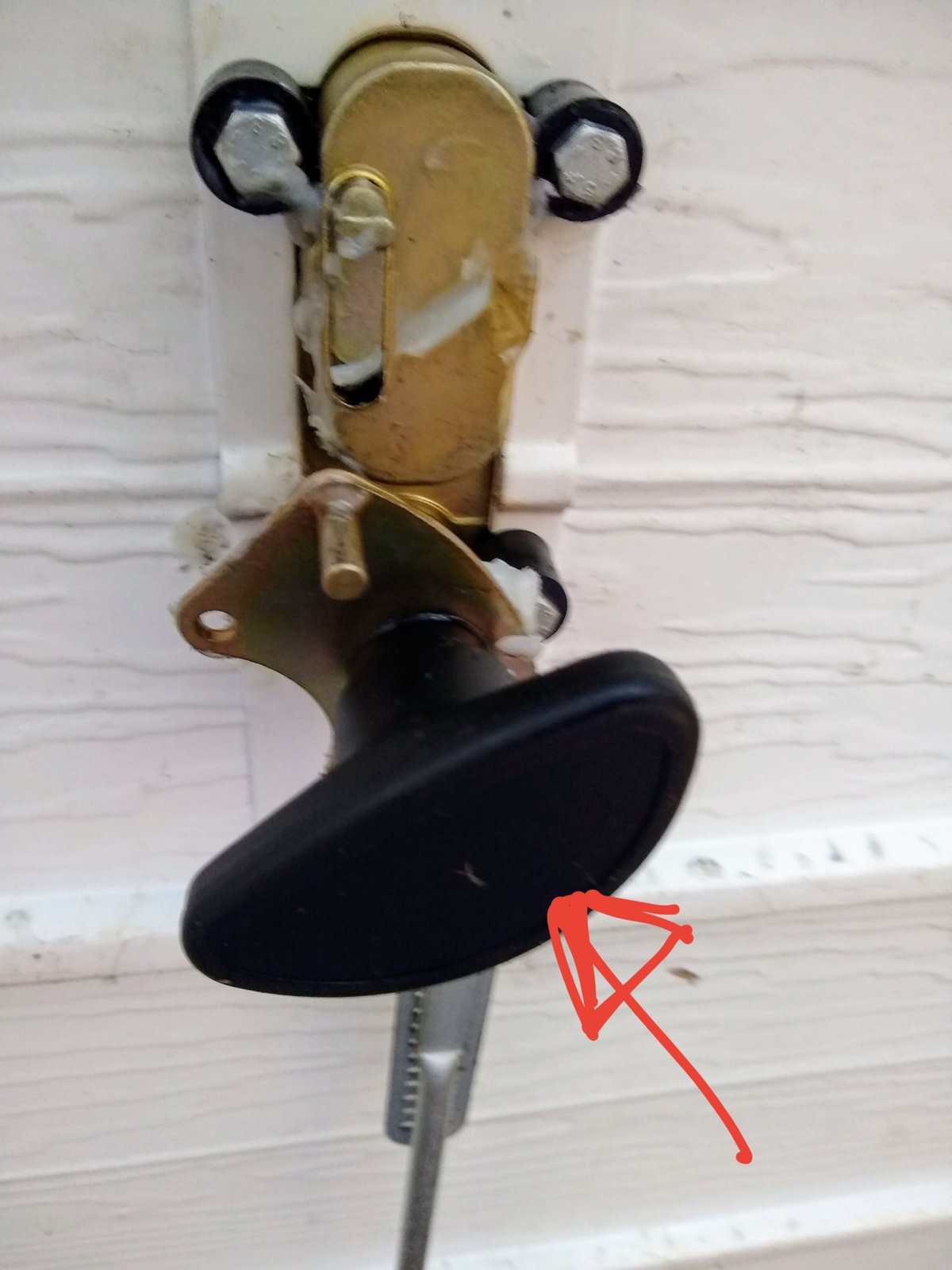

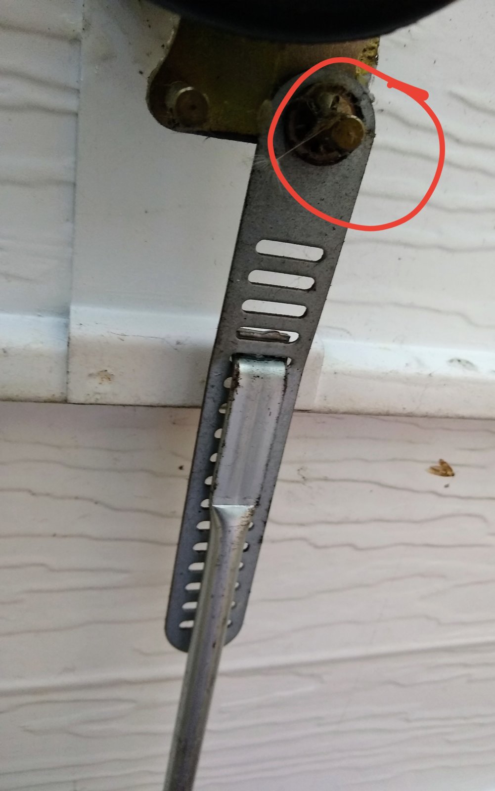

I am struggling to remove my garage lock for replacement?
I have removed the four silver bolts (although three are pictured) and the lock has come loose
However i am unable to remove the lock in its entirety. I believe i have to somehow remove the parts i have circled, but i cannot see how
Does anyone have any suggestions?
If it helps, the label on the door states that it is a Garador Horizon 90 7066

Angle grinder?
Thanks Alex.
Riddle solved.. After removing the four bolts, i noticed a little screw. This was holding the euro cylinder. Once removed bob was my uncle and job's a goodin' :D:D
