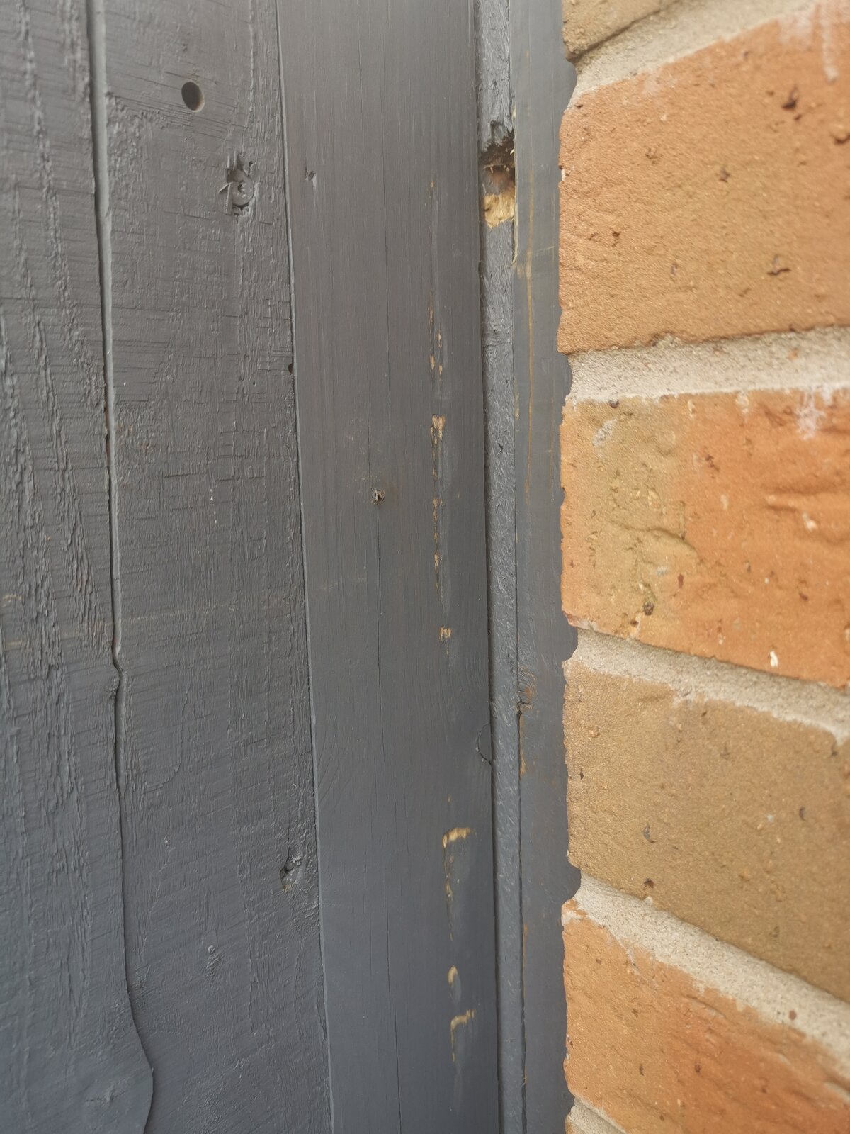

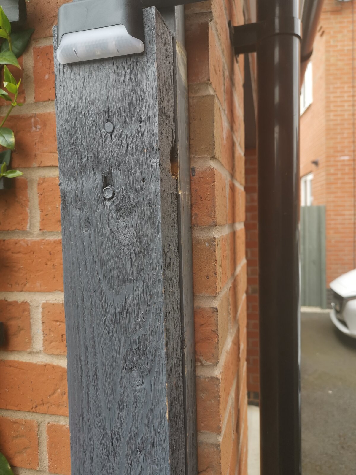

We've a new gate going on soon and I wanted to stop it from hitting the garage wall. I think the previous owners changed the posts to put in a lock.
I'm going to put new brenton bolts on and a latch, I think I'm going to need to remove one of the posts to be able to use the latch.
Question is how to stop the new gate hitting the brick wall? I've been thinking about putting a small strip of wood at the top, the bottom gets too narrow

You need a door stop?
A length of wood screwed to the frame to stop the door going all the way through the fame (on the wall in your case).
A long length of wood screeed to the frame would be the normal way
But as you highlight the gap gets snaller, your small bit of wood at top works - but will be less secure.
Perhaps Use the first wood post (furthest from the wall) to put the latch on to give yourself more space to put a length of wood on the second post next to the wall.

If I move the first post over to stop the gate hitting the wall it puts the gate out at an angle
You don't have to cover the full length of the door.
Say 150mm at top, middle (next to latch to secure it) and bottom.
Paint them green or black.
Otherwise a rubber doorstop screewed into wall.

I don't understand. you probably have a mental picture but I can't see it.
