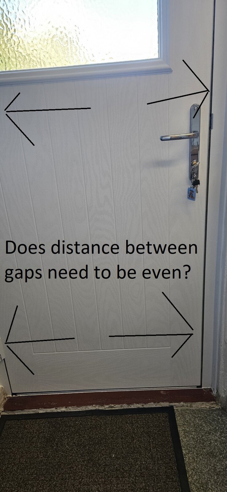

Yes the door fitter said he prefers a tight fitting, I tried 4mm grey packers on the inside of the gaps and they all fit fine (like in the 4 black arrows), maybe they don't require to adjust it after all.

maybe its of no concern again, but does the distance between the gaps need to be equal in distance?
I noticed that between top, middle and bottom the distance is not equal id say roughly 3-4 mm smaller and tighter gap difference in middle and bottom when using a measuring tape, I would have thought bigger would be fine to allow expansion but its actually 3-4mm tighter. Nothing to be worried about?
