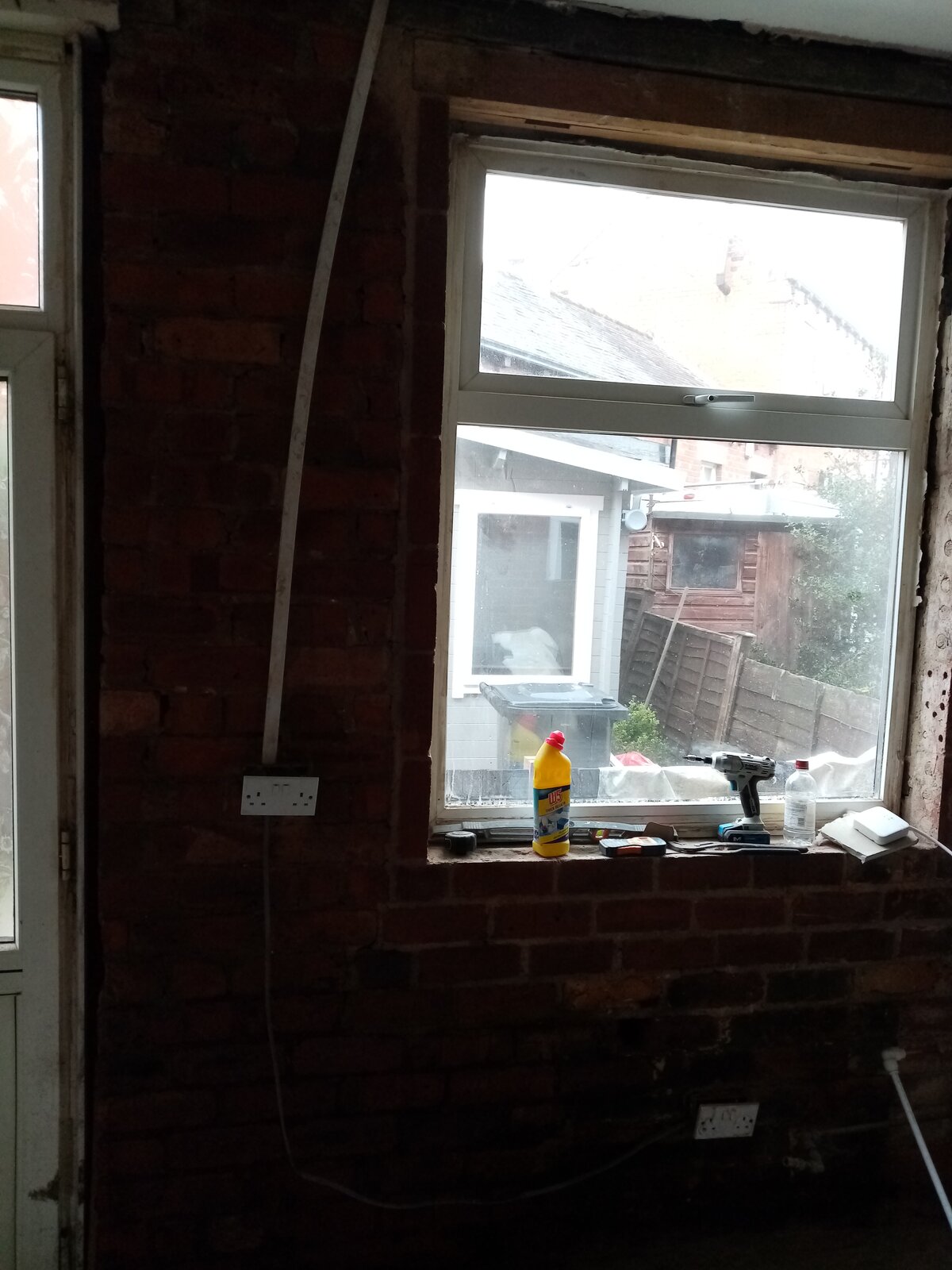

I need to terminate these sockets ideally from where the cable comes from ceiling.
Reason being I need to tnsk the whole wall and fil in voids behind... How do I terminate the cable coming down form ceiling?

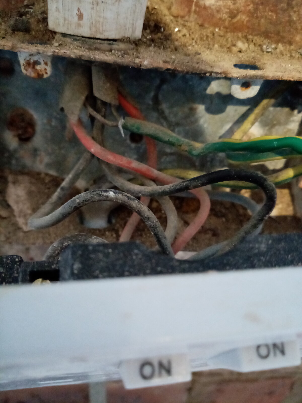

There are two cbsles: 1 with red and earth cable, and the other with red, black and earth
When you say "terminate these cables", what do you mean?
It looks to me as if there are two cables coming down from the ceiling then a third running from the bottom of the socket to the next socket on the RHS.
All cables should have 3 conductors connected at each point.

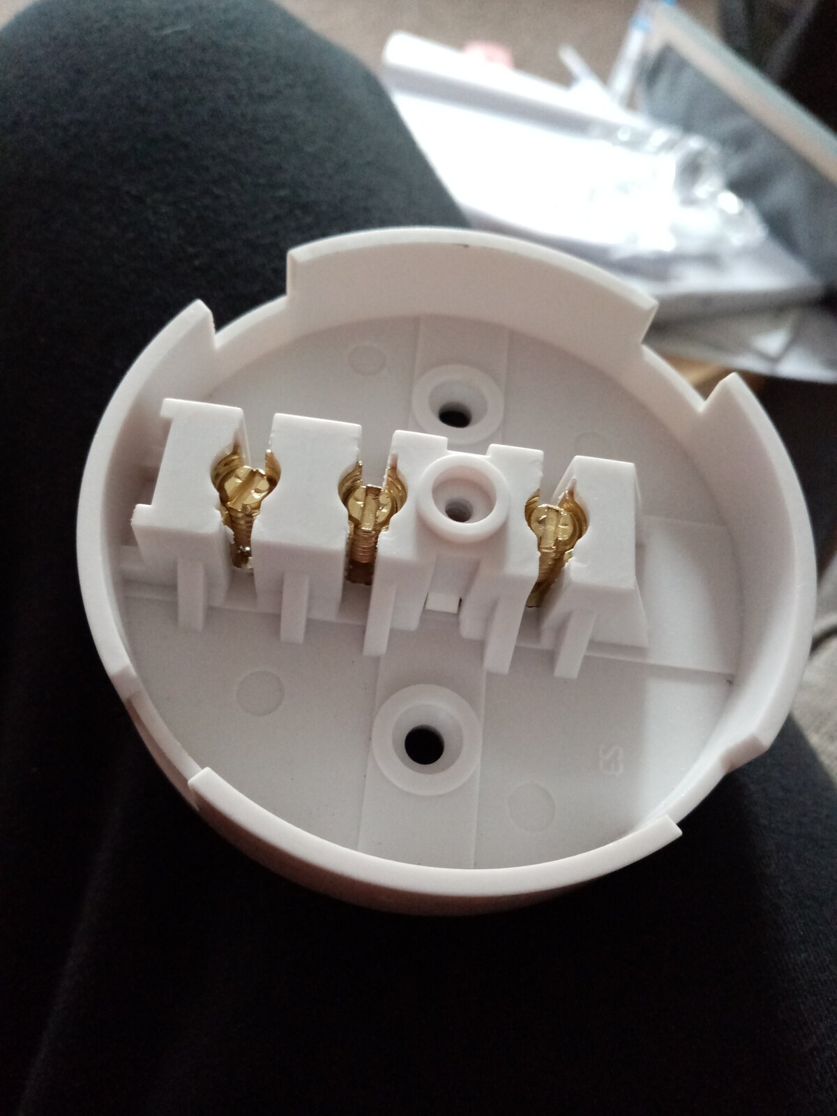

basically i want to remove the sockets and make the cables safe that come out of ceiling?
Do i connect them into a terminal block of some sort?
Then disconnect the other end of the cable. Is there a socket in the room above the ceiling?
I have bought a 30 amp Junction box.
Is it simply put both black cables in one terminal, both red in another, and both earth in the last one? They're not marked L, N, E.
cheers
it's just a temporary measure so i can take the back boxes off the wall, fill in with sand/cement where they chased them out, before i tank the whole wall with slurry. I am then getting my kitchen electrics re-dpne by an electrician so was going to get them to sort it all out when they do the kitchen.
cheers
Ah ok. I was concerned that you were going to bury the joint somwhere!
Yes, connect as you suggest above. Secure the cables so they cant pull out. Those round JBs do not have any strain relief.
