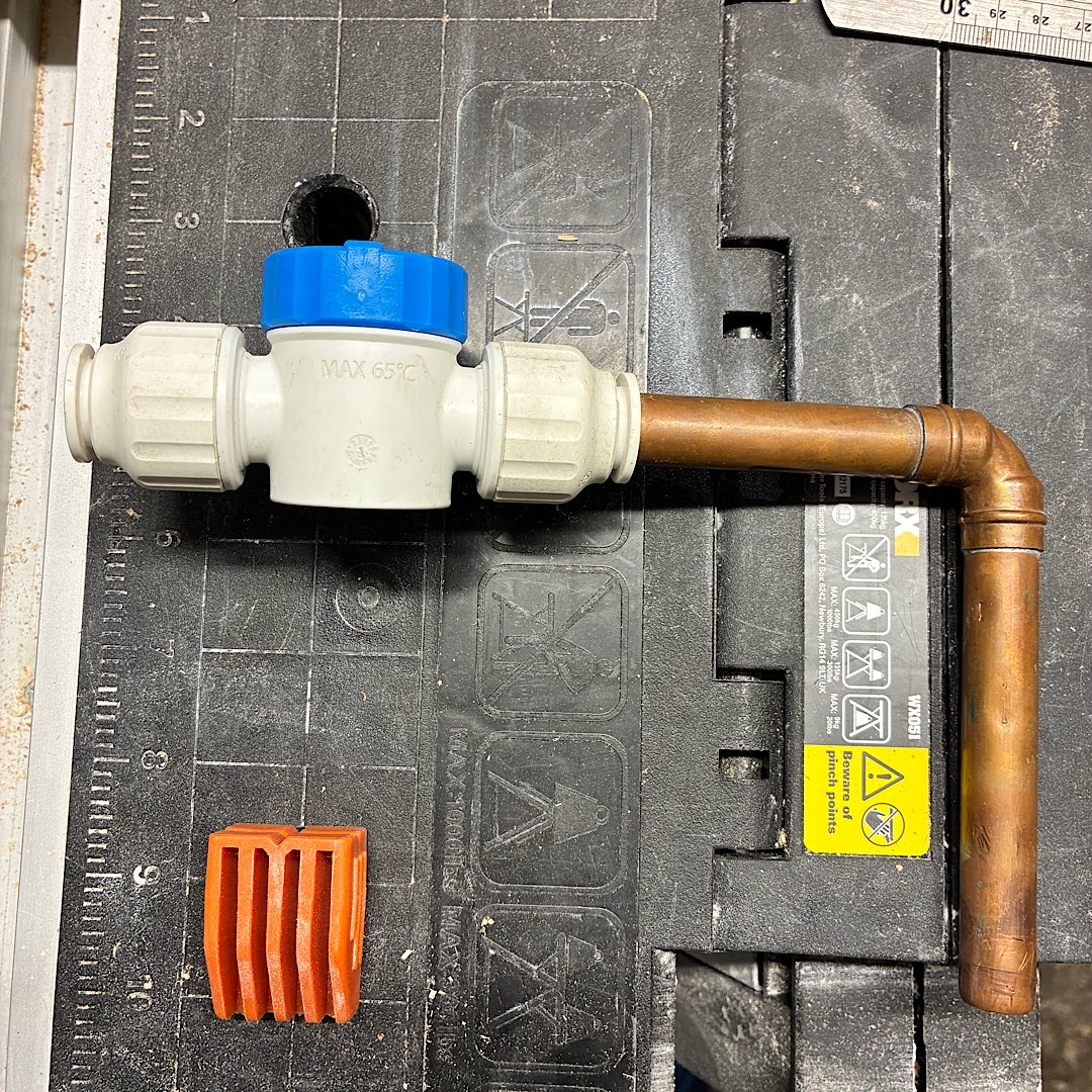

To do what I believe you want to do, I did the following:
I bought two of these...
push fit shut off valve
I then used some elbows to make some right angled short pipe runs to fit on the other end so I could direct the flow into a bucket as I opened the valve.
