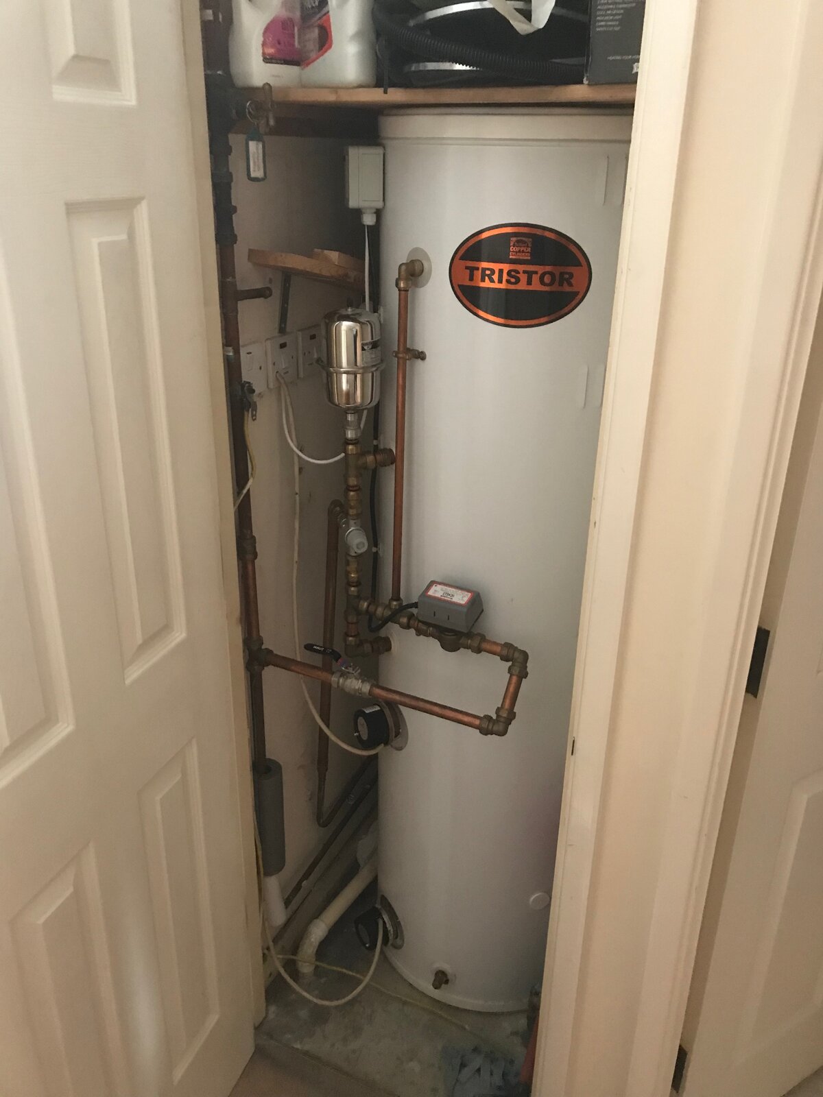

Post some photos please
Include the wiring, switches and timers, and the pipes.

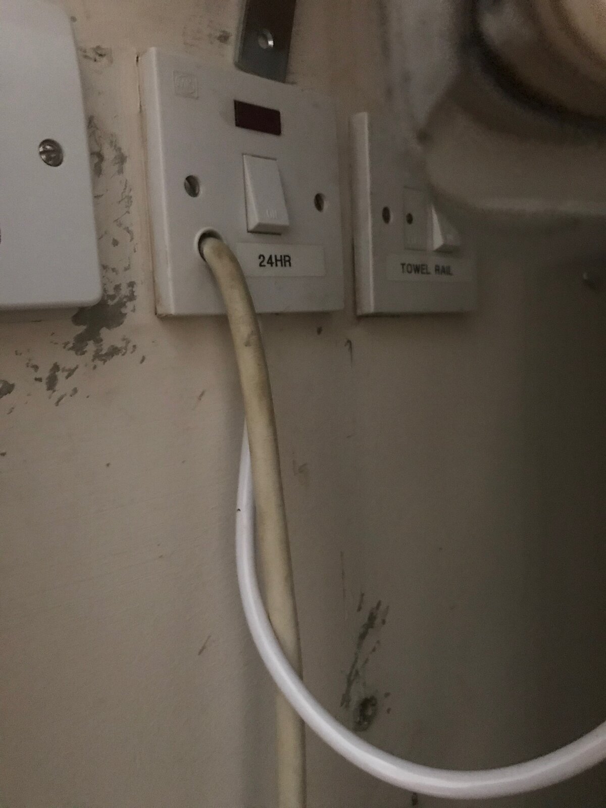

The bottom immersion is connected to Economy 7 - only operates between 11.30pm and 6.30am
The upper immersion is connected to the switch pictured above, which is live 24/7 - the booster as I understand it.
The lower immersion is connected to the switch pictured below

Well that's a nasty looking piece of plumbing- all those compression fittings give it a definite builder or DIY feel. ' Just moved in'- renting or bought?
Do you have a tape measure handy to give some dimensions-height and circumference would do. That must be a very tall door if the cylinder is higher that 5'3"... It does look on the small side (maybe 200 litres?) . Are there any header tanks in the loft? (Unlikely in a flat but worth an ask).
I may be wrong (am prepare to be shot down in flames here) but it appears that the hot water (or some of it at least) is running indirect via a centre coil, which would explain the thing not providing much hot water. I'm intrigued by what looks like a motorised valve (1st pic, grey box on the horizontal bit of 22mm) on what appears to be the cold feed.
If I'm correct about the way the thing has been plumbed it is a very inefficient way to provide hot water. If the mains water supply is up to it you'd do a lot better with a pressurised hot water cylinder running direct- that thing looks as if someone has chucked it in because they had it kicking around and it was cheaper than doing the job properly. You can use a coil in a cylinder to heat hot water indirect (@bernardgreen is the source of wisdom on that one) but the coil as I understand it should (a) be designed for quite a high energy transfer rate (b) be at the top of the cylinder (so as hot is drawn off through the coil the water in the top of the cylinder cools, drops to the bottom of the cylinder pushing the warmer water below up to the top so it can continue to heat the coil). That cylinder looks as if it was designed to be heated by the coil.

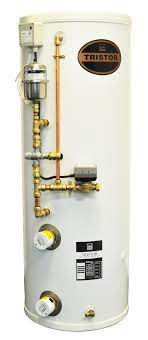

I think it comes with all those bits and pieces - please see pic attached:
I'm renting so can't look into changing the cylinder unfortunately - it's also only 3 years old I believe, so doubt the landlord will appreciate being asked to look into an alternative. There are no tanks in the loft etc. So if I understand it correctly, this is how it works:the water in the tank is heated to something like 70 deg - then that temperature is to be maintained (in my case by the immersion heaters) so that anytime hot water is demanded, cold water at mains pressure is passed through a coil within, which is heated by the surrounding 70 deg tank water which in turn then heats the mains water passing through the coil which is then supposed to be delivered to the tap at about 50 deg. ??? That's what all my hours of research suggests at least and maybe I'm wrong. Sounds very complicated!

Hi Nixstar, in the picture there is a grey knob in the middle of the pipework,it may be a blending valve. Thermal stores should be kept at about 70 deg which would scald so a blending valve is in place to inject some cold water into the hot as it leaves the cylinder on way to taps, its a safety feature.
Look on the front of the grey knob there may be a + or - with a directional arrow, usually anti clockwise for hotter water, clockwise for cooler, just check yours hasn't been set for cool which will be aprox 50 deg, max + should be 60 deg, if you cant turn the valve it may be siezed, then its a repair or replacement. Hope this helps.

A store has to be kept hot all the time, it is the only way it will work properly. Once the store is up to temp (up to 130mins for the 200l) then the immersion heaters will shut off but the minute you use hot water they will kick back in again to maintain the temp.
Do you have a single output meter that clicks to economy 7 overnight then the immersion heaters should be wired so the economy 7 powers the both to heat the whole cylinder on cheap rate overnight and then the bottom one is shut off and just the middle one is then the booster to keep it topped up when the temp drops when it's used during the day at peak rate. Or is it a dual meter with 2 outputs and the consumer unit is split to only certain things that run on economy 7 overnight? You need quite a comprehensive understanding on how your electrical system in set up.
The only real option, I would suggest, that will allow a semblance of control is to fit a mains power monitor, that way it allows an eye to be kept on real time costs, so at least the budget can be controlled accordingly.
Having another look at the pictures too, the overfill controls for that cylinder (that controls the 2 port valve etc) are powered from the switch marked 24hrs and they need a permanent power. I would hope that they are wired into the live side of the switch and not the switched load side.
