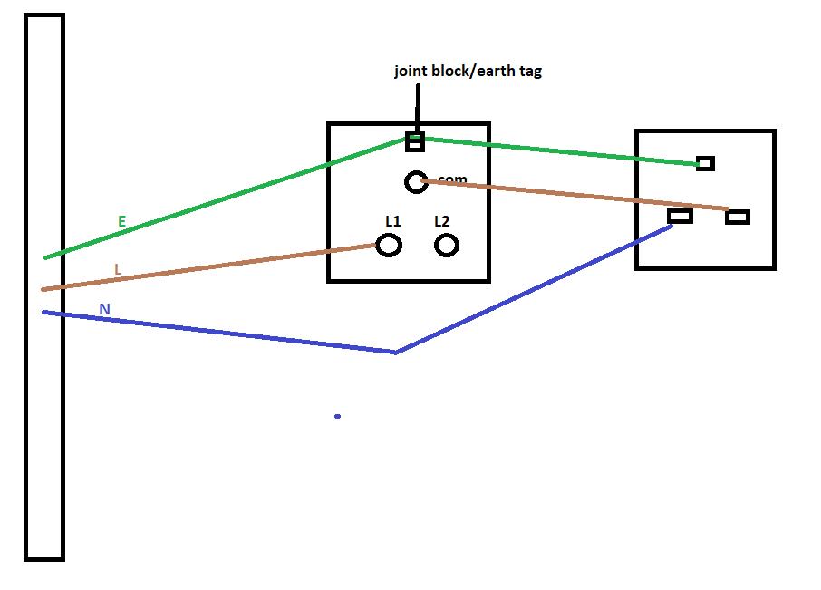

I have a B&Q Dial 2 way outdoor switch as per the picture.
I have 1 4ft batten led light in the garage, and I want the switch near the garage door.
There is a wire from the light to the switch, and another wire from a plug, into a double mains socket, also to the switch.
I have then 2 lives and 2 neutrals. What do I connect to what on switch.
I have tried live from plug to the com socket, and the live from the light to 1 way socket, then tied both neutrals together in a choc block.
Needless to say, the light doesn't light up.
Can someone give me an idiots guide on how to do this.
Not really understanding what you are trying to do here?
on/off switch which is a 2 way option but not being wired 2 way?
You wanting to do this?

Not sure there are two to connect - the orange flex looks like 2-core.
No there wasn't any earthwire in the orange cable and now was there an earthwire in the light cable. It is a white cable extended by the black one. Yes the black had an earth wire, but the white one from the light itself did not
