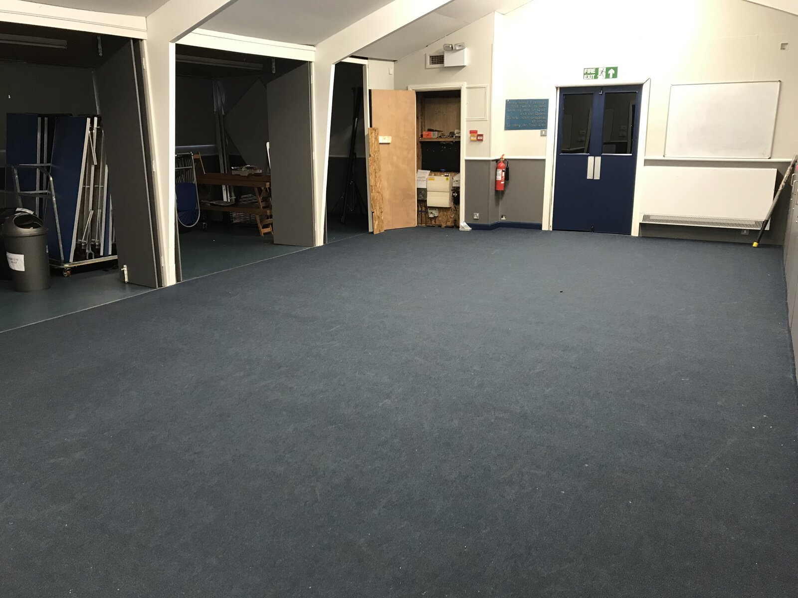

Now here’s the problem. There are only 2 or 3 mini traps to the floor void for fishing cables through etc. The vast majority of the building is plywood boarding nailed on top of the floor boards, and then carpet / Lino glued to the plywood. I’ll try my best to look under the floor with mirrors etc.

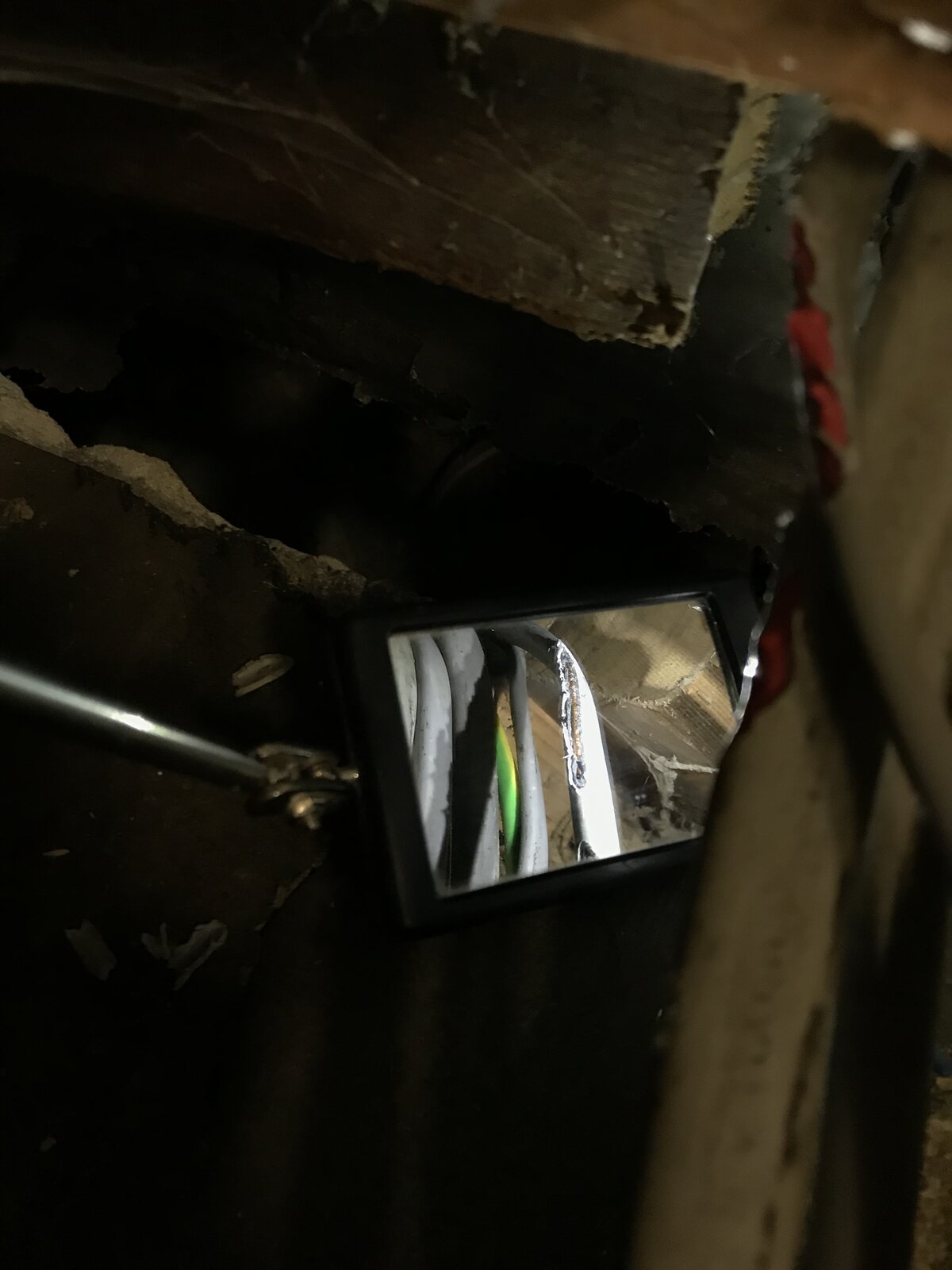

I’ve been to start a job today and upon lifting a piece of floor, I’ve found some gnawed cables.
I am on this job to install a new fire alarm system. I have some new cabling to run very near this location and for my own protection want to repair the cabling before I start work near it.
The job is in a scout and guide hut, so funds are limited as always.
Obviously replacing the cable would be the ideal situation but is not really practicable. I realise there may well be other damage elsewhere and I will be taking precautions to keep myself safe.
What would you do in this situation?

Here’s what I’m up against in regards to access below the floor
I’ve had a look around with the mirror today and I honestly can’t see any further damage as all the cables look to be running over the dwarf walls and are a bit more up and out the way.
I think this has been used as a route from the main hall in to the store room for the rodents which has had all the food removed and bait put down some time previously.
The bottom cable in the original picture has sustained more damage than the others. Perhaps because it’s on the neutral side?

The hut was built in the 50s, extended in the 60s and had a bit of a refurb around 2000. The electrical installation very much reflects the evolution of the building with things like only a single RCBO for the sockets, and unfortunately we are at the moment stuck with it! I was involved with the refurb of the toilets about 10 years ago which was all wired in steel tube and as far as I know has never had an issue.
Having spent a lot more time working on big commercial projects, and if I’m still involved in the next phase, surface steel trunking and tube will definitely be the preferred option.
