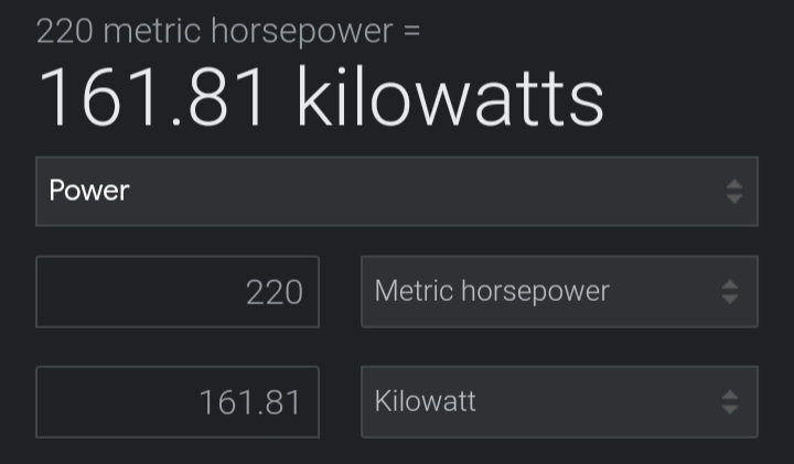

Metric and "international" horsepower are so close as to be used interchangeably. I think 1 "horsepower" is something like 1.013 "metric horsepower". You couldn't even power the sidelights with the difference.
In this case, 220 "British (imperial - not bhp) horsepower" would equal 164kW - a difference of 2.2kW from Ps.
Them would be some sidelights! ;)

How many kW is a horse?
Haw many kilowatts in a horsepower? 1 horsepower is equal to 0.74569987 kilowatts, which is the conversion factor from horsepowers to kilowatts. Go ahead and convert your own value of hp to kW in the converter below. For other conversions in power, use the power conversion tool.
It seems I was wrong and got the conversion wrong way around.
