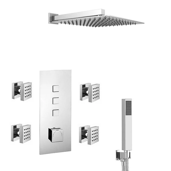

So a thermostat shower from stored water is very different to the same unit running from an instant gas water heater. Showers with body jets 1727358092033.png will not in the main work on an instant gas water heater, this is only possible with stored hot water. As to how much water they use I would not like to pay that much.
