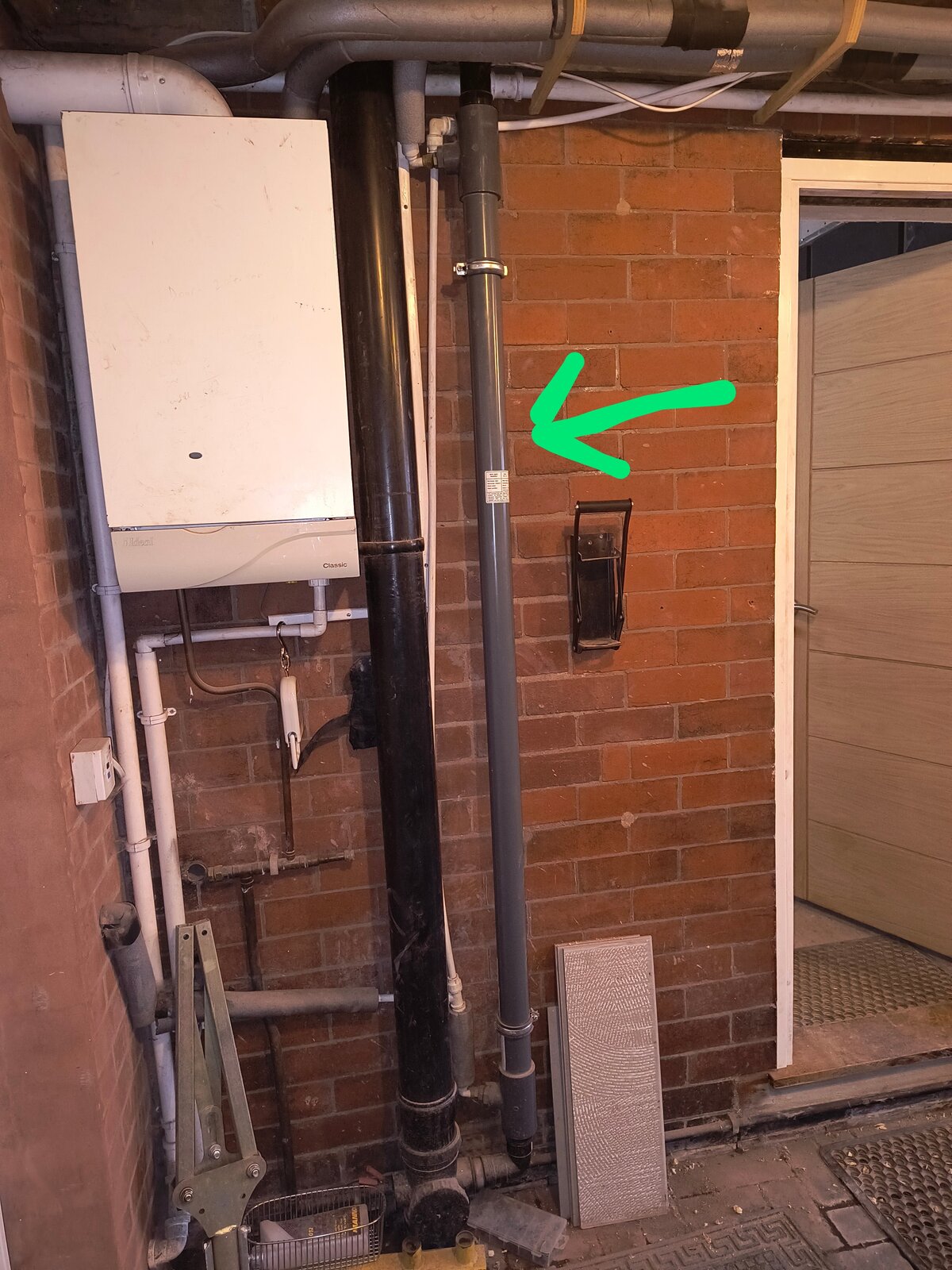

Looks like a "heat exchanger" that warms in the incoming water with the outgoing waste water.
Yes. As the hot shower water goes down the drain the heat is transferred to the cold water going up to the shower.

I doubt you'd ever recover the installation and manucturing energy needed to install heat recovery from a drain. The waste from a shower isn't very warm, as it gets blown through the air, just like a cooling tower in fact.
Is that just a pipe within a pipe, ergo the plastic cold mains pipe just runs up inside the PVC waste pipe or some kind of special PVC heat recovery/exchanger system that is purpose made? The shower water may warm up the incoming cold mains a little but surely it can't be very efficient, of course any heat gain is a bonus, so fair enough.
You would surely use copper for this job.
No offence to @cdbe but it looks like a commercial product rather than something DIYed. Although it would be pretty straightforward to make.
Would be interesting to see the delta-T between in and out cold water on that thing.
I looked at making one of these, from copper, maybe a decade ago, I decided it was just not worth the effort + cost involved.
I considered it more likely to work, where a shower was over a bath, during the draining of the bath/after a bath, but then there would be little advantage to be gained, in prewarming the cold.
