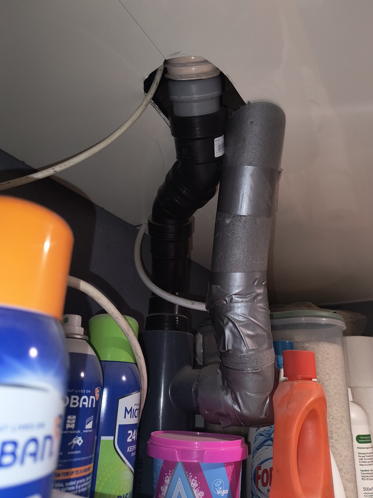

It's a commercial product made by a company called Recoup, it's a copper "hex" inside. Unfortunately they were £600 at the time but I bought them off eBay for £80 each.
Regarding my "constant hot water" if my hot water is timed on, my 145l cylinder is up to temperature, my shower is 8l/min, my boiler is 15kw and my recoup is pre heating the cold into the shower I recon I could shower for hours without running out.
The only, not very scientific thing, I can say about the recoup is that my ensuite whb cold tap is fed from the shower cold feed and if I step out of the shower and run the tap then fairly warm water comes out.

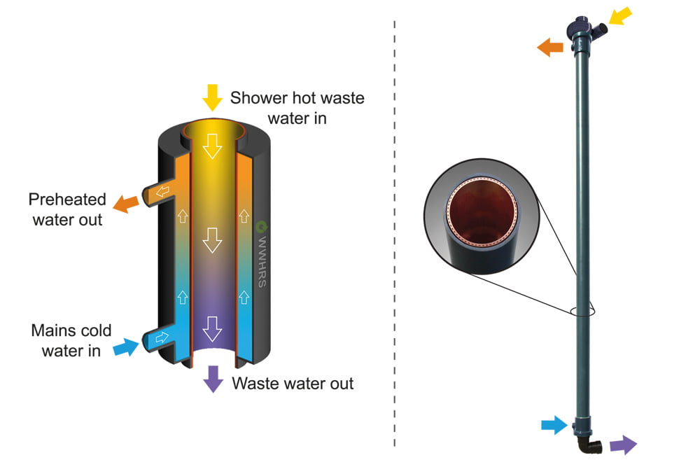

The idea of that one, seems to be a sort of centrifuge. The incoming cold, is caused to swirl its way along the warm drain pipe in the centre. It would take a long time, for it to recover £600 worth of heat!

If all that was set up correctly then I guess it could be self sustaining at certain times of the year. As suggested it would be interesting to see the delta's on the mains, compare to the waste temp delta's just to see how efficient that recovery system was. They claim 50% efficiency on system B @11L/min @ 40Deg.

It is, they are a pain to fit because you're supposed to used all the bends supplied for optimum performance. That one's in the garage, the other one is in the utility under the ensuite.
I doubt you'd ever recover the installation and manucturing energy needed to install heat recovery from a drain. The waste from a shower isn't very warm, as it gets blown through the air, just like a cooling tower in fact.
I think you're probably right to be sceptical about the ROI. Hard to find much obviously independent information on ROI for these systems. Only a handful of manufacturers.
