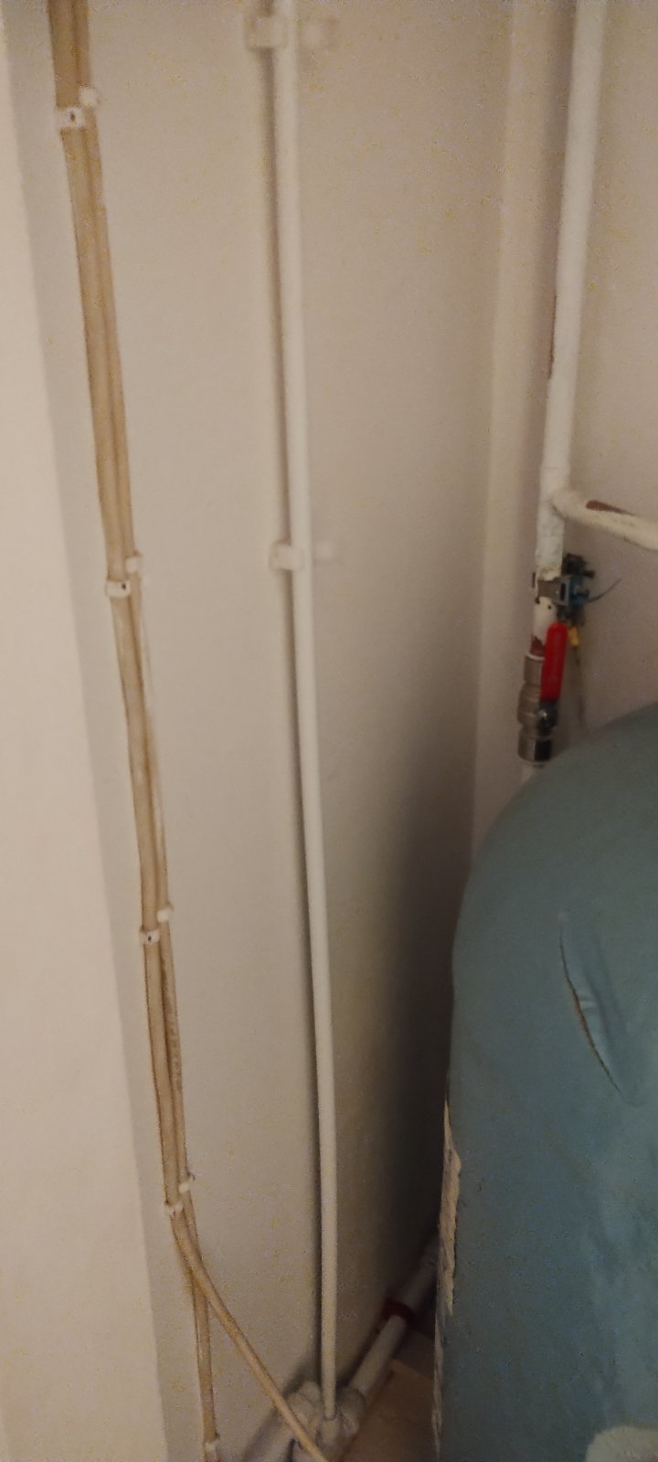

There is only 120mm between the airing cupboard wall and the cylinder. I would like to add 1 or 2 more fixings but cannot get a drill in there or swing a hammer. Is there any way to do that?
