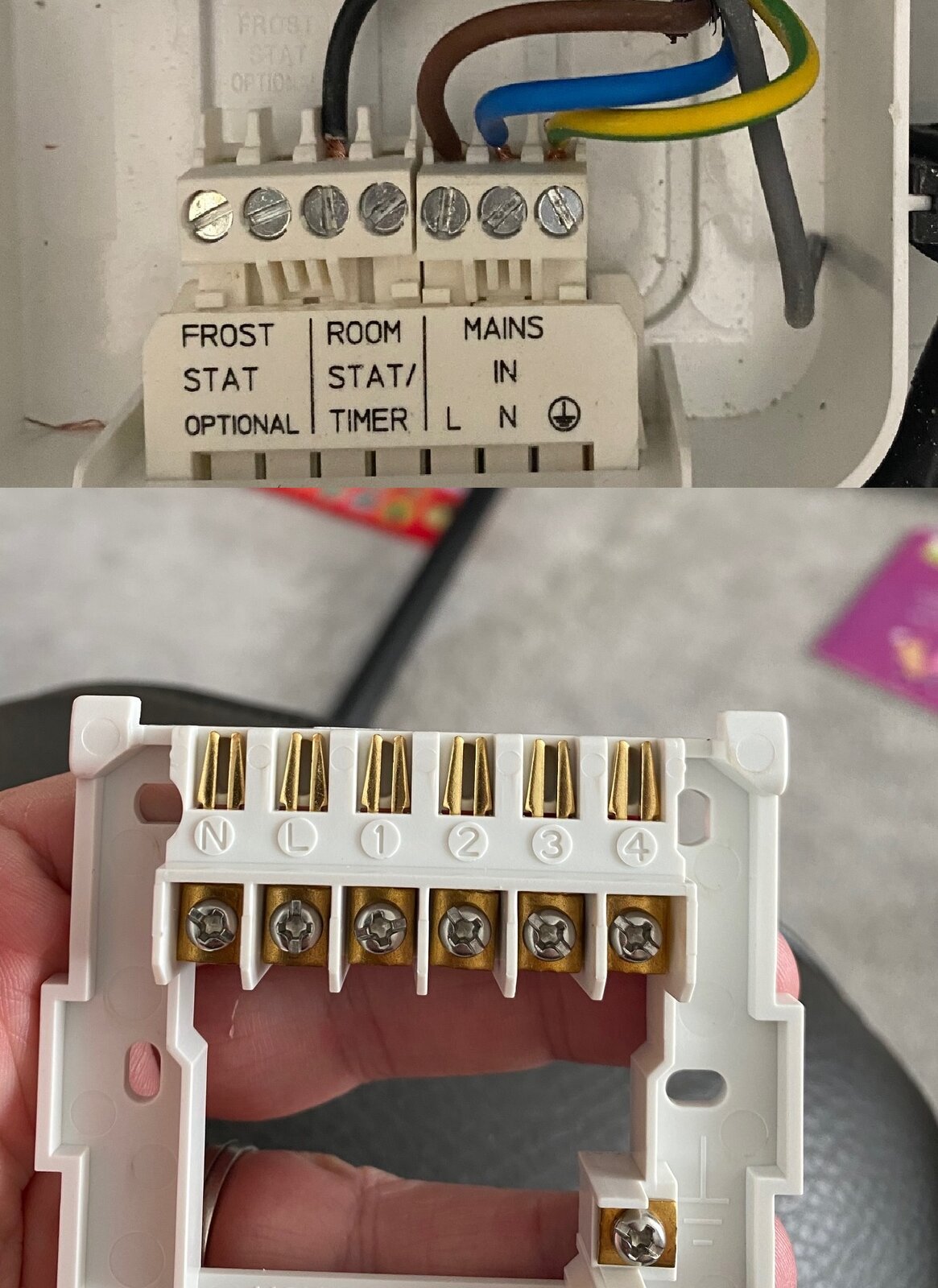

I'm wiring a Hive to a Logic Combi ESP1 35, the existing thermostat is wired to an undesirable location for the transmitter for the Hive so I plan to remove and blank it off, and then unwire the thermostat at the boiler end and wire in the Hive thermostat transmitter local to the boiler. I've attached a photo of where the old thermostat is wired in to (I assume) split with a photo of the Hive transmitter connectors.
Is anyone able to 'connect the dots' for the wiring, I'm just trying to work it out myself but trust that there is some people here with a lot more experience than me :-) Thank you.
You need to connect the two "room stat" terminals at the boiler, make sure they are volt free connections.
I think they go to terminal 1&3 in Hive, can't remember, it tells you on receiver, common to NO
