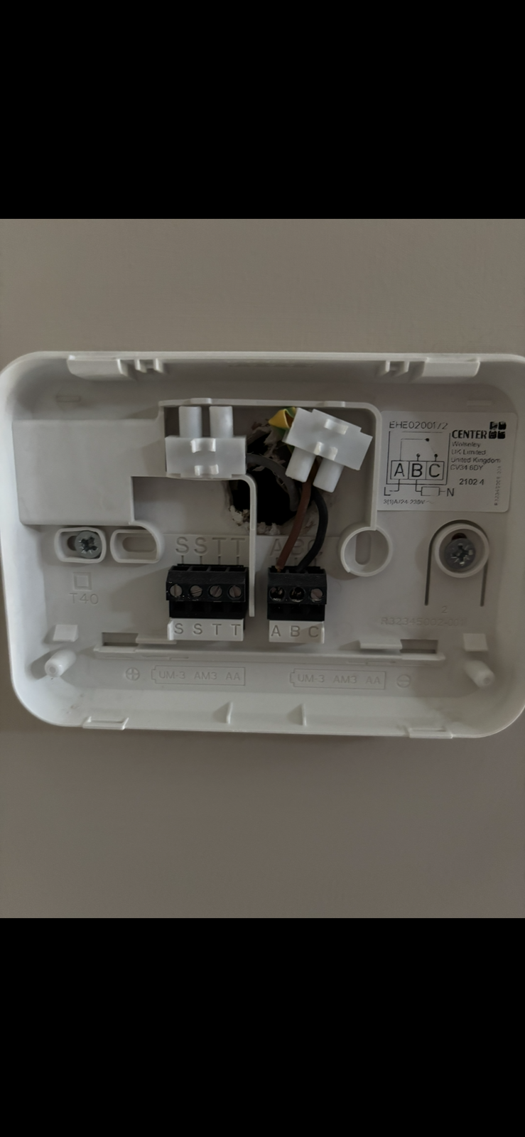

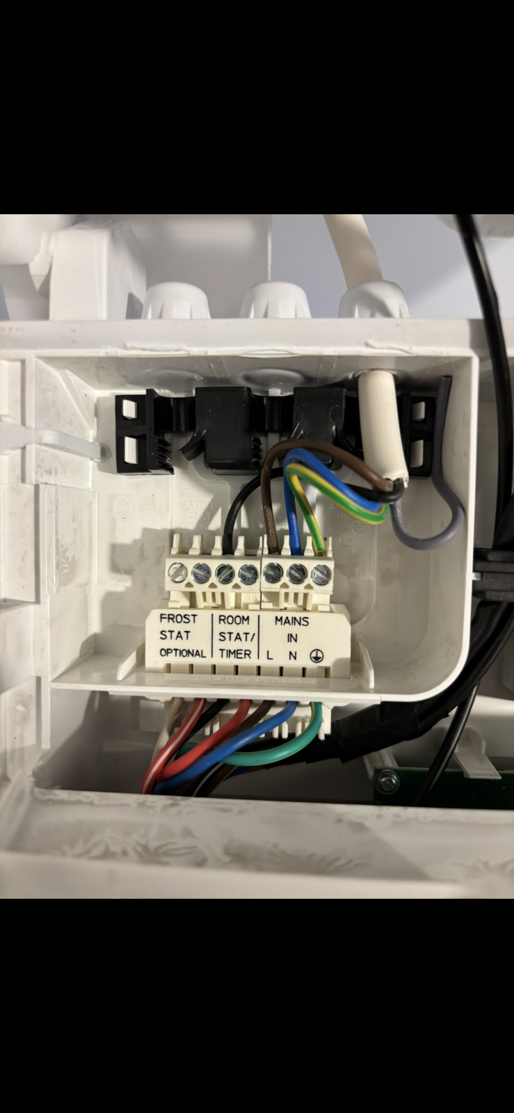

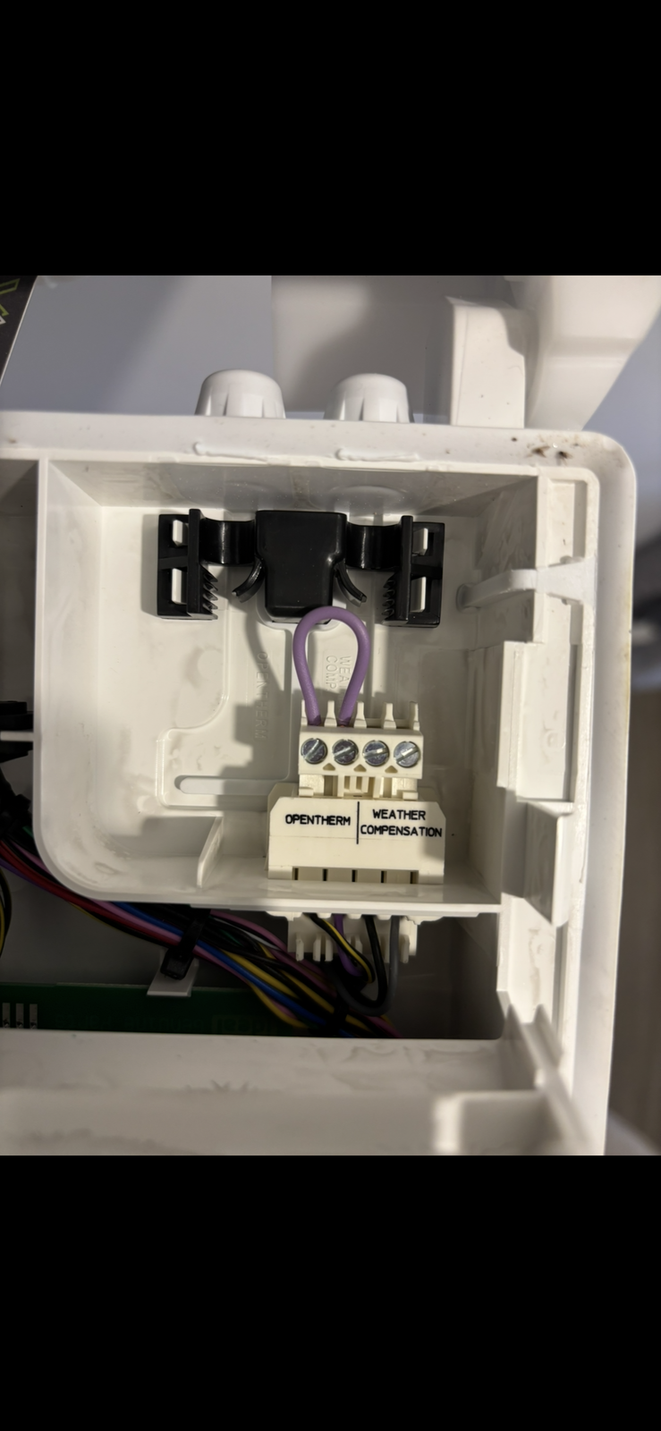

I’m thinking of installing a hive or nest but just after a bit of guidance before I go for it myself.
I’m unsure of how to wire it up, Iv attached a photo of the current thermostat and the wiring and also the boiler and the wiring setup,
The boiler is logic combi ESP1 30.
Kind Regards
Andy

First thing to note is that you shouldn't be taking the front cover off your boiler unless you're Gas Safe Registered.
Nest are about to exit the UK market so I wouldn't go with those. Go for EPH CP4i or t the OpenTherm version of Hive
As @muggles says, you have option of using OpenTherm, the new Hive, and Drayton Wiser have OpenTherm but not all Hive models, Tado the same, some have OpenTherm, but not all, I think EvoHome also has OpenTherm.
Assess to terminals should be permitted, as electricians should check when doing an EICR, but some boilers it seems to do put the terminals inside the sealed part of the boiler, and often no signs to show what needs gas safe, and what an electrician can access. As an electrician, I was taught how to use flameproof fittings, but that did not make me gas safe. Could work on a gas expiration ship, (which I did) but not on my own central heating, seemed a bit off to me.

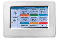

Nest for the USA market do sensors so you can monitor multi rooms, but not for the British version, will not even link to TRV heads, so a non starter. Kasa the hub and thermostat are one unit, which needs hard wiring, Energenie was the same, so neither would work for me. Hive has changed, and I have not kept up with what it can now do, early versions did not have OpenTherm and would not take a demand for heat once the wall thermostat was over 22°C, EvoHome was one of the first and you don't need a smart phone to make it work, EVO-home1.jpgit has a central control panel for all rooms. The Wiser TRV heads are claimed to work out when they need to turn on to get room warm by a set time, I have as yet not done a winter with Wiser, so can't say how well they work, but to date seems good. Nest Gen 3 was in the main a flop, it needs a power supply to the thermostat, be it from the heat link, or USB and to get an UPS supply to the USB seemed too much like hard work, so used existing wiring to power from the heat link, which in turn like the boiler has battery back-up but it fixed the location to the hall. And the hall cools too slowly. I still use it to get DHW if required, but the Wiser wall thermostat is battery powered, so will work in a power cut.
