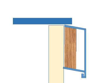

So I need to do something. The options I have come up with are:

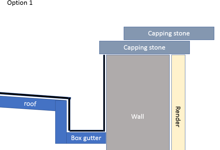

1) A second layer of coping stones, corbelled off the existing ones and protruding a further say 15cm (the stones are 400mm wide).
2) A retrofitted fascia board.

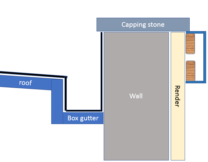

For 2 - not really sure how to do this. The image below shows how I might attach lengths of U-shaped metal that I could get made up. They come in 3m lengths so I would need 4, and they would need to overlap. I envisage fitting them right up underneath the existing capping stones. I am thinking that I could fix two battens to the wall - one to take the top lip and one to take the bottom lip. I would then slot the metal "fascia" over the battens and fix with roofing screws from top and bottom. I'd silicone between the capping stone and the metal, and probably the render too. I would have to find a way to put an end cap on as well.
Does this sound sensible? I am a bit concerned that there is no drip on the U-shape, although I could try to get one added by the company that would do the manufacturing.
And am I missing something obvious? Are there ready-made systems out there that I am overlooking?
Any help would be much appreciated.

Thanks. I'll be doing this myself, so thought it would be easier to add a layer of coping stones, in In particular as they rendered up to the bottom of the existing stones and im not sure that I could remove them without damaging the render. It would also be half the cost of doing larger stones. The existing stones have drips on both edges. And i would get a bigger overhang by adding new rather than replacing existing.

I'm not convinced your facia would help much at all. I would also be wary of the over hanging coping stones - too much risk of someone grabbing hold and pulling one down on their heads.
Doesn't the location of the stains and the crack, suggest the problem is more at the joints between your coping stones, rather than the depth of overhang of the stones? Might some sort of colour matched outdoor mastic help prevent water passing between those joints?
If not, might some upside down L profile metal or plastic, lip sat on top of the coping stones and sealed to them form a much more effective drip strip?
Like the above, but using those roof tile edges where a roof meets a vertical wall?
Might Flashband work, stuck over the coping stone joints?
You need wider copings with at least a 50mm projection and a suitable drip properly laid and jointed. Nothing elaborate, just that.
Option 1 with another layer of coping stones would probably work but will look odd.
Option 2 (your facia) won't give you any kind of drip cill so you'll still have water running down the wall. You'll struggle to stop water getting down the back of it.
I would replace the coping stones with larger ones and do the job properly.

As regards drip cill - i could make the metal form into anything I wanted really so could incorporate a drip cill. I think it would be easy, cheap and look good but I am hearing that people disagree and think it would be ineffective. Is that just beause of the basic design I have shown; or because in principle it's just not a very good way to do this? The pic above was just an example of what I had in mind but I could well do it in another design eg:

If you have access to press brakes etc and can make whatever profile you want, i would recommend making a steel capping that covers the existing copping stones in their entirety and gives you a suitably large drill sill away from the wall. Why put something beneath it when you could go over the top and make it look like it was always intended to be there.

Metal covering the coping stones completely would be the more certain fix, guess it would have to be alloy or stainless steel - I hadn't realised you had access to a metal folder.

I dont have access to a metal folder myself ( or at least not one large enough) but a company I've used before that sells metal roofing materials can do bespoke shapes at very modest prices, colour matched to the bi-folds. The benefit of going over rather than under the existing stones is presumably elimination of the risk of water getting behind the fascia?

I would design a profile that hooks over the coping stones where it would be visible from bedroom and is fixed into the building wall on the side that you're going to change at a later date. That way you could remove it as and when you change the wall on the non bedroom side.
