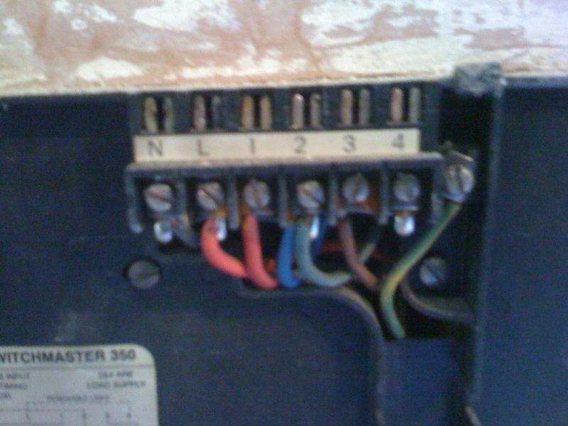

Hi, can anyone tell me how I can turn on my IDEAL E-Type RS - 35N boiler on manually as the SM350 doesnt seem to be switching it on?
i see!
you can bypass the clock by linking the supply in (usually marked L) and the H/W or C/H on. usually HW on is 3. CH on is 4.
if the boiler then fires up just replace the clock with a new one
Ive attached a picture of the backplate.
Is it just a case of touching the wire in L into one of the other terminals?
If it fires up how do i switc
h it off?

with a short piece of wire any size between 0.75 & 1.5 make a link wire
link L and 3 together - it should now give you hot water
then remove link
link L & 4 together - it should now give you c/h
if both of these set ups get each circuit running then remove the link and get a new timeclock a drayton 522 or horstmann H27 would be suitable if the switchmaster isn't available
they will be the same backplate
