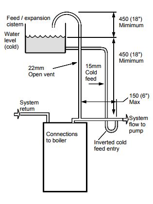

Hi can anyone tell me where the pressure gauge is on this model please so I can check pressure had front off boiler and it is nowhere to be seen any help please so I can get it re pressurised thanks..
It doesn't have a gauge, it's not that sort of boiler. It's an 'open vented' boiler which will be automatically topped up from a feed and expansion tank (usually in the loft) so doesn't need to be re-pressurised manually. Here's a diagram from the ff250 manual.
