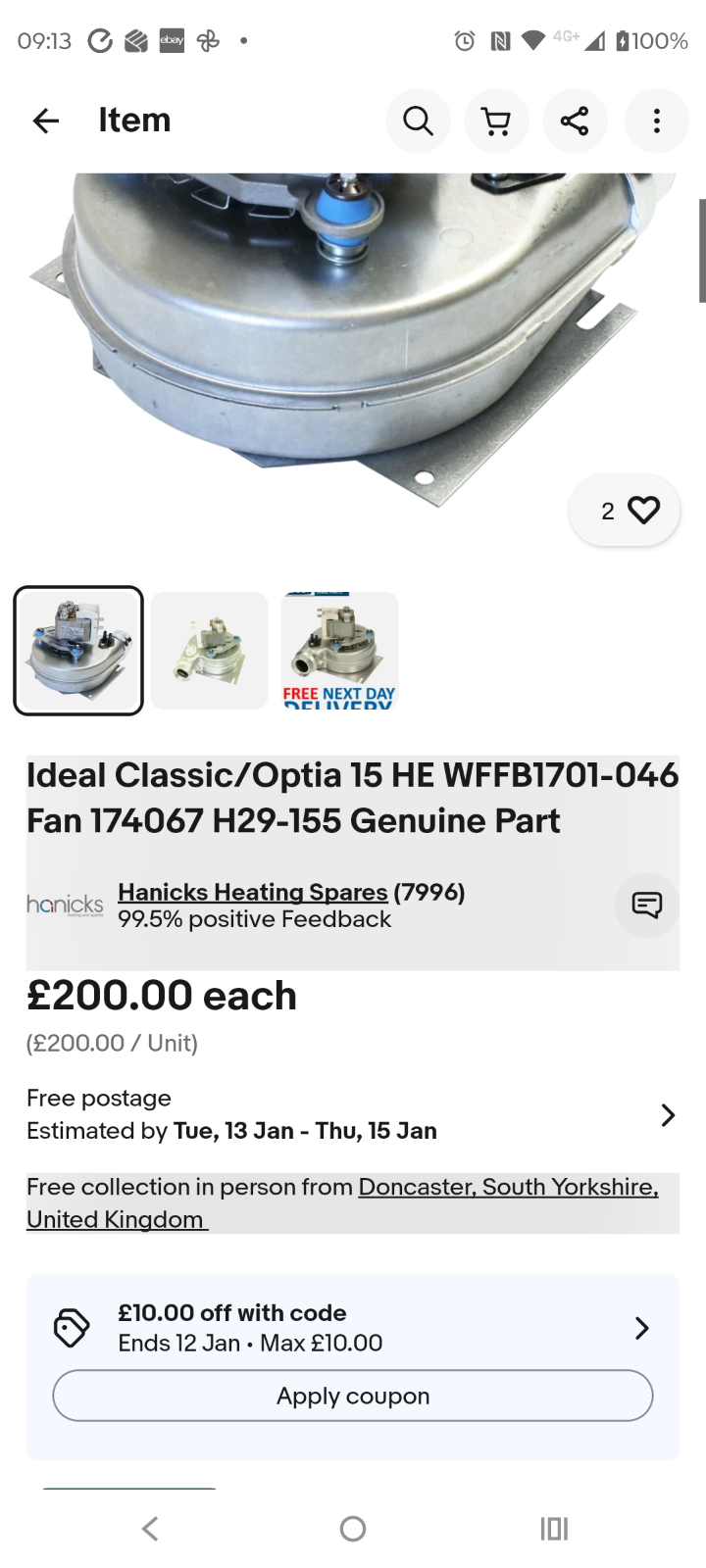

You can get refurbished PCBs on eBay for around £50 (it's a 25E).

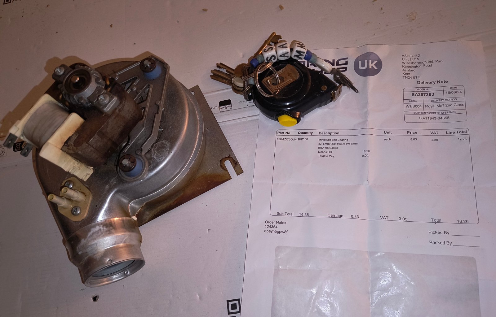

You can also buy refurbished fans for £50 but they're rubbish (one of the companies kept fitting the motor in in the wrong orientation - it's different to other ideal fans) and the other must have used crap bearings as it failed after 13 months.
I would buy this:
In fact, I would have, had I not found out how easy it is to replace the bearings (which is what fails) myself.

By coincidence one of mine packed up last week. I think it's a used one I picked up off eBay for a tenner as a spare and had been in for about a year. Fortunately I had replaced the bearings in the original one and had it ready to go. I'll check the motor and replace the bearings on this one in readiness - the bearings were the best I could find but I don't know how long they'll last.
Anyway, I hope you get it sorted, other that the fan (which sits on top of the heat exchanger where it's a bit hot) they're good and fairly efficient boilers.
