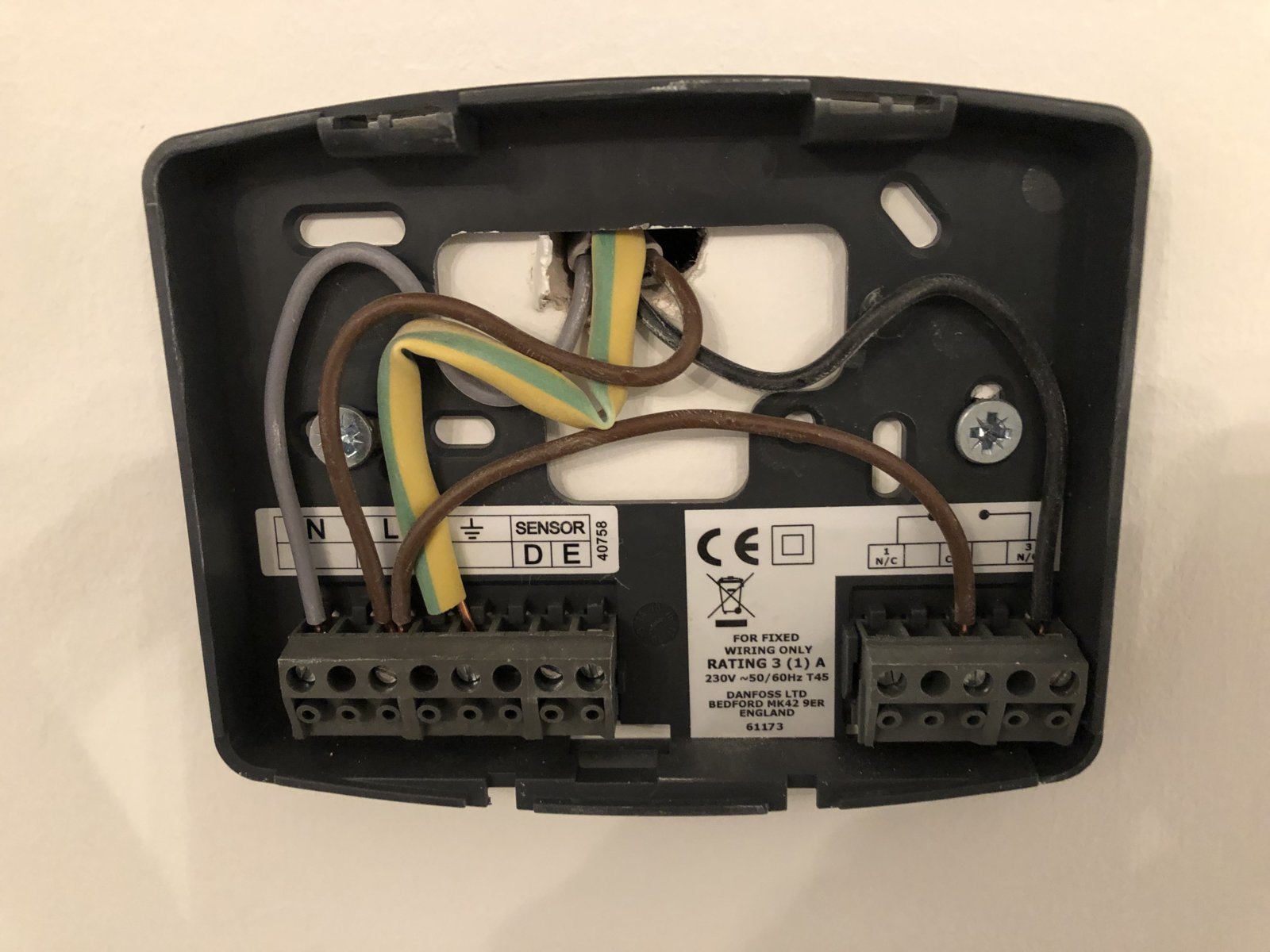

I have a new build house with an Ideal Logic Combi ESP1 35, and two heating zones. There are two Danfoss Tp5000 wired thermostats, one controls the living room heating and the other the rest of the house's heating.
Both stats are wired exactly the same (they are back to back on the wall between the living room and the hall), as below:

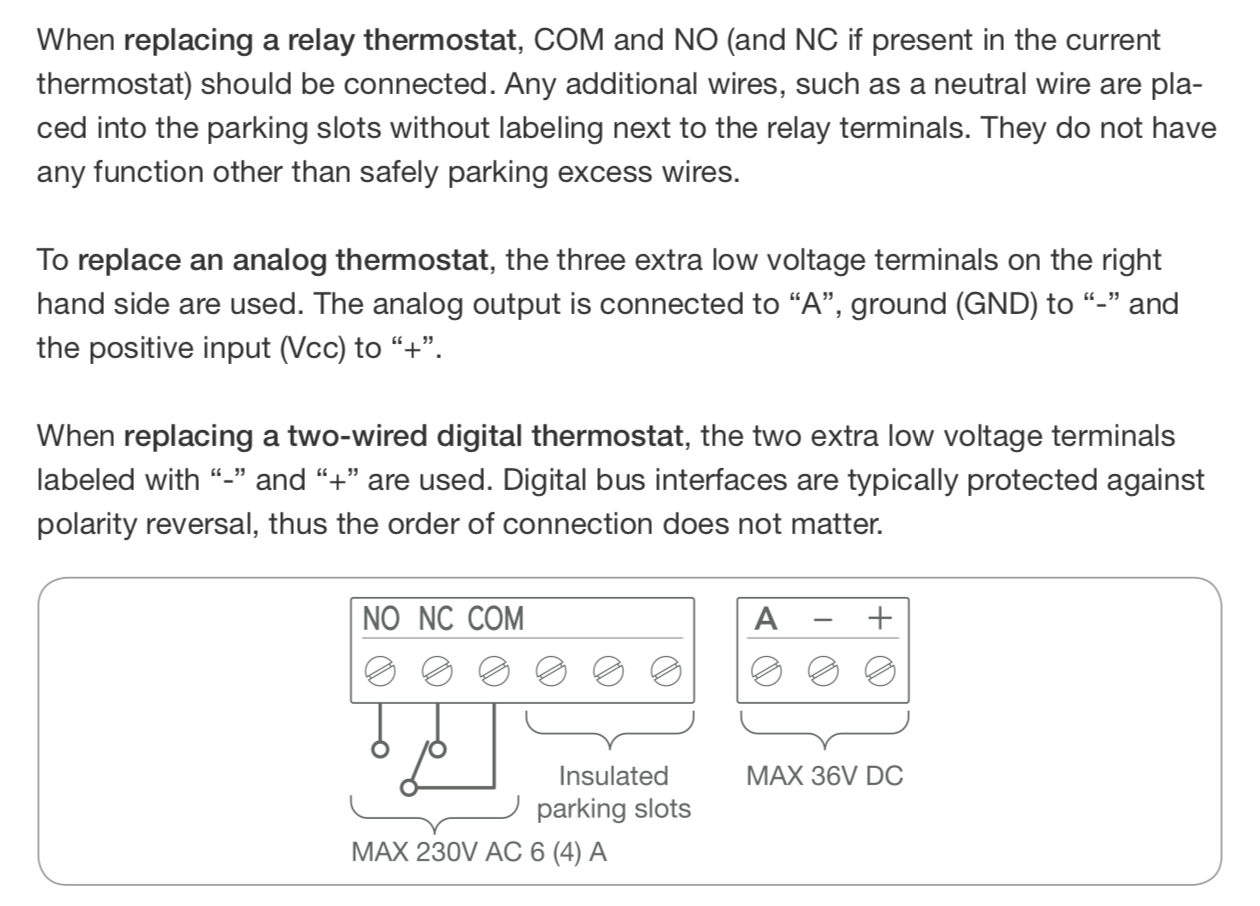

I want to change the two Danfoss for two Tado thermostats. Could someone give me a guide to where to put what please? I have found the following info:

Hmmm looking at it a bit more, do I:
1 throw away the link
2 park the grey neutral and earth into the insulated slots
3 put the black in the normally open
4 put the brown 230v live into the Com
Hi all,
No help from this forum, but in case it helps anyone else, Tado have responded to me and confirmed that the above guess of mine is in fact correct.
