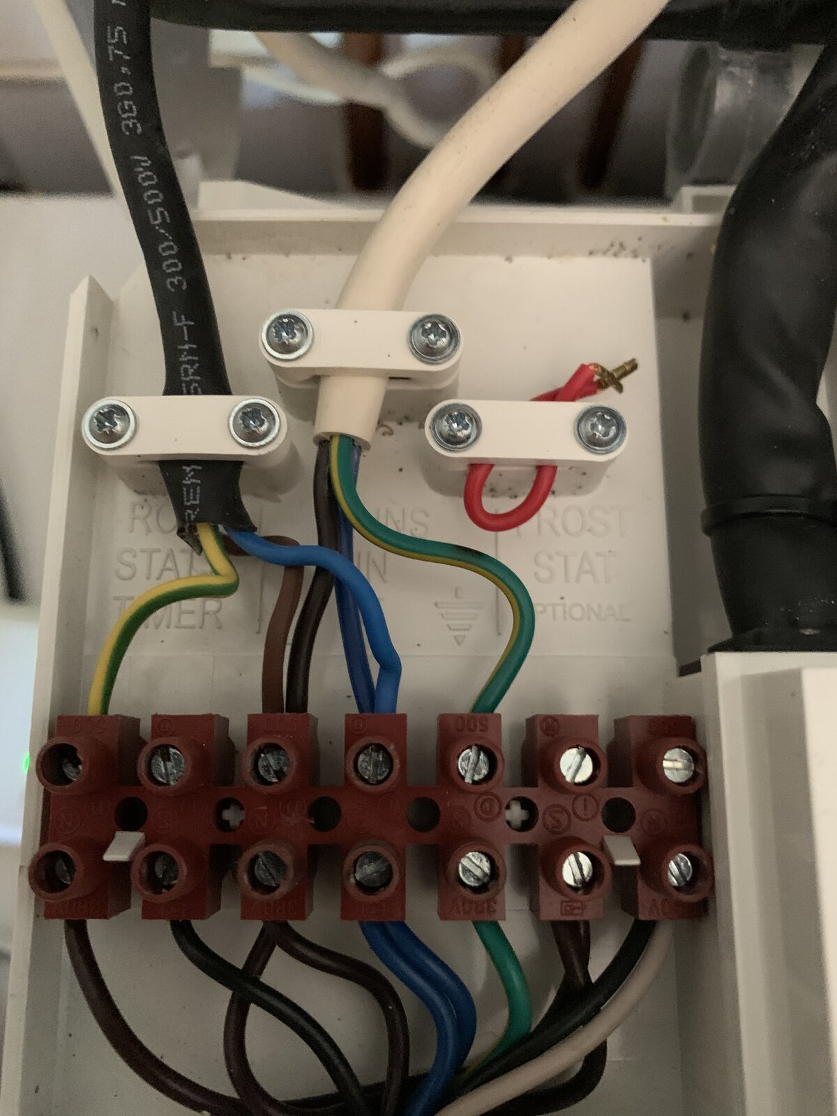

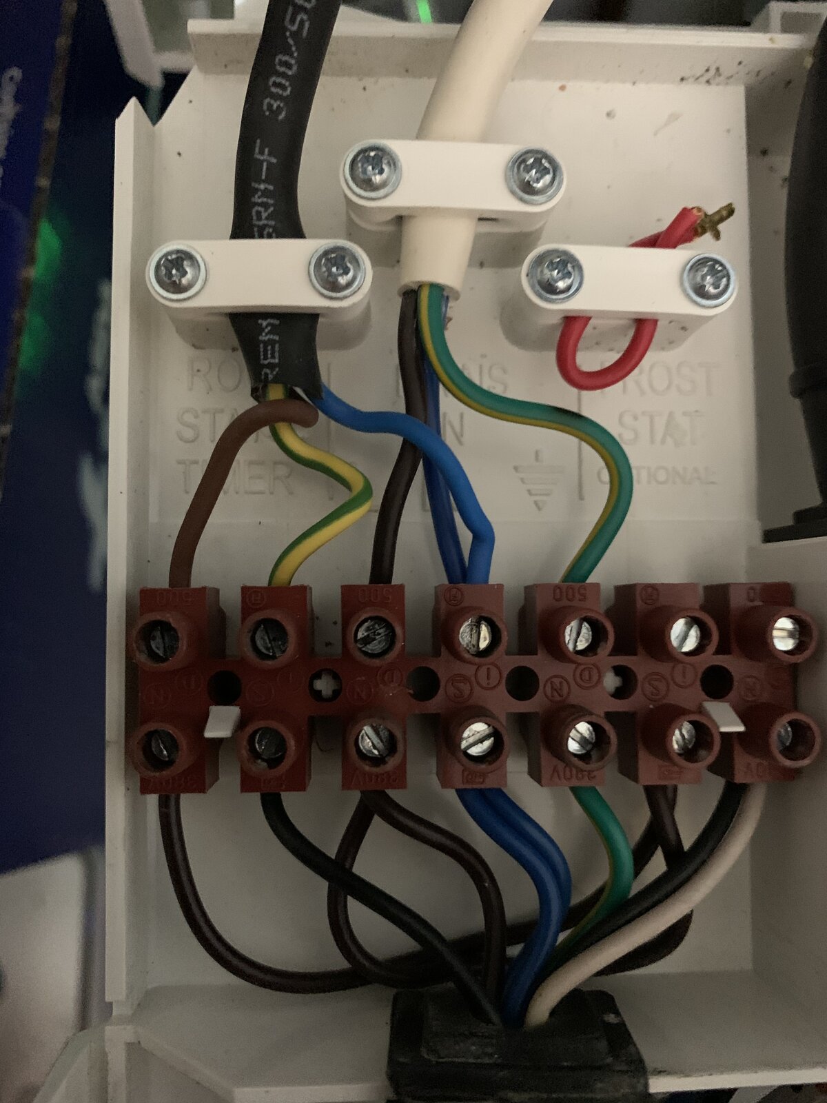

Hi

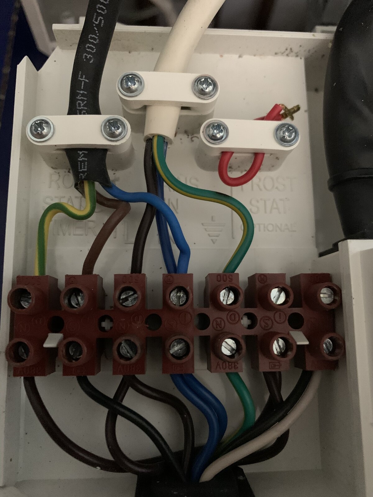

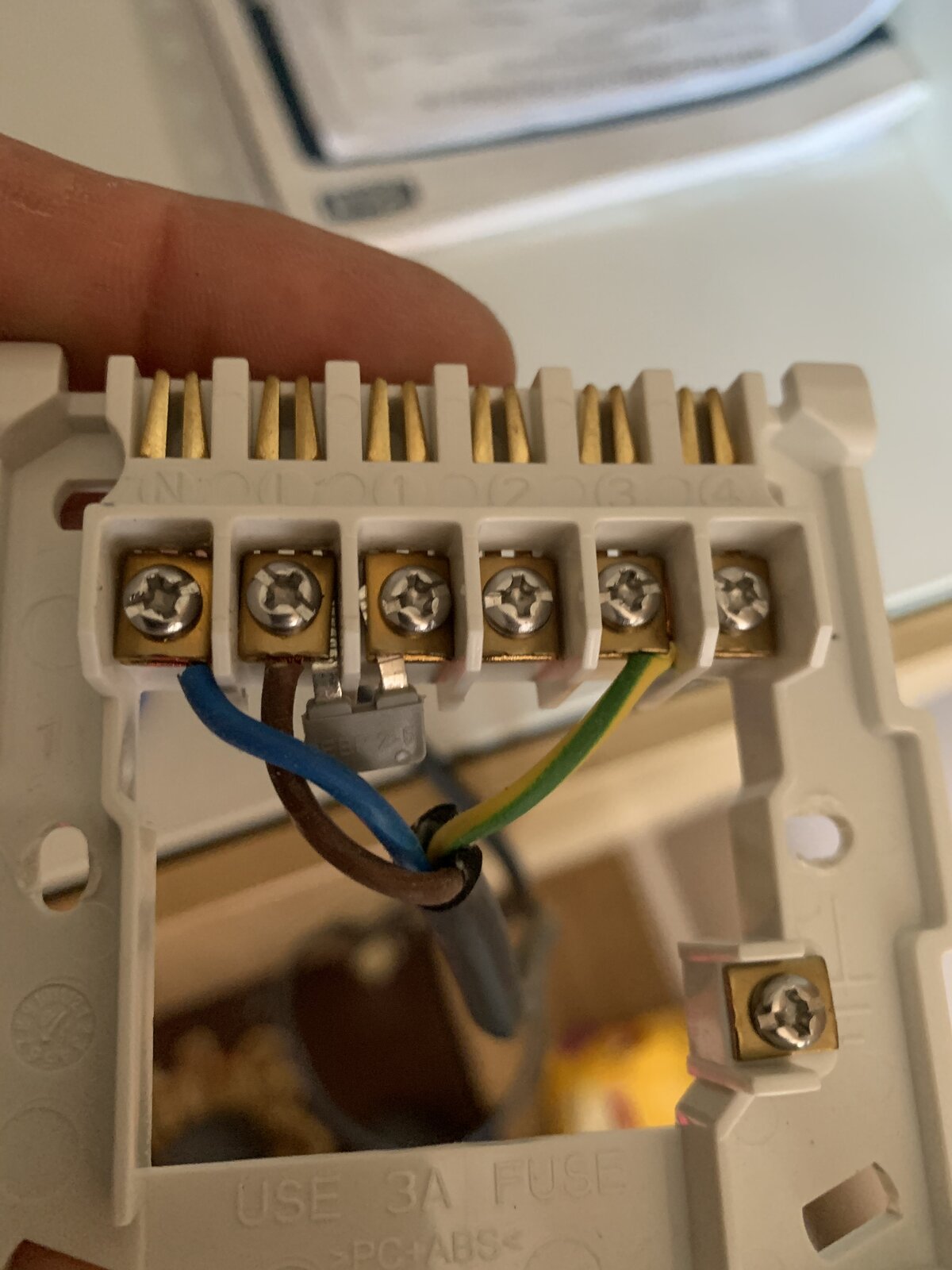

Having trawled every post and site I can, I’ve reached a point where I sheepishly need to raise my hand and admit defeat.

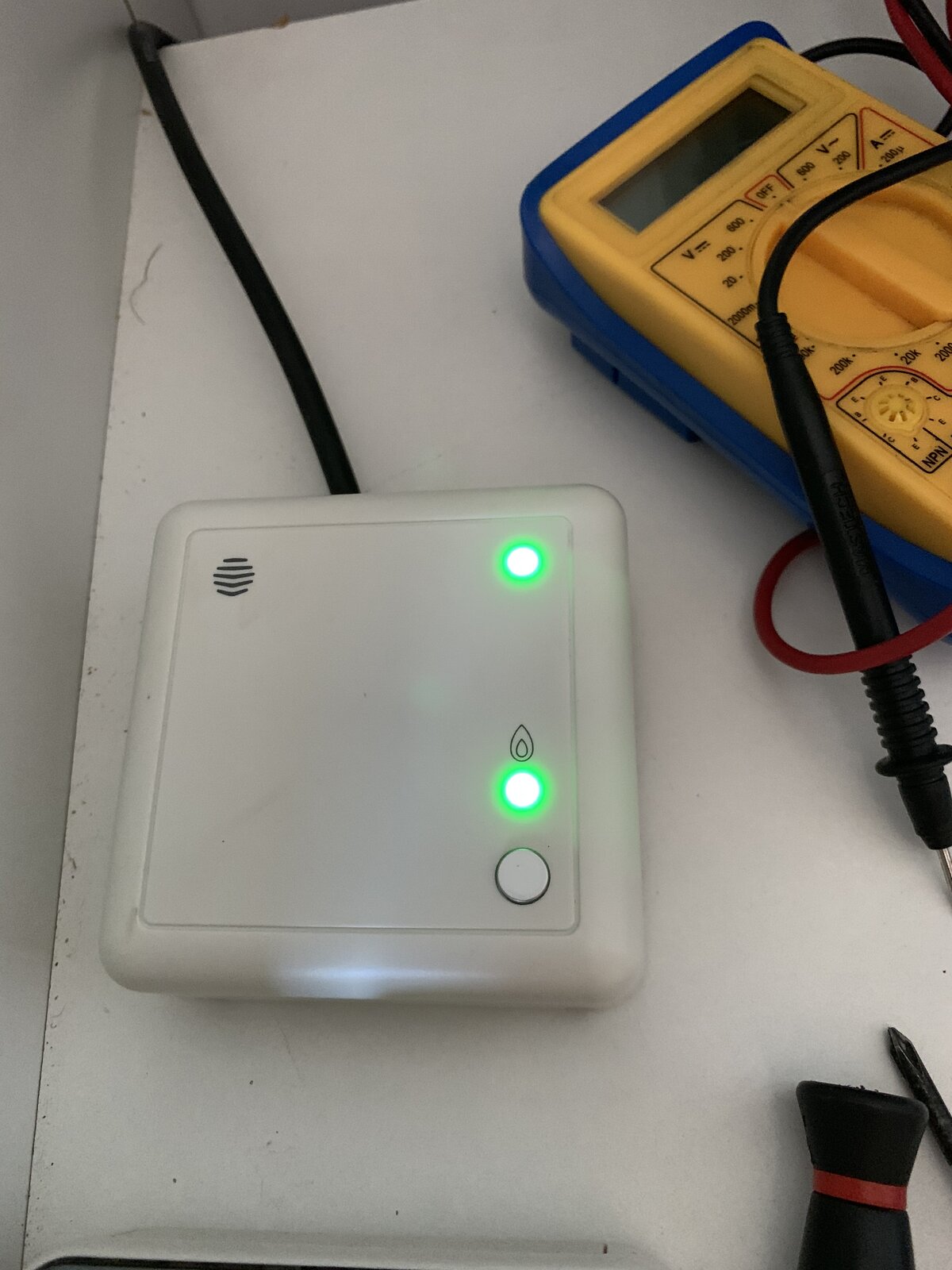

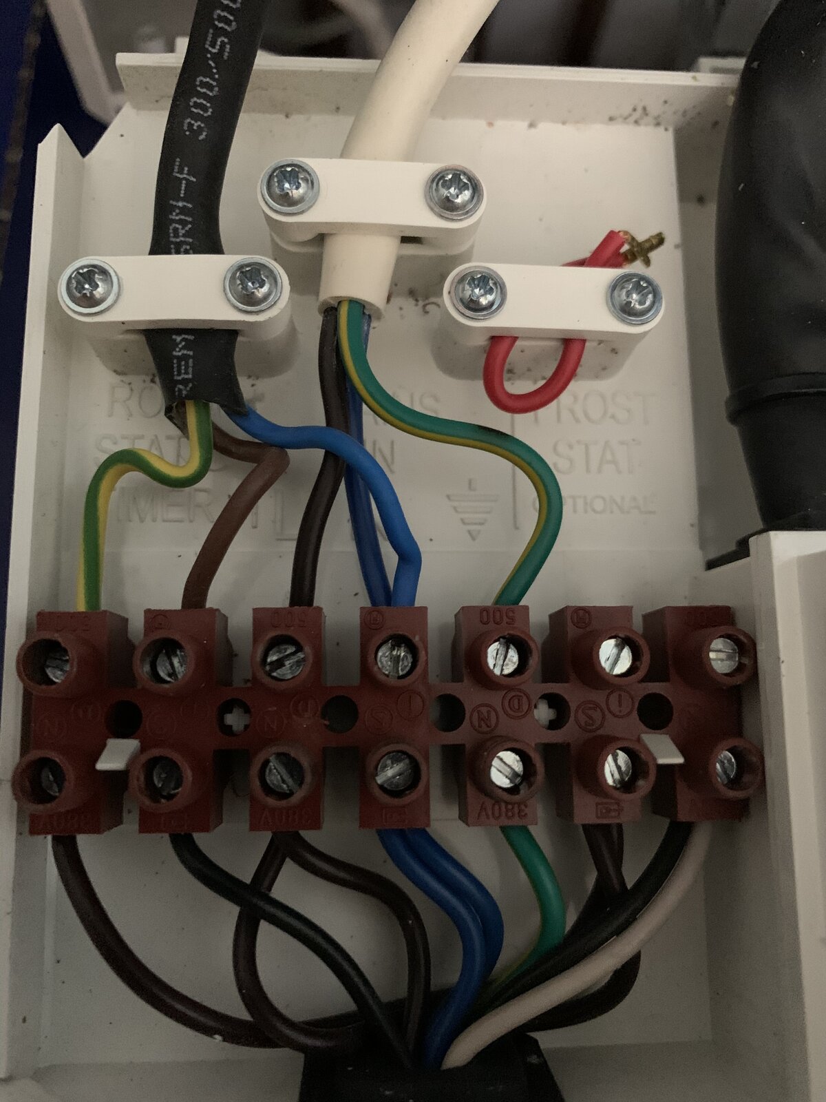

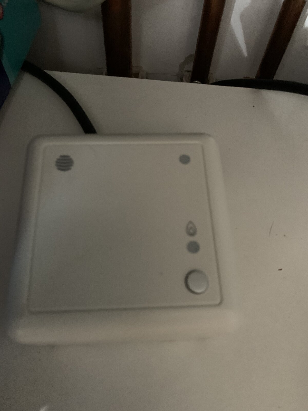

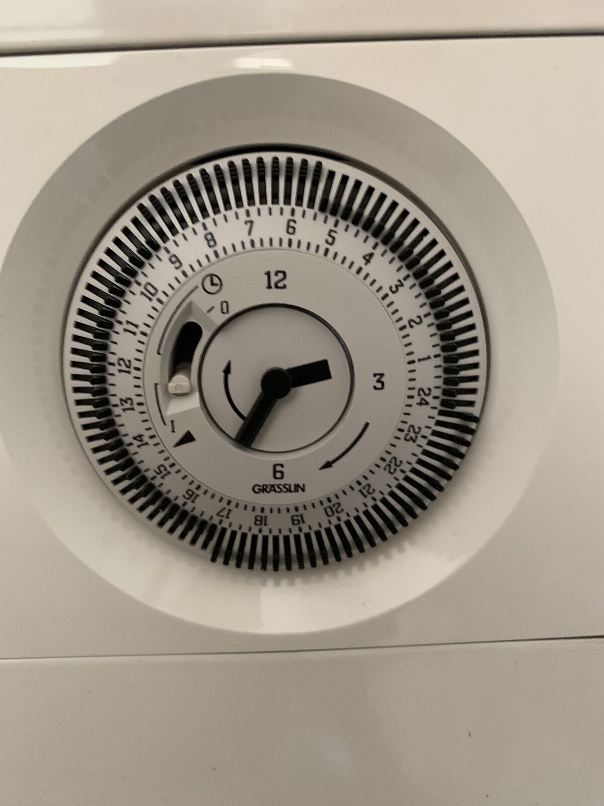

Help? I’ve installed hive following all the guides I can and have had successfully installed the unit and it responds to the thermostat with both the power light being on and (when the temperature setting calls for it) the heat/flame light comes on (it’s a single Chanel unit btw). This light also comes on if you press the silver button. Sadly that’s as good as it gets. The boiler doesn’t turn on despite the internal timer on the boiler being set to permanently on (to avoid it overriding the hive command to fire up) and the hive unit wired up as per photos attached (forgive the improper use of the earth wire- am replacing this test cable with a 4 wire cable once I get this working). What have I missed?

Move the Hive live from the boiler supply to the tye one circled in the pic
That’s how I wire them on logics

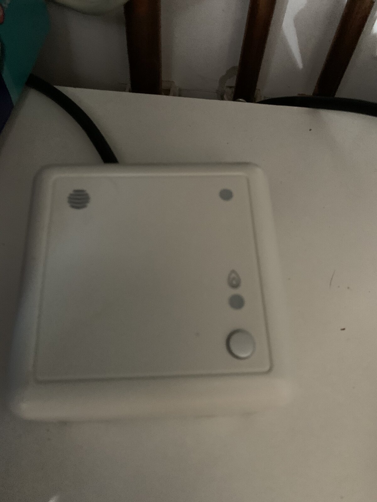

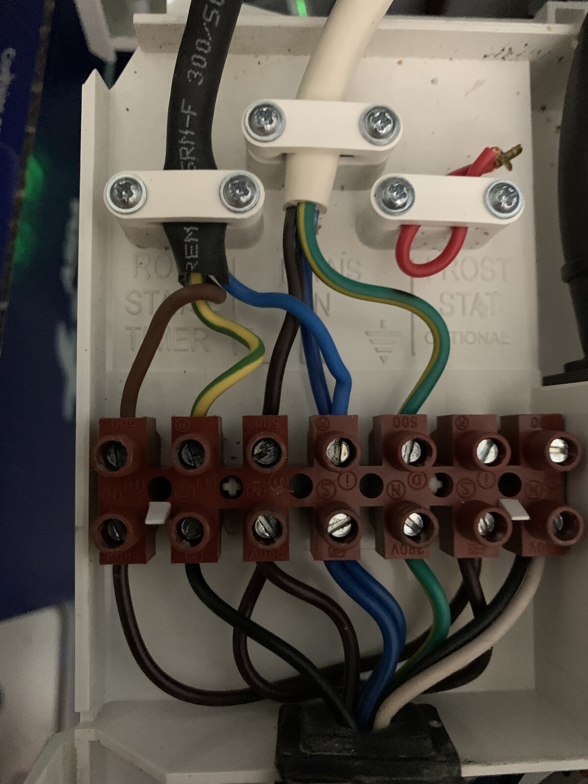

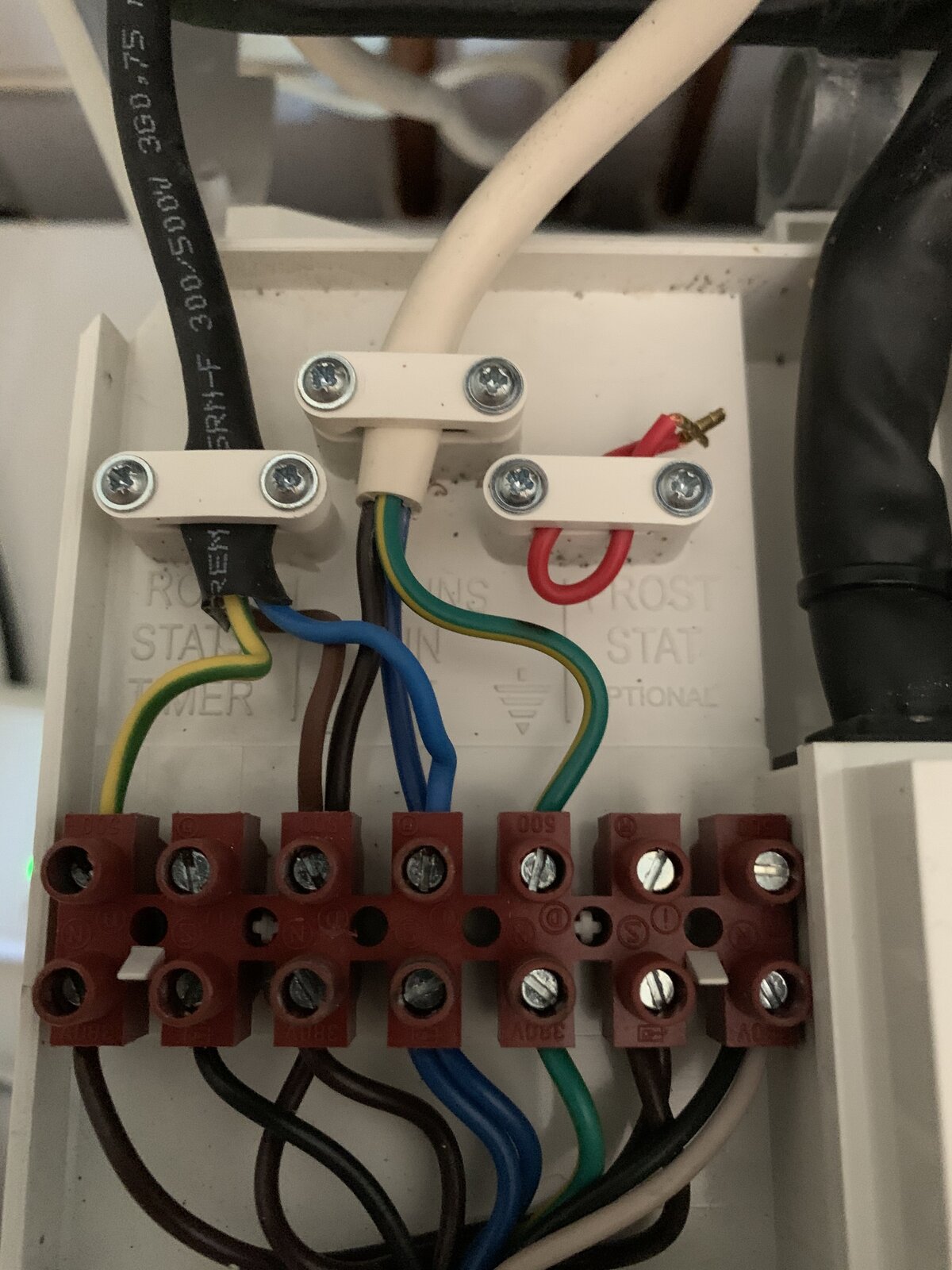

thanks, tried that and now there doesn’t seem to be any power going to the hive unit?

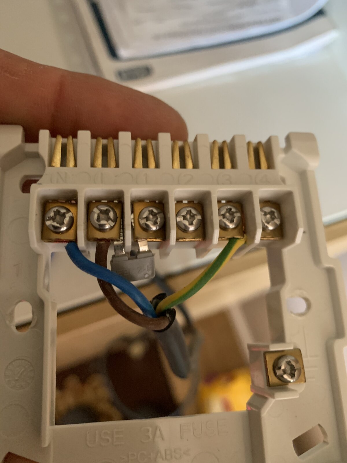

The brown and green/yellow are the switching wires and should be connected to common and 3 on the Hive. You have a neutral/blue but will need another permanent live taken from the same circuit used for the heating system. You seem to be one wire short.

I understand your point, but single channel Hive only needs three wires and an earth.

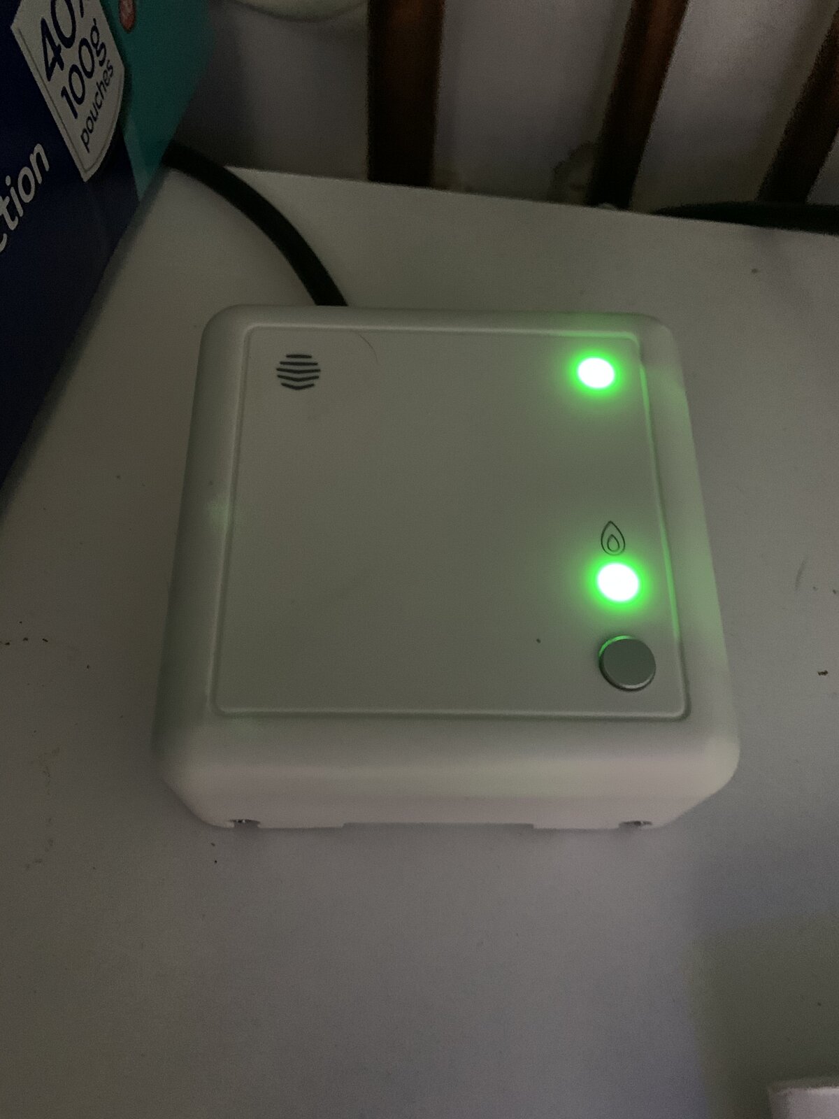

suffice to say I’ve sussed it!

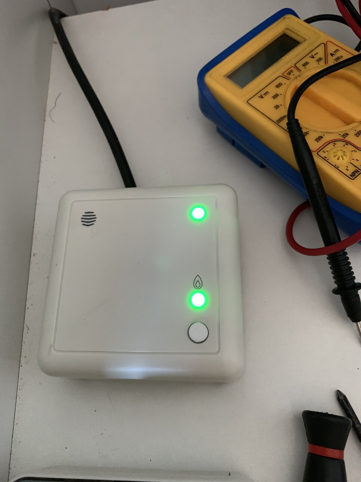

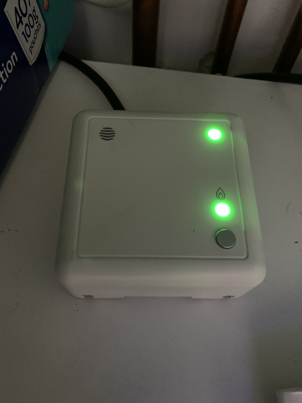

It seems that the wires needed to be transposed as photos attached. System now cycles correctly when the Hive Thermostat or app creates a temperature demand. Mental note for anyone else doing this - consider the external temperature sensor (if fitted) as you’ll be convinced it’s not working correctly - in fact (especially on a hot day - like today) it does it’s job and reduces the temperature to heat the rads (efficiency and all that guff). So in my penultimate test I disconnected it briefly and hey presto the boiler stayed on heating the rads. In summary, to solve this I followed the cables (boiler end) at the brown connection block and worked out that terminal 1 (from left to right) is actually a looped live feeding the timer unit (if installed). So in essence terminal 2 becomes the switch.
