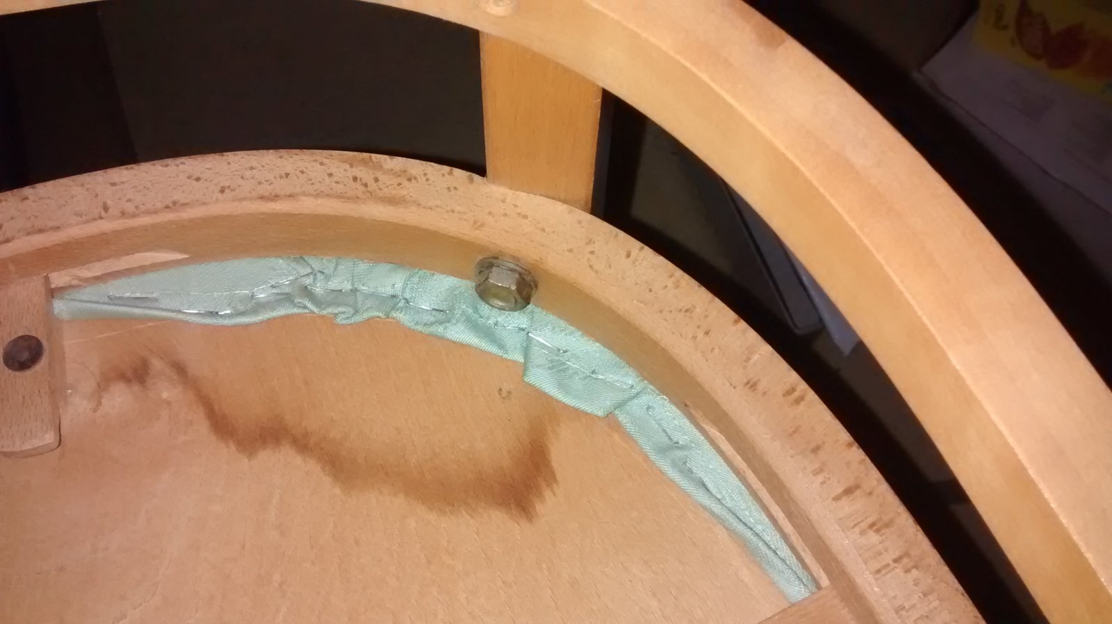

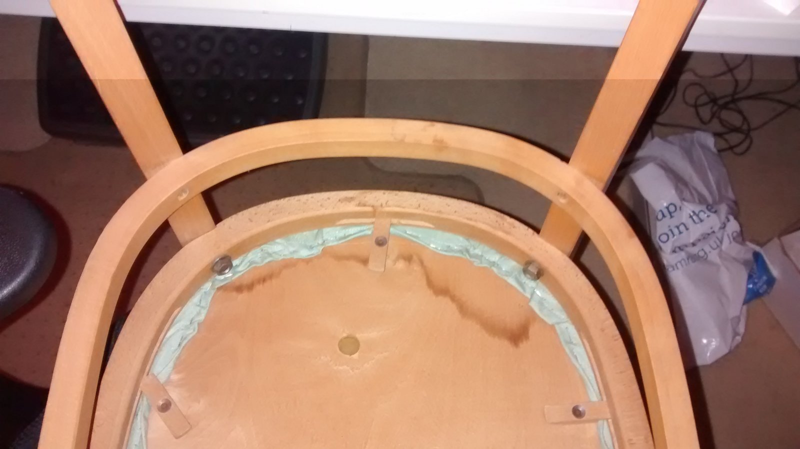

I am trying to repair one of a pair of chairs, where one of the screws has come out and been lost.
The underside of the chair that is okay looks like this

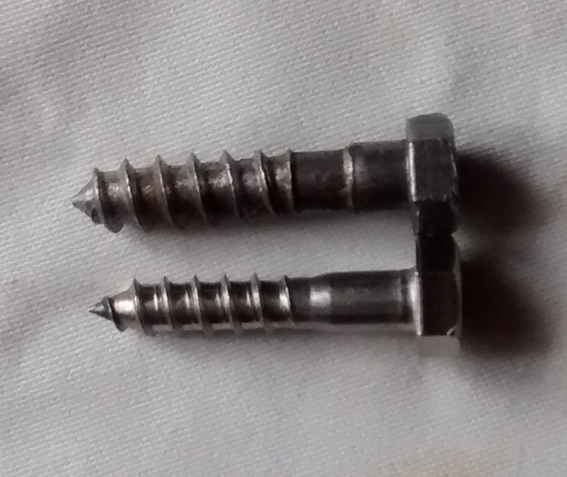

and the screw looks like this
I thought it looked a bit like a roofing screw, close enough that I could use them. However the thickest roofing screw I can find is 6.3 mm (needing an 8mm driver) and the one I need is c. 10mm in diameter (needing a 13mm driver).
Any idea what this is and where I can get hold of some of them?

coach screw
(not a coach bolt)
aka carriage screw
Some timber yards have accessory shops attached to the yard or you could try a builders merchant. Alternatively try Amazon/Ebay.

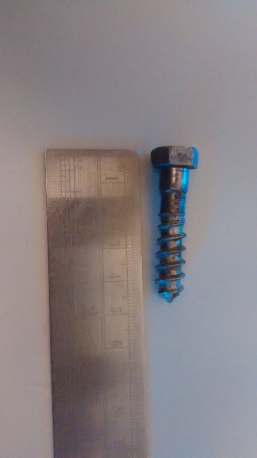

I have found someone via Amazon (who I have used before as it happens) who sells these in small quantities. However I am a bit confused as to the size I need. The M10 says 'Spanner/ Wrench Size- 17mm' and the M8 says 'Spanner/ Wrench Size- 13mm'.
The ones I have need a 13mm socket, however the bolt diameter to the top of the threads (which is what I think is where it is measured) is 9mm. For completeness, the diameter on the bolt body is 7.8mm. Any idea whether this is M8 or M10?
As it is a screw going into wood it does not have to be spot on, but I want it close.
BTW, I wondered if this might be an imperial screw (the chairs are old) but the head is clearly 13mm and is just too big for a 1/2" (12.7mm) spanner.
M8 is a thread size of a bolt that fits a nut and goes through an 8mm hole.
The head size of a metric nut or bolt is always bigger than the nominal size of the bolt, and it doesn't matter to your job what size or shape the spanner is.
I don't know how you define metric wood screw sizes. I think it's the size of the unthreaded shank.
The holes may have worn loose so a slightly bigger screw may fit tighter.
Its an M8, Stephen....its the same sizing that's applied to metric screws and studs.
Your tapping size, if you ever use these screws from scratch, is equal to the diameter of the root of the thread - somewhere in the region of 6.5mm.

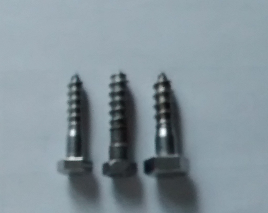

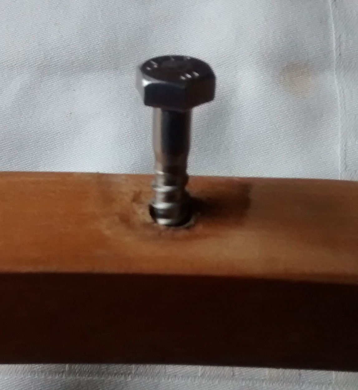

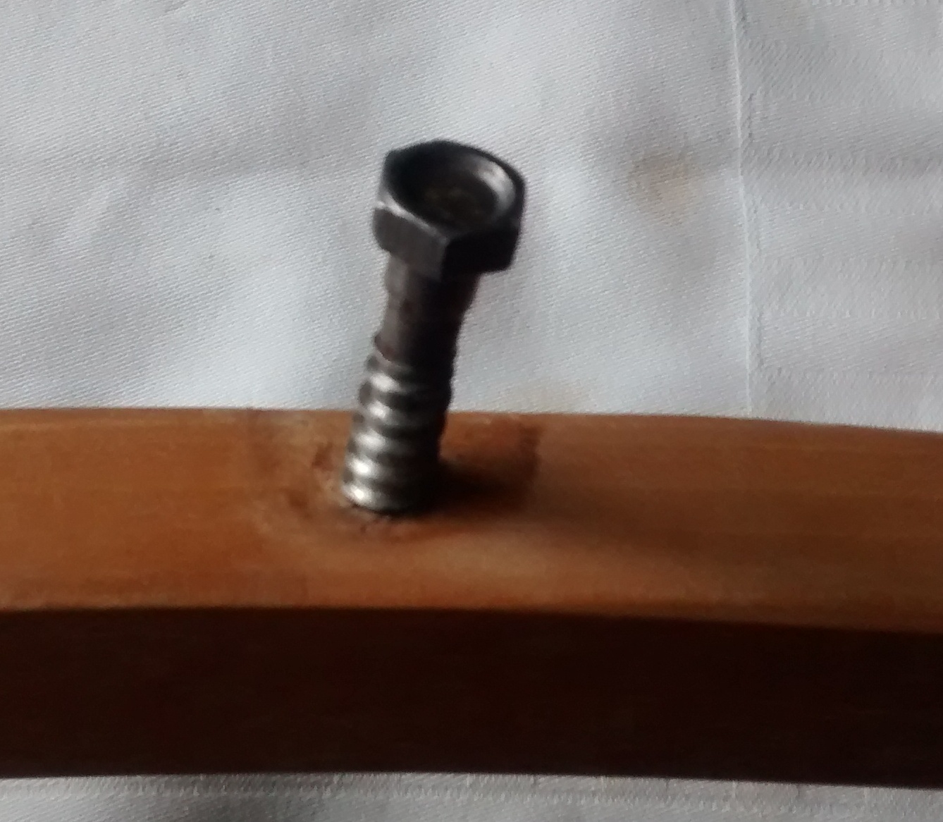

Thanks for all the help. Well, despite the confident replies (from usually reliable people) that this was an M8, it wasn't!
IMG_20191011_144503066.jpg IMG_20191011_144558933.jpg IMG_20191011_144620798.jpg
M8 below the original; Original in existing hole; M8 much deeper in existing hole.

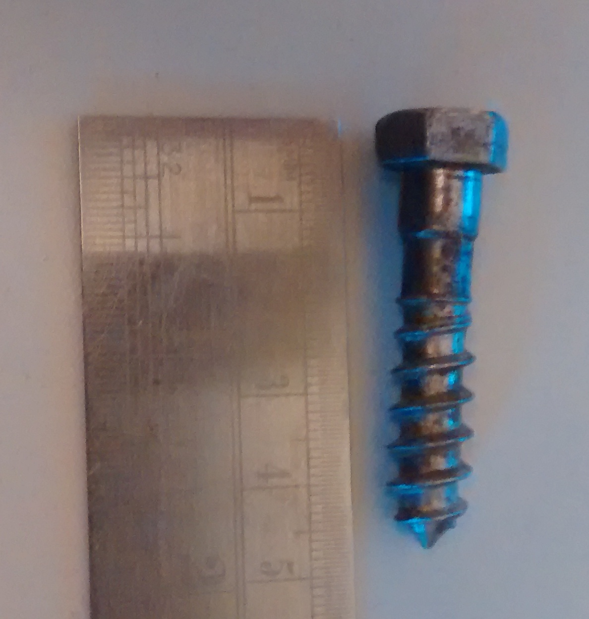

So I bought some M10 screws (mail order) but other things got in the way and I only fixed it the other day. To reinforce the holes I used some two part wood filler and used a scrap of wood to make a conical hole in that, so the threads had something the right shape to bite into.
M8, original, M10. Sorry this is fuzzy, it looked okay on my phone but on a large screen it clearly isn't.
The head is the same size as the M8, but the body seems just a bit smaller than the M10.
They look quite modern, I wonder if they were made for the American or Liberian market?
Or, perhaps, somewhere like India that might have some old stock?
I wonder if the head size is 13.34mm which is 1/4" Whitworth spanner (and, amusingly, nowhere near 1/4", but a bit bigger than 1/2")
9mm is almost 3/8"
Maybe the coach screw was 11/32" imperial, Stephen......who knows? Odd ball sizes do show up from time to time.
