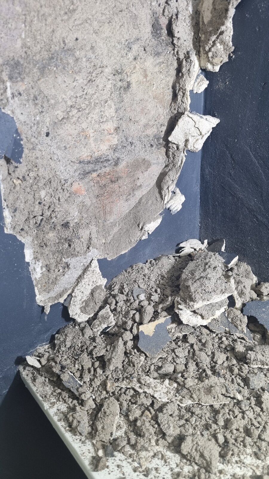

I'm removing some plaster on our rear external wall and want to know what type of Plaster it is. It seems to have a thin rigid white surface then powdery grey texture behind. Mainly keen to know it's not hazardous!
Thanks :)
It won't be asbestos if that's what you mean. Just take normal precautions for working with construction dust.
