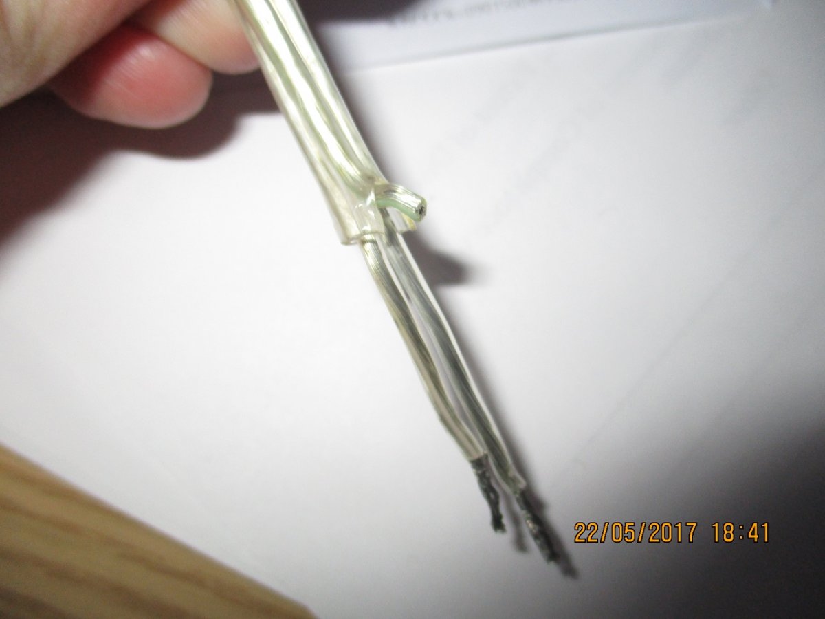

My wife in her wisdom recently bought a 2nd hand chandelier off gumtree. When I had a look at it, it looks like the bracket is missing. There are three wires, one of which has been cut short for some reason (see photo). Two of the wires look to have a white line running along them and one (the cut short one) has a green line - will this be the neutral? Thanks for any advice!

You would expect the green marked cable to be the earth (likely been cut, because the previous owner/installer has no idea of what is and is not dangerous) . Then the two whites to be one live and one neutral. To establish which is which, you would need to test for continuity. Do you have a continuity test meter? And what type of lampholders are on the fitting?

There is also an earth wire up inside of the fitting, which has also been cut, so I don't think the wire with the green stripe is earth. I do have a continuity meter but was hoping there might have been a wiring colour convention I wasn't aware of that would make it easier! The lampholders are the small screw-in type, 40W max.

Regarding the wires the live should connect to the centre of the holder, the neutral to the outside screw, and the earth to any external metalwork.
Some of these lamps have one pair of cores for each physical lamp holder, so you might find some strange seeming connections, but with a meter it should be simple to work out.
If it was made for the US market, it could be: black (line), white (neutral), green (ground).
One of the conductors looks darker than the other.
No one said it was earth merely pointing out what the green line was likely meant to signify.
I think everyone thought that being cut short meant it was not used - therefore it is not anything.
Even if there were a convention - well there is, but it is irrelevant because you wouldn't know if it had been followed.
