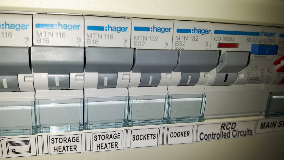

I am trying to determine if that switch is on PEAK or OFF PEAK electricity.
Take pictures if your consumer unit(s) (fuse box).
There may be a circuit labelled bathroom or something.
A suitable heater just the other side of that switch will cause the least damage.

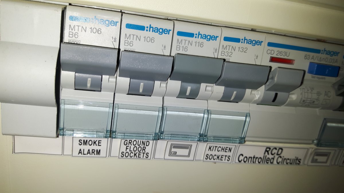

Here are photos of my fuse box. Does the choice between peak and off peak make a difference when choosing a heater?
The labelling on that consumer unit is mostly wrong.
6A circuit for 'downstairs sockets' - not likely.
'Storage heaters' on the same supply as a cooker and sockets - no.
Nothing for any water heating at all.
:) What can I say. This is a small one bed flat all on the same floor.
Yea I suspect 'Ground Floor Sockets' should be 'Ground Floor Lighting' and if it's a one storey flat, then just 'Lighting'.
They've used the storage heater pictures, or panel heaters etc pictures, as well as the text storage heaters. That would imply there are 4 storage heaters? Or perhaps 3 and then this unknown switch outside the bathroom? Does that sound correct?

There are three electric wall heaters (not storage I think), one in the bedroom and two in the living area - plus that one switch - no heating in kitchen or bathroom.
As I suspected then, each of those heaters is (likely) on their own circuit, and then you (probably) have a dedicated circuit for the bathroom heating - even though none has been installed.
If the labels are anything to go by there are four heater circuits - you have three heaters, and the fourth may well be that switch outside the bathroom.
Given the way your consumer unit has been labelled it does need checking first.
Before installing the heated towel rail it would make good sense to check there is power is at the switch - but it does all look rather hopeful.
