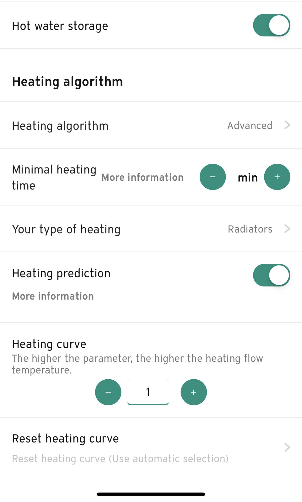

The Flow temp is automatic based on a vsmart. As weather gets colder I just increase heating curve which increases target flow temp. I’ll keep a eye on radiators in the loft Incase I need a bit more. But I suspect it should be ok as it’s a 27kw boiler with 13 rads.
The heating curve is fine tuned by VSmart, you can set an initial value, but then VSmart will then modify any value you set, as it gains experience of the needs for heat of your home.
Vsmart can set tempreture of cylinder and it always hits that tempreture. Always works well. There is a diverter valve built in boiler. Never seems to be a issue
There is a automatic selection. That chooses 2.5. But I find 1 works well in September. But that 1 I set never changes unless i change it myself
