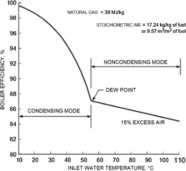

Its the boiler return temperature that determines the boiler efficiency, most boilers just control the flow temperature and the return temperature will obviously be lower than this, by 10C to 20C, so if your flow temp is actually 55C then the boiler will be pretty efficient as the return temp will be 45C to 35C. Outside temperature compensation will reduce the flow temperature automatically leading to greater efficiencies. You can also run a Vaillant in return temperature control but I see very little examples of this on any heating sites.

The TRVs must be open fully for that very low dT. If only a few rads on, in say a (zoned) circuit and your circ pump is set to a very high head then you will get a low dT, rads are supposed to be balanced by throttling the lock shield valves although mine are not and when the (10) TRVs start throttling in, the the return can be as low as 40/45C with a fixed flow temperature of 70C, dT of 30ish.
The first and last sentences are very interesting. The first because although you're obviously right, I personally look at the flow temperature being important as that shows how much of the exchanger is likely to be below the products of combustions dew point (ie a return at 55 may be 60 within a very short distance of it's entry. A flow at 55 means most of the exchanger may be below a dew point. The lower the flow temp the greater the area of the exchanger for condensing. Just looking at things in reverse.

ΔT (temperature difference across flow and return) is too close. Ideal is 20°C on a condensing boiler.
Too much boiler power, the property can’t absorb it so flow temperature isn’t reduced sufficiently as the water is distributed around the system. Boiler cycles, ΔT closes.
Pump setting too high, even if output matches property load, the water flow is too fast, same result, a close ΔT.
The flow can be restricted to a limited extent at the radiator valves but there is a limit and the system changes all the time as weather and heat loss changes.
