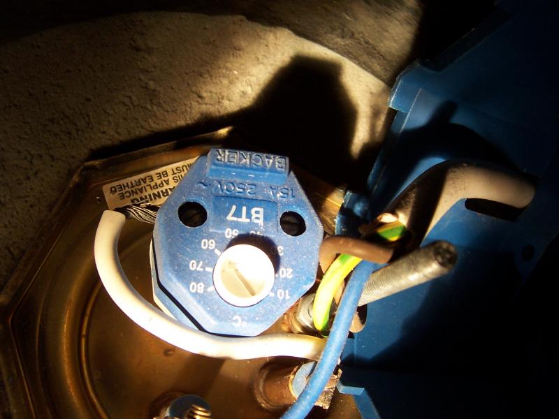

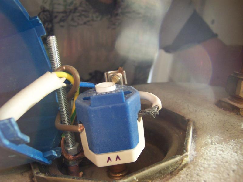

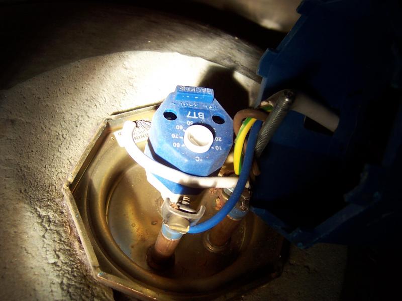

Here are photos of the unit:
I can't find a reset switch anywhere.
I used an ac voltmeter and can confirm that between the live (brown) and neutral (blue) I was getting 230V ac. The live wire goes into the blue thermostat device and has a white wire output, which I presume is the supplier of the current to the element. When the probes of the voltmeter were across the metal contacts of the white wire and the neutral it read 0V regardless of what value the thermostat was at via rotating with screwdriver.
So you have now proved the stats no good. (thats only a 7" stat should be 18")
Check the element for resistance. with mains power off.
Got it at 20ohms, had the pins of the ohmeter across the wrong bit of the element. I tried connecting the live wire directly to the element (bypassing thermostat) and the element heated up the water no probs.
So just replaced thermostat with one from B&Q and voila - it works perfectly !!!
