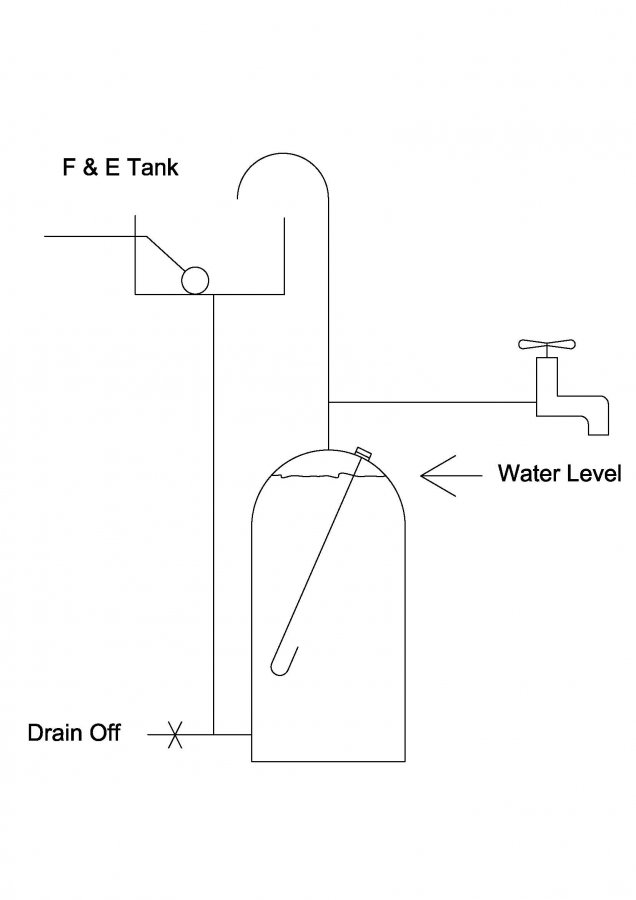

You don't have to completely drain the cylinder, as long as the water level is below the immersion heater boss, that will be fine. In fact if you leave most of the water in, the weight of it gives the cylinder some stability and can prevent damage to it and the connected pipes, particularly if the immersion is a tough one to loosen.
After you have turned off the cold supply to the feed and expansion tank, open the hot taps until water stops flowing out of them, then open the drain off and remove a few more gallons.
If it's side entry then it probably goes in right near the bottom! So it does need draining. It's also a steel tank, much stronger in the first place.
I don't think the weight of 150 mm of water is going to be very significant compared with the weight of that galvanised tank!
Also unless very badly rusted, its not so likely to be damaged while removing the element. Can still be very difficult though!

As the heating element is from the side, I think I will purchase an 11" titanium element (good and durable for hard water areas?), a box spanner and some PTFE tape.
Do I also need to buy some 'jointing compound' or alternative to paste between the ring seal on the element unit?
When I shut the water supply off to the heater, and turning on all the hot water taps, how much water will be left in the tank before the rest needs to be drained from the drain cock? Will I be able to improvise and use an old washing machine hose on the drain cock and drain into a bucket?
