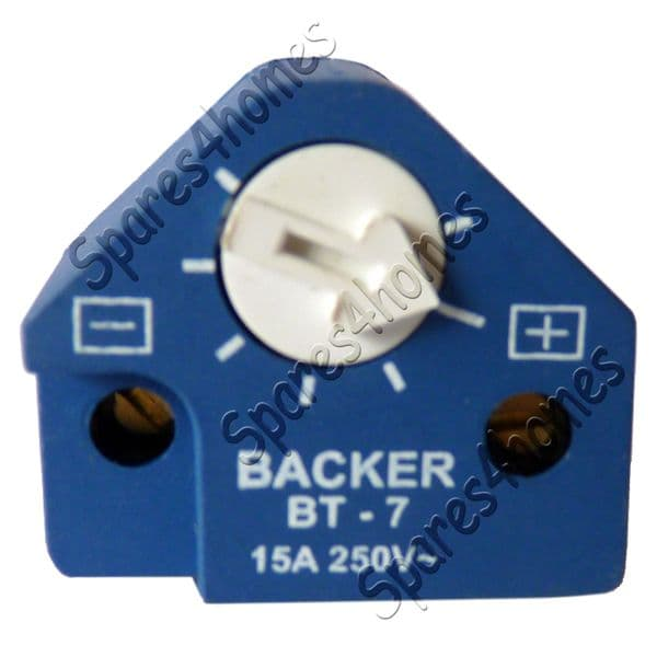

This thread brought up the question.
This
is given as an example of not having a thermal cut out, and it can be built into the thermostat
or independent and it is clear enough when either is used if in the case of the thermostat there is a reset button, but in this case upload_2021-10-21_10-52-33.png it is not reset-able so other than the part number nothing to show if it has a thermal cut out or not, there is an issue asking anyone to remove the cover on the immersion heater to check however the chances are if is does not have a thermal cut out there will be no part number which will produce results with internet hunt.
Since you can have an independent cut out, which is better when using solid fuel as common to need to reset, so want it so it can be reset without removing cover, I assume you can still get thermostats without it built in?
So how can the home owner safely find out if his system is safe? Clearly if in the loft the tank is steel or thermal setting plastic he is OK, it is only the thermal plastic tanks which are a problem, can't understand why still permitted?
But how does the home owner find if he is safe, I know I am as the cut out tripped and I had to reset, but if no reset button found, how do you know? Is there a list of part number or something?

It does not matter what heat source heats the water, if it exceeds the limit the cut out will open, even if no electrical fault, so only if only heating is electric should a non reset-able cut out be used.
However the question is not if reset-able or non-reset-able should be used, it is how one can identify is there is a cut out if no reset button can be seen?
