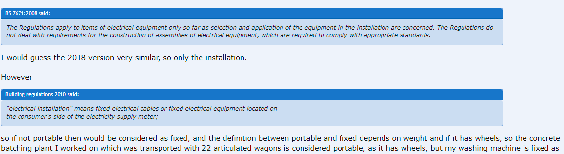

BS 7671:2008 said:
The Regulations apply to items of electrical equipment only so far as selection and application of the equipment in the installation are concerned. The Regulations do not deal with requirements for the construction of assemblies of electrical equipment, which are required to comply with appropriate standards.
I would guess the 2018 version very similar, so only the installation.
However
Building regulations 2010 said:
“electrical installation” means fixed electrical cables or fixed electrical equipment located on
the consumer’s side of the electricity supply meter;
so if not portable then would be considered as fixed, and the definition between portable and fixed depends on weight and if it has wheels, so the concrete batching plant I worked on which was transported with 22 articulated wagons is considered portable, as it has wheels, but my washing machine is fixed as over weight and no wheels. There was a time with old Bendix washing machines when they were bolted to the floor.

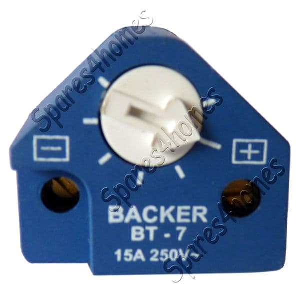

How do you check that an immersion heater has a thermal cutoff? I definitely have a plastic tank above the cupboard where the cylinder is.
Good point, I know I have since it has tripped, and if there is a re-set button clearly it has a thermal cut out.
But where the only form of heating domestic water often the thermostat is not re-set-able but if you can see the reset as with this
can just see name reset to right of temperature selection than clearly OK, other wise not so sure, this
is the example shown without a reset, but since the cover normally needs removing to access the reset I really don't know how that tells you, I do remember my dad's was duel element and it did have a reset. And I seem to remember it did not require removal of cover to assess it.
A thermal setting plastic tank is no problem it is only the thermoplastic tanks, personally I think it should have been the tank banned after babies death the tanks used with solid fuel water heating often a back boiler are either steel or thermal setting plastic which is hard even when heated to boiling point.
The early immersion heaters often had an independent reset

this thermostat upload_2021-10-21_10-37-1.png does not have a reset, however it does have a thermal cut-out so whole thing needs replacing should it go wrong, the idea is if it has failed once, and over heated, it can fail again, so if it over heats whole thing needs replacing, however if over heating caused by other than the immersion heater then you do want to reset, but only way I can see to know if there is a thermal cut out is to google the part number.
Since there could be danger involved removing the cover on a live immersion heater, I hesitate on saying remove and look, I know when my dad's side boiler on Aga caused water to boil the noise was enough to alert anyone that something was wrong. Maybe the subject should be raised in a thread in plumbers section?
What's the opinion about mine (above)? Sorry for the enormous image!
Reading adverts it does seem the BT18 is a Backer 18 inches thermostat with non reset-able cutout, so OK but your point is valid there is no non destructive test to show OK.
I assume that the black button will pop up in the event of a fault. Can you tell me what the white wire is for? Thanks.
